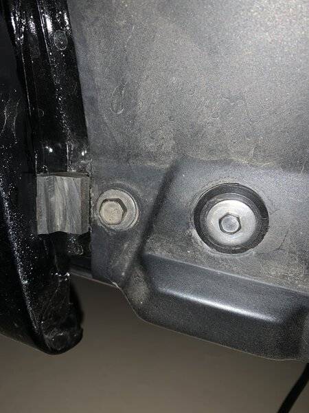

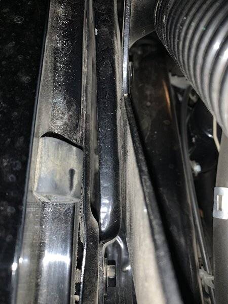

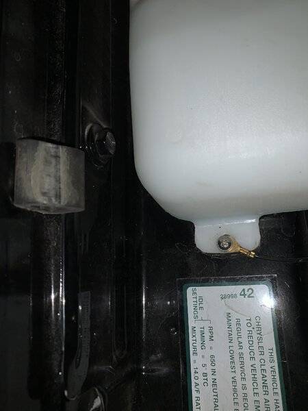

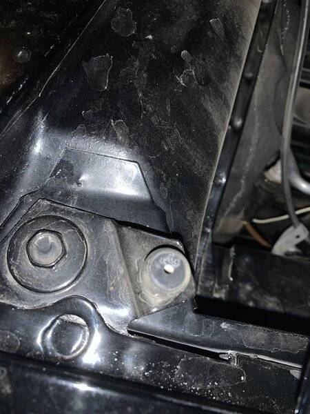

        You need some hood bumpers & your distributor position is out of whack. There's a few other details that need to be corrected, but overall, not bad.
        • Like Like x 1

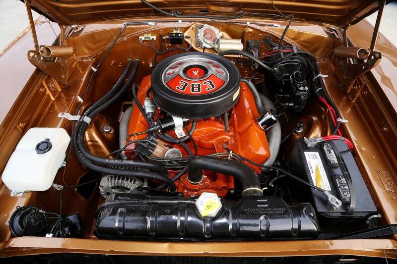

          All the pie pans have been discontinued so you might get lucky and find one. 383 four barrel in red or orange might be available. I’d call Mancini or Roseville. Start looking now and pay what you have to pay because they are no more.
          • Agree Agree x 1

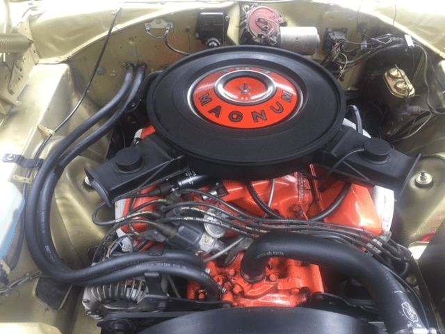

            Here is my '70 Charger 500 with the correct 383 Magnum pie pan.
            • Like Like x 1
            • Agree Agree x 1

              You’ll have to excuse the dirt and grime on mine. It needs a good cleaning. There are 4 rubber pieces along each side of the hood.
              2740FA5C-62CA-4E83-A5A3-125F6C8E3028.jpeg 5715EFA6-A241-4C2D-8D40-3D8994B8E86A.jpeg FFECAA79-5AA1-4AD1-A0E2-36708F0AA00A.jpeg A0CA5C95-BAE1-4D1E-8653-0ED41848276A.jpeg

              Just a fyi. See post #29 for my '70 383 Magnum, 4 speed Charger 500. Also, my engine from the factory:
              • Is orange
              • Has a windage tray
              • Has the purple shaft

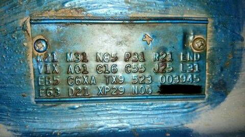

              The original post was for a 1969 383 4bbl in a Charger, that had pie tin that read 383 COMANDO.
              In 68/69 Chargers with 383 4bbl engines (H code 330HP E63 fender tags)the tin should be 383 4 BBL, to be correct.
              But MAGNUM sounds way COOLER, and my 1969 Charger 4bbl 383 has the 383 Magnum tin, on it, because I like it, but I guess in the big dollar, take no prisoners', high stakes world of 100% correct Mopar cars, it is not correct.(I do run correct hose clamps though, LOL)
              My #'s 383 4bbl was and is painted turquoise, and at first I thought it was maybe an A/C car thing, but upon further digging, I have been educated that in 1968, and 1969, the 383 "Magnum" engine (335HP) was a Super Bee only engine, just as a "383 Roadrunner engine" was unique to just Roadrunners.
              The reason being was for MARKETING! It made the 383 MAGNUM/ROADRUNNER(335HP) engines found in those cars "hotter" then the regular old 383 4bbl (330HP) in your dads car.
              So the 4bbl "H" code E63 383 used in the Dodge Charger (in 68, and 69) was the 330HP version.
              It has the same 4bbl intake manifold, same 4bbl exhaust manifolds, but has different camshaft and no windage tray.(vs the 335HP version)
              I think it would be cool to find out if in the few 68/69 Chargers with 4 speeds that had the 383's painted orange if, internally, they were 330HP or 335HP versions?
              And if they did leave the factory, in 1968/69, with orange 335 HP engines, is it correct to call them MAGNUMS?
