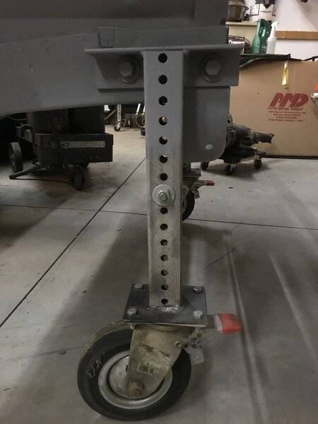

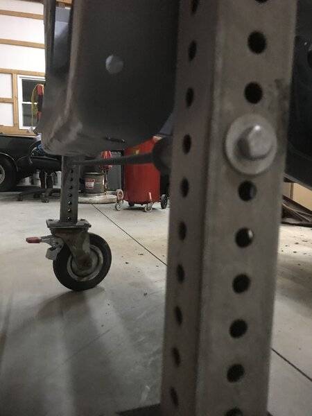

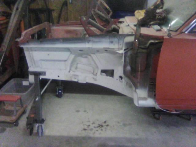

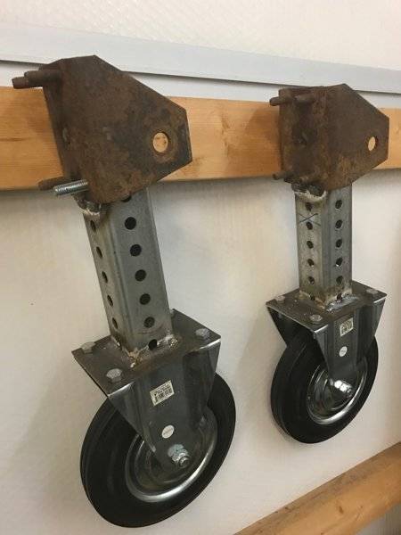

what size tubing did you use ? 1.50" or 2.00"..THANX!
My friends at VDOT hooked a brother up. Its old street sign posts that were bent up. I cut the straight pieces off and made these. I think 2". It fits in a Reese hitch.what size tubing did you use ? 1.50" or 2.00"..THANX!

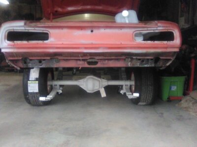

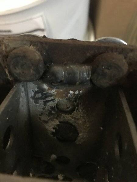

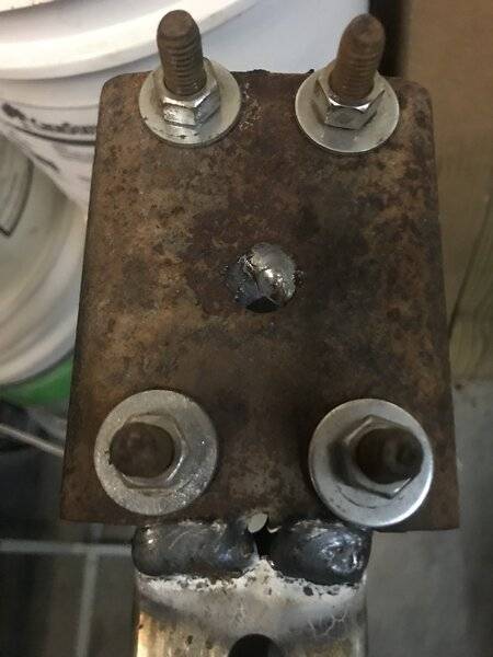

Sorry to be nit picky but are u using a strut to attach the front to together for strength? I can't tell and I can't enlarge the pic to see...also on the back ones did you grind the heads off the studs n order to get tubing flush ?...THANX!My friends at VDOT hooked a brother up. Its old street sign posts that were bent up. I cut the straight pieces off and made these. I think 2". It fits in a Reese hitch.
