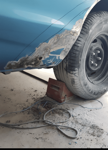

Hey fellas just about to get back started on my project and gonna get cracking with the panel work.
Looking for advice on what sort of tools I would need plus what way to go about do a job like this. It's on a 69 Coronet. In front of the rear left wheel one of the POs has done some dodgy work and I wanna fix it. I've picked up some tools, basic panel hammer and dollies, english wheel and a bead roller. Haven't really used the wheel yet but looking forward to the day I do.
Am I seeing pin holes on up the wheel arch ?
Rocker area is damp and rusty inside.
Filler is pretty deep, you just popped the top on the old worm can.
Get it up in the air some, cover the glass, pull the wheel and check the inner tub lip.
Keep grinding until you run out of soft spots and filler.
Take more pics then and post them.
Sorry but your not even 1/2 way to seeing what you have to fix yet.

Just looking at the picture that patch area is going to be the tip of the ice berg.
It looks like the original qt. With a patch.
Question is how far do you wish to go. If you keep grinding and hunting you most likely will uncover things you do not want to see.
Over the wheel, behind the wheel ect.
Right now your at patch panel and few hole on the lip.
These old mopars , I'm sure you can uncover enough to justify a qt panel or perhaps the bottom section of one.
It's up to you from here on you can fix that and blend in the color or dive down the rabbit hole.

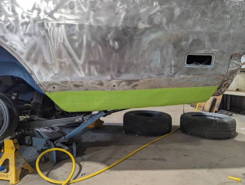

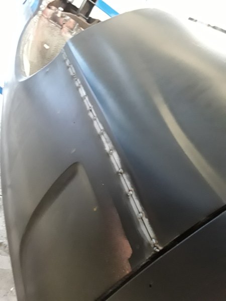

So I've stripped it back and have found some old repairs. Made a tape template and bent up a new piece to go in. Cut that piece out and found that some grub had just stuck a piece of metal over the top of the old rusted bit. Man was that an absolute pain to remove. Found more rust behind it so I have to make another panel up for it. Don't know what panel that is, the one with the beads in it, lower portion of the boot/trunk.

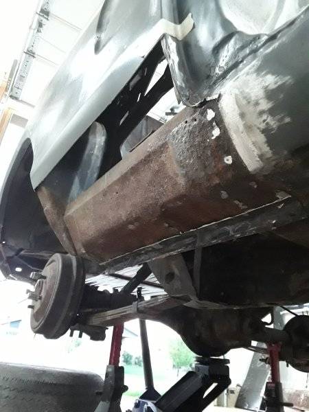

Once you cut out the lower quarter in front of the wheel you will probably find that the outer rocker is rusted out and will need repaired. The quickest easiest way to fix all of this is with new AMD quarters, either patch the areas or do the whole quarter. Patching the quarters just above the body line works well. Also, what are you stripping the car to bare metal with? You may want to use something that is gentler on the sheet metal. These cars don't have any metal left on them to give, it's best not to make the panels any thinner.

For sure, I bet it would be worth the wait and cost if you can the AMD panels. Yeah ditch the strip discs, I use 80 grit and 120 grit discs and I keep them moving as to not chew on the metal too much on the edges, etc. These cars have thin and wobbly panels and it can be difficult to get them nice and tight again after welding on them. (I can speak for a 70 Coronet and Charger is all)
