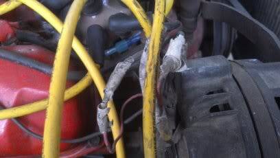

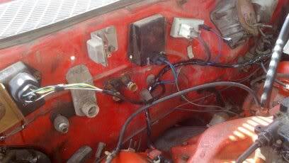

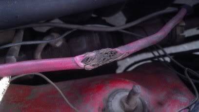

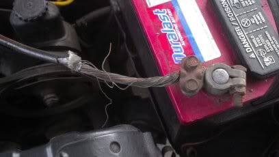

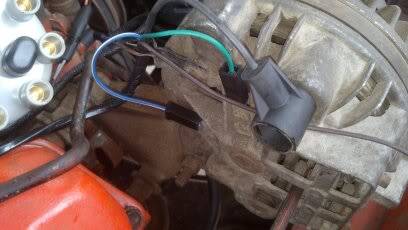

Before :
Basically all the wiring looked like this:
After:
