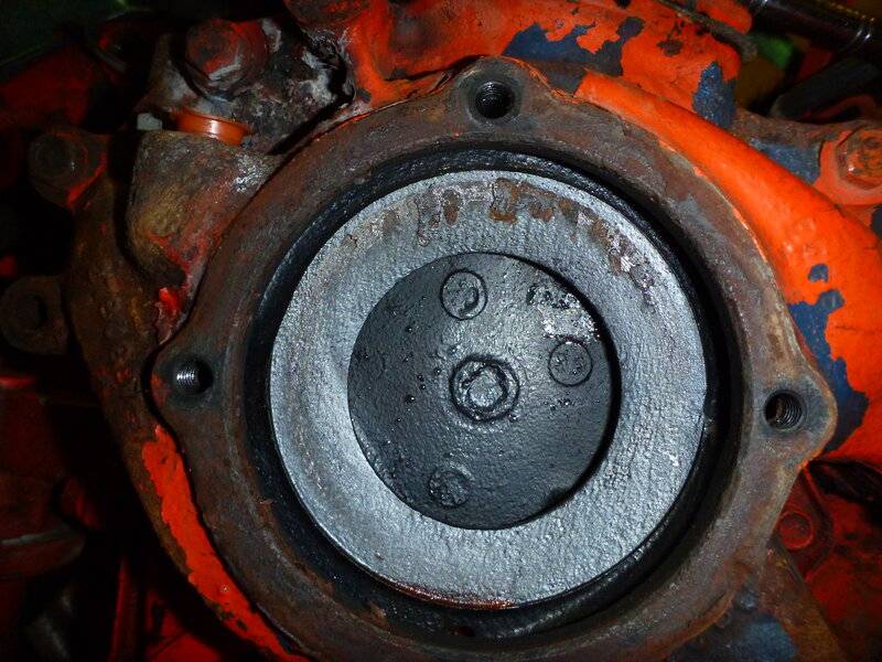

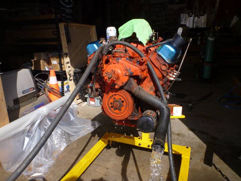

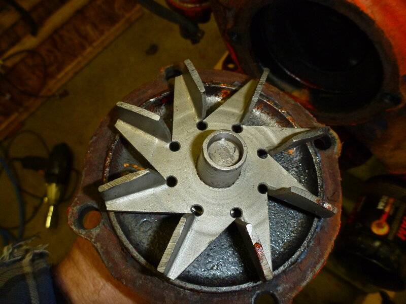

I flushed mine in 2016. First time since 1988 !!!! VERY little rust even on the FULL flush. Still using the SAME water pump !!! Radiator I had in the car still in nice condition as well .
