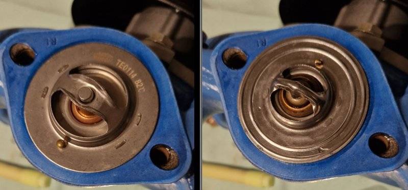

Over winter I rebuilt cooling system on my 383. I bought new motorad 206-180 thermostat but to be honest it looks like chinese rubish of the worst caliber and I already had 160F version in the car. Alternative would be Mr. Gasket High-Perf Thermostats 4367 but it has terrible reviews. Old US or German made Stant or Motorad thermostats are mostly gone or cost crazy money. After some EXTENSIVE searching i found Toyta 90916-03100 thermostat. It is 180F stat used in current Toyta and Lexus engines. As you can see from the pictures the thermostat has additional post with plate on the bottom that you don't want there on Mopar. Simply cut it of the post after drilling out or chiseling off the bottom plate.
You can get the genuine Toyota part for $25 but I think it is overkill. I bought MAGNETI MARELLI TE0114 for $7. Made in Italy, looks excellent. In US you could try AISIN THT013. The limiting factor is overall height in downwards direction and shape of the strap on top that needs to fit into the water neck. Original mopar water neck does not have a lot of room and you would need to file relieve channels into it. Mine was coroded and would not seal around the bolt holes so I bought cheapo Dormann replacement. It has larger cavity for the thermostat and the MAGNETI MARELLI stat fits right in. Also tried FACET (available in US) but it would need a little bit of filing on the water neck to fit.

Comparison between Magneti Marelli stat and Motorad 206-180:
Comparison
Both thermostats right after I fished them from boiling water - MM opened almost 1", Motorad about 1/2":
Modification of MAGNETI MARELLI thermostat:
