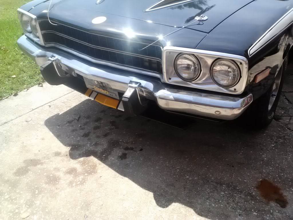

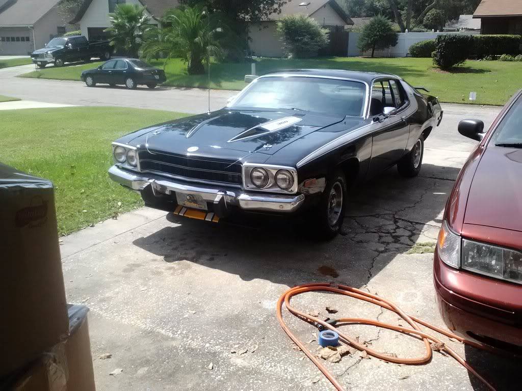

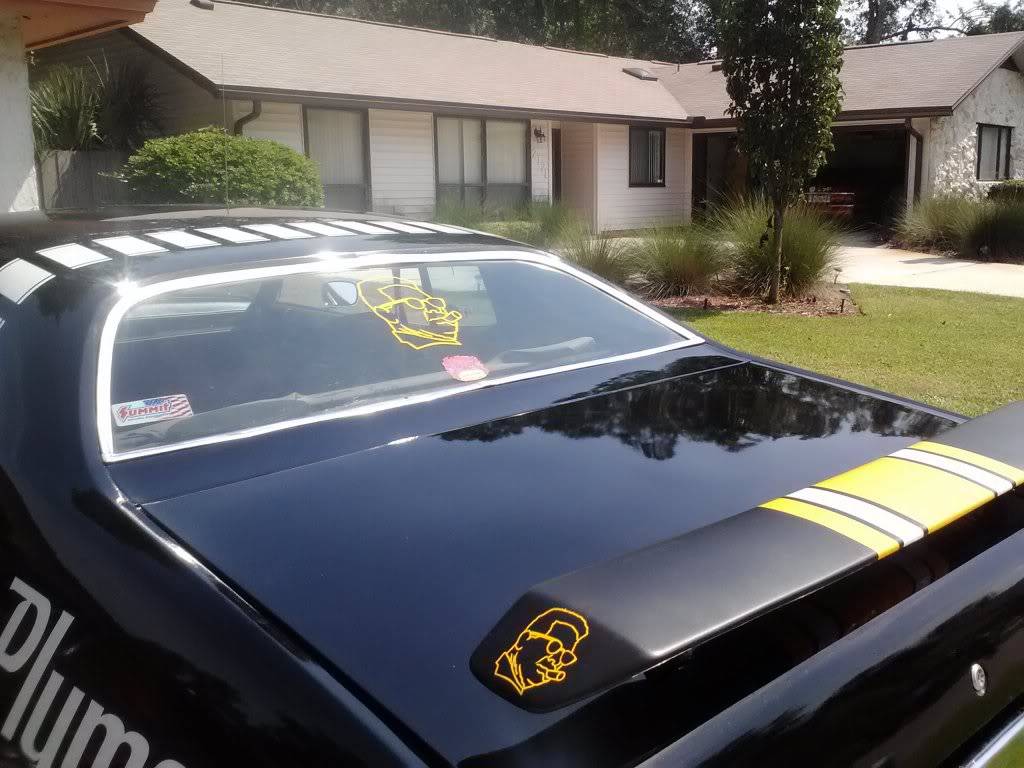

Yes, I have confirmed you can mount a 1969 Camaro spoiler on a 73/74 Roadrunner. :) There are two ways to do it. You can mount it on the flat area behind the center bulge of the lower valance (this is how the "Randy" spoiler gets mounted. The second way is to measure out a section of the center of the spoiler, and cut it out so it matches the shape of the valance bulge (that's the way I did it). I thought this method made the spoiler more pronounced and gave the car a little more chin. :)
The spoiler is a plastic reproduction piece I got off of ebay for $40 (spoiler, shipping, and tax). I was going to get a steel one for about $40 more, but I wanted to do a proof of concept before committing any more money.
Here's how it looks:

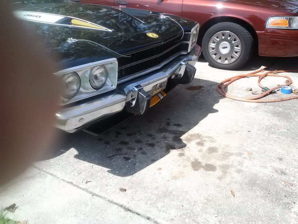

Now the front spoiler matches the rear spoiler:

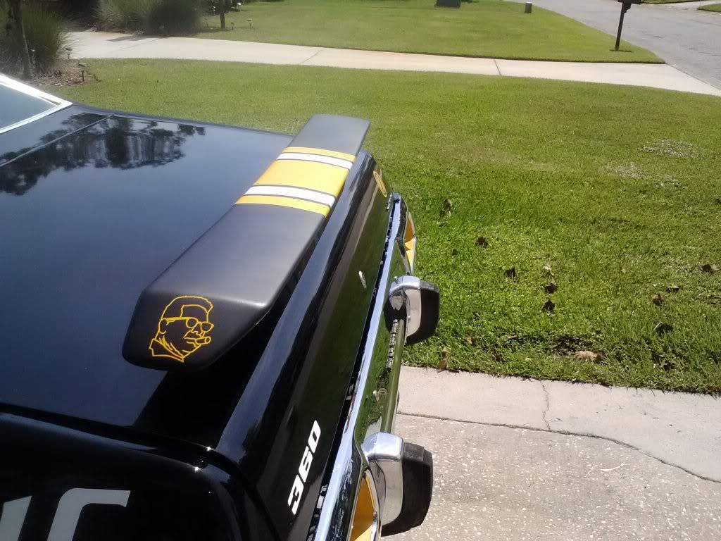

And for all you sharp-eyed fans of the Six-Time World Champion Pittsburgh Steelers, the pattern of the stripes is the sleeve pattern from our Home jerseys, and that is Art Rooney's image on the rear window and wing tips (I finally got my graphics made). :)

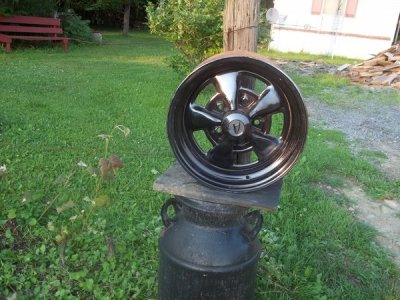

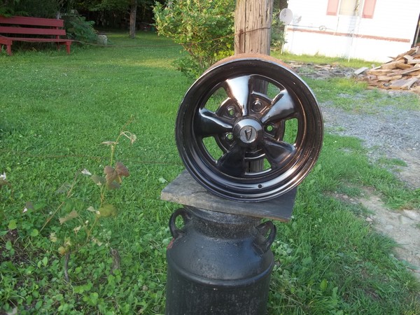

If your going to take a set and paint them black, You may want to try some of Dupli-colors black chrome paint.. It does have the look of the black chrome style rims and you can try different coats on some extra parts you might have around to see what you like best, I painted a old valve cover with it and a rim, valve cover was a lighter coat and i didn't really like it but the old rim, i think turned out good although i didn't paint it as dark as i could, kind of all scratched up and in rough shape but looks cool with the sun hitting it and black at night.. Its a kit for about 20 bucks for the paint and clear to put on it.. This rim is with only two coats of the clear, This is just to show you an option you could use on the bezels to make them look a bit fancy, this rim was in rough shape.. But, it can always be repainted with any black paint if you don't like it..

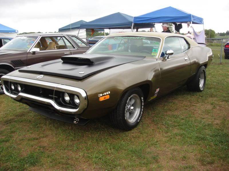

Yes, this is one of the cars I was referring too. I have seen this and spoke to the family a few times. This shot looks like this years Nats in Cbus.
