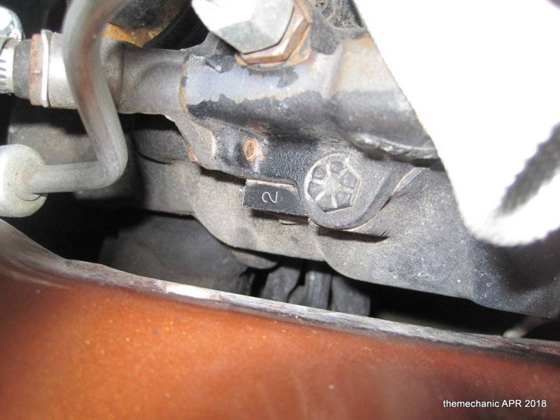

Matt from Firm Feel Suspensions just called me back. He said they stamp a number on the flat space beside the bolt that attaches the valve to the box. The number corresponds to the Stage 1, 2 or 3 upgrade installed.
So, I'm doing the 'happy dance' because mine is stamped with a "2". Yay!
