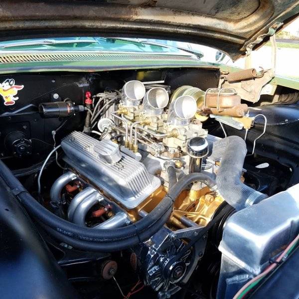

Hopefully you're good at tuning a carb! Now you're going to double your fun!
My last setup was a Chevy Tri-Power and tuning it wasn’t so bad. Just patient and methodical. Learned a lot, that’s for sure. She ran beautifully! Worst case I’ve got a buddy who runs a carb shop to help me.
