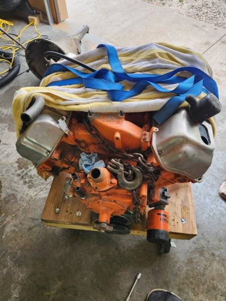

Taking apart for a rebuild. I believe engine is stock with stock pistons but won't know for sure until apart. What bearings do you suggest I go with ? If I need pistons what are your recommendations as I want to be able to run 93 octane max. Also what cam is something that will sound good and give me some more hp. Not sure if I should go hydraulic flat or solid flat..Will be running dual quads up top. I have 3.91 gears and will get a custom converter to match what I got. Thanks guys I'm new to the hemi world

I'm sure it will need bored but try to keep the overbore as small as possible. When you find what it will clean up on then you can look around and see who makes a piston that size. Mopar used to have a good cam selection but now you will probably have to go aftermarket. Take your time on the teardown and keep your eyes open. This will be a fun build since you are using a minimum of aftermarket parts but there will still be trying times. Don't get in a hurry.

first place, it ain't stock with dual plug valve covers ...you may get a few surprises when u get into it too , maybe not , but why would anyone put those on just for looks ??you could get alum. covers w/o the dual plug , altho my experience with them both , they leaked...
