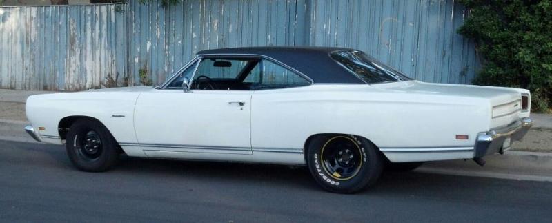

Hi - newb here.
I've been searching through old threads about wheel/tire size (in fact, that's what helped me settle on my rear wheel/tire combo) but can't seem to find consistent info on front wheel / tire fitment.
I am currently running 275/60/15's on the rear, on a 15x8 wheel w/ 4" backspacing. I bought the rears first b/c I got a good deal on the tires. Now I'm ready to buy wheels tires for front. Obviously I want to get the same wheels, but 15x7's are only offered with 3.5" or less backspacing.
Can I run those without any clearance problems? What's the biggest/widest tire I'd be able to fit?
What about if i also get 15x8's for the front? backspacing? tire size?
All suggestions are appreciated...
I'd like to keep a similar stance and that "fill the wheel well" look...
biggest that will fit is a 275 wide tire biggest rim you can fit is 20 x 9
for a 8" rim i would not run less than 4.5 - 5" BS. and no more than 6" if you go less you can use spacers if aaBS is not available.
i know 235/60/15s will fit with 15x7 and 3.5 backspace.the 15x8s start to get a bit close in a few spots.ride hight can effect this alot.my last 68 charger was close to your stance with that set up.
