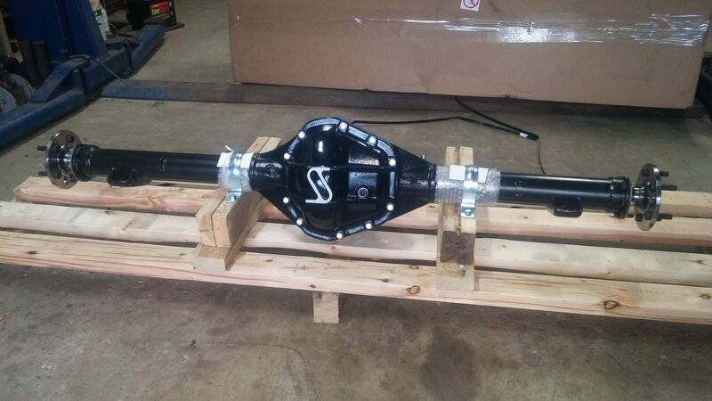

The last Strange I bought through the Dr., I stepped up on most options to strengthen it. With the the time Our Hobby/Passion has left, why skimp...
