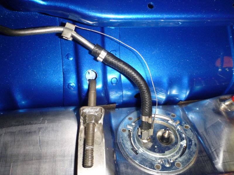

Okay good, now make sure you have a zero ohm ground path from the tanks SENDER HOUSING to the frame. There's a bonding "clip" about 6" long that should go from the sender fuel outlet to the fuel line (to cross the rubber joint). Sender gets it's ground from the fuel line being clamped to the frame. Quick check use that same ground point you just used and jumper to the SENDER face plate... see if your gauge now shows 1/2 tank or what ever fuel you have in it.
