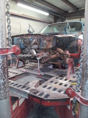

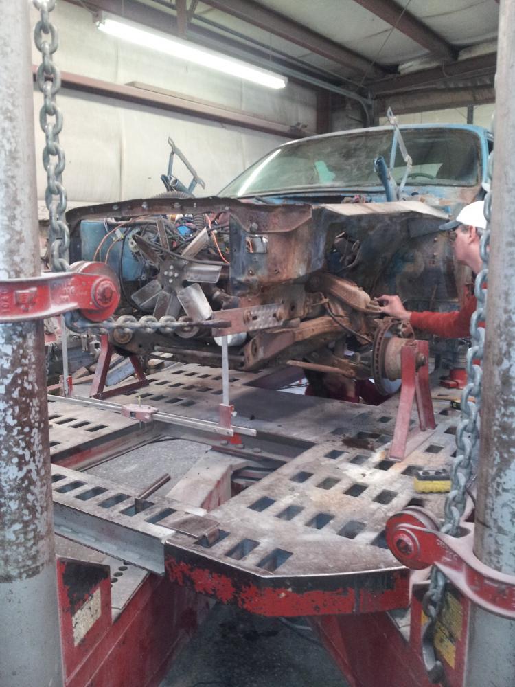

Well after all of the fighting with clutch linkage and problems getting z bar to fit I finally got to bottom of all of this. This car had a buckle in the frame that went unnoticed behind the steering box. Frame was over and in too close to engine causing even more problems than was initially known. When I saw this it made me a little nauseous. Luckily I run an automotive repair shop and we are next door to a body shop with a frame machine. Spent most of the day yesterday with the owner of the body shop pulling the frame back into specs. How thankful I am to have good buddies that will help a fellow out.
And your asking us for help, just kidding glad you are putting it right.
That's great news, vetteman. Must be nice to have the facilities right at hand.
