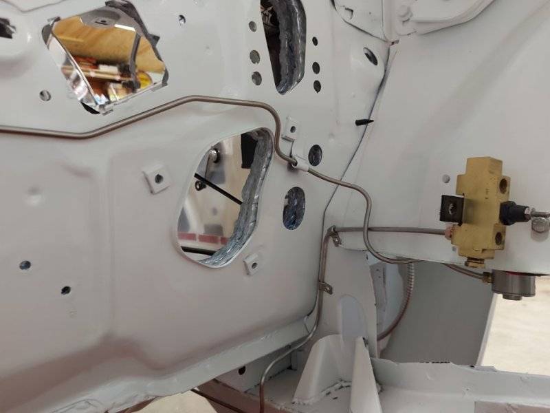

Are you talking about the bracket that holds the end of the z-bar that is welded to the top of the frame rail?
If so, here is a picture of the bracket for a 1971 B-body.
