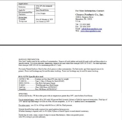

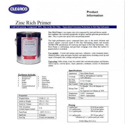

Has anyone used this product or recommend it?
Thanks, Joe
Joe, Looks like this is more of a industrial coating(ships, bridges, etc.)but according to the tech sheet it would work as a weld through primer. Before you apply this the metal has to be clean so in that case I would just go with a good epoxy primer like SPI and eliminate this zinc primer.
Thanks for the reply!
I looked at SPI also, would there be any benefit zinc primer then epoxy?
The leach thru statement was enough, i'm going with SPI epoxy. I want to make sure I prep and protect the metal correctly without problems the first time. Thanks!!
