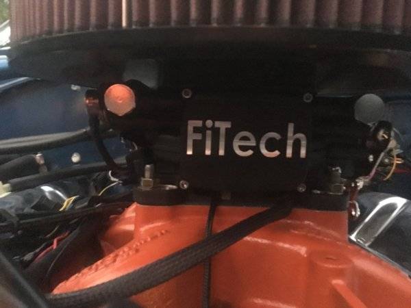

Yeah were right on. with the air cleaner off it got louder and by ear, it was clearly coming from inside the throttle body. I changed the gasket anyway, the one they supplied was like a piece of Masonite.
IAC is supposed to be 3-10 at warm idle, mine was at 147. Plus my throttle linkage was a bit off. Little adjustment and 1/2 turn on the throttle screw and the idle cleared right up and IAC is at 7-10.

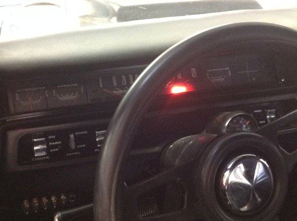

First time in 5 years that fuel gauge read full.

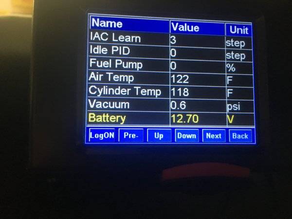

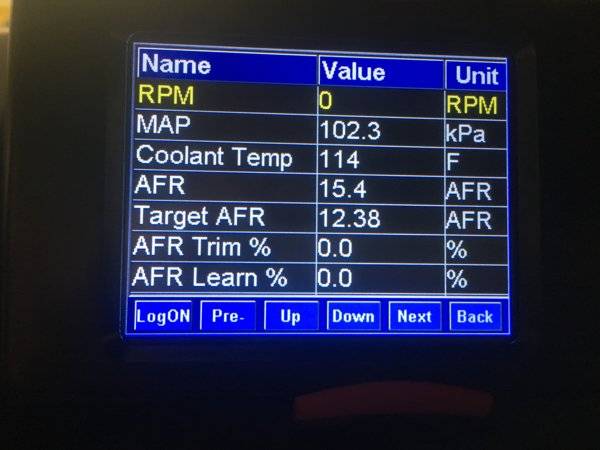

This is car not running (rpm 0) but key in run position.

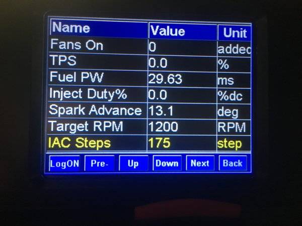

IAC steps seems to start hi before I start the car, then as it runs it comes down to about 4-4. This is key in run, but engine off.
I understand that cylinder temp is an estimate based on air temp and coolant temp? Think I read that somewhere.
