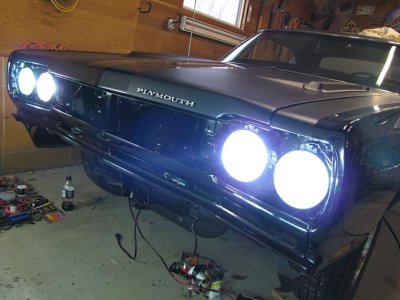

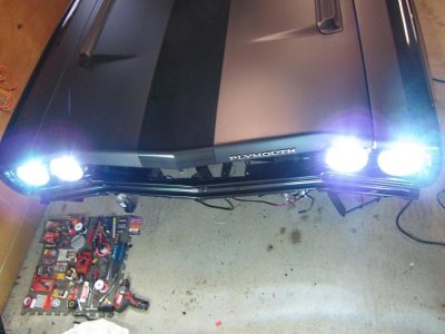

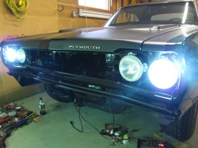

I need to update you guys with some pic's here in the very near future. The harness is in the car...the h1 High beams lamps are installed already and about to install the H4's. Good news is I hooked up a battery to this set up, running through the bulkhead, and everything works just as it should. The Hella lamps fit well in the buckets and the headlight trim/retaing rings hold the lamps in place nicely. As soon as it actually gets over 0*F and I get a little time, I'll snap some for you.
On closing this portion (with Pic's to come), I hope this helps someone else down the road. There are some things that could be different like; running inline fuses or fusible links or running a Single bigger circuit breaker instead of a double. You could also apply this to make a Halogen system instead of HID. Just run the wires that would be going to the plugs for the HID ballasts to the Halogen bulbs instead. I would recommend you upgrade to a 12GA. wire all around forward of the relays instead of the 14, being there's more continuous power draw and heat. Also, use ceramic connections at the plugs. As far as the HID, they draw a lot less, besides start up. Going off of info from Swede, on start up HID ballast can draw up to 15 AMPS each for 3-5 seconds and then dramatically goes downhill from there. That's why I went with 40AMP relays/breakers.
Like I said....Lights on pic's to come here in the near future.
