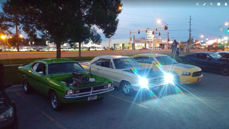

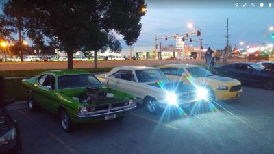

Hey Will, thanks for the great headlight upgrade thread. Followed all the steps and ordered all the same parts.
I've had them out on the street a couple of times now and all I can say is these are great lights and one of the best upgrades I've done yet to my 67.
Pretty amazing in the dead of night with the brights on, you can really see so much better. Thanks for the great DYI and info my friend!

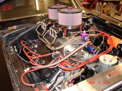

So I made the install in the GTX, AWESOME bright at night, however, they take a while to come to full bright and they flicker slightly ...yes..even when standing still.
Anyone had this problem ???
I have a genlll hemi and the alternator that came with it . They have their own slot in a 24 slot fuse block and the entire car has been rewired so I know the power is there.
