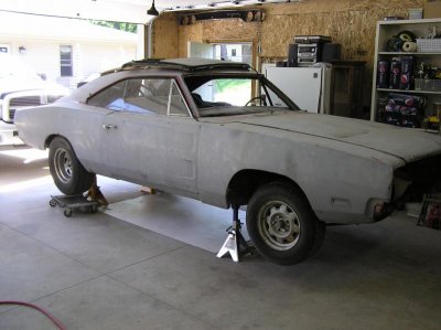

Let me first say, I have watched this forum for a couple of years before deciding to tackle a job like this.
Without the help and advice of those in this forum, I NEVER would have the desire to undertake such a huge project like this!
After reading and seeing all of the different resto threads, I have decided to start my own project thread!
This is what I started with

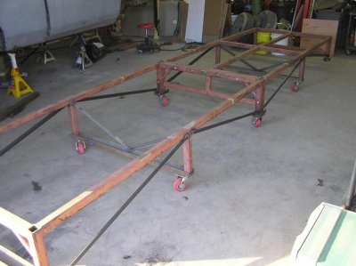

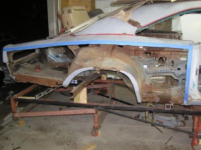

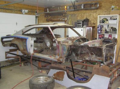

I saw and read where different members (Donny, Detmatt1, SGTPaul,) built their own chassis jig or body jig.
I liked the idea of everything being tied down and being able to reference back to factory specs.
I know it can be done by putting the car on jack stands (or other methods) but for me, (a beginner) I thought this would be the best way for me to go.

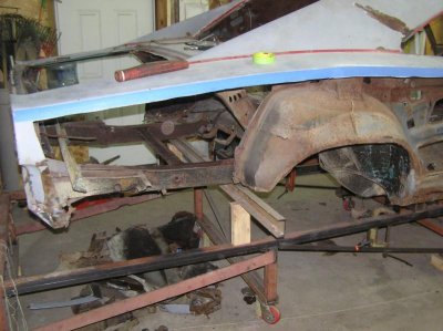

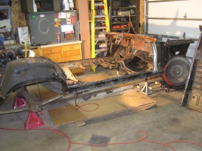

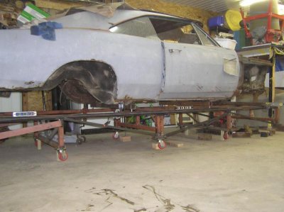

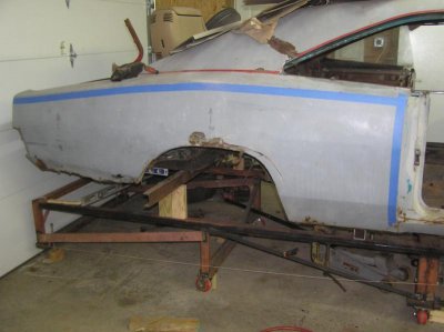

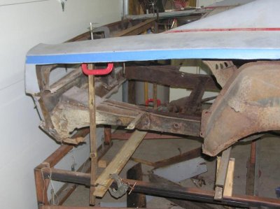

So I built a body jig to hold the car securely during disassembly.
The jig was originally a 4’x8’ table that I picked up at the local scrap yard. It was cut in half horizontally then put end to end to give me 4’x16’
It‘s made from 2x2 tubing with ¼ wall. And has leveling screws at every leg.

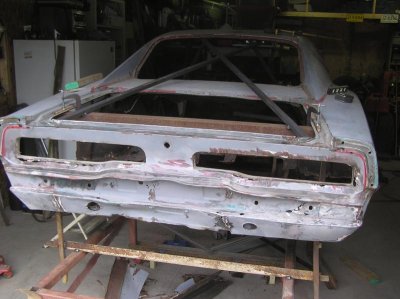

I cut the quarter panels off to get better access

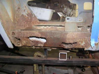

Outer rockers are shot!

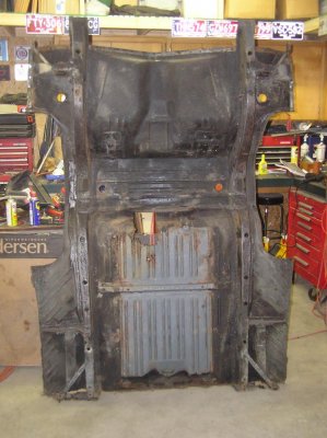

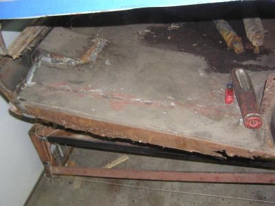

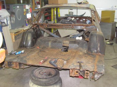

Trunk pan was patched long ago and will be replaced
So out it came!

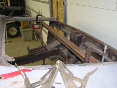

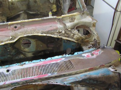

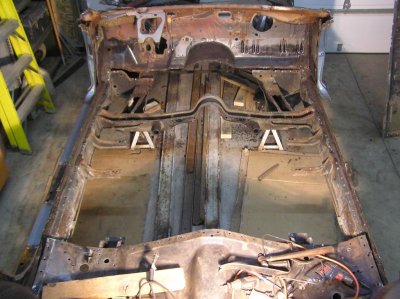

Next, time to remove the cowl
Lots of pine needles and a mouse house

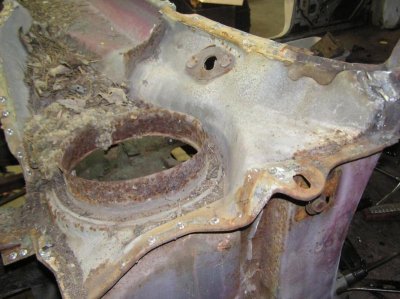

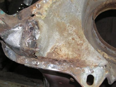

Rust damage around the base of the a-pillar, this will be fun to fix!
A diamond in the rough? I can only hope!

You are doing a great job Don. About time you show us what you've been working on. What are the plans for it?

Thanks Donny, When I made the dolly I wasn't sure how it would turn out, but it all came together.

That's a great project, you did a great job on that jig, that's very nice.
You have some serious work ahead of you and it will be well worth it when your done and cruising that car around.

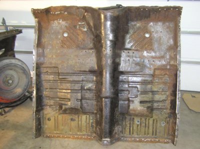

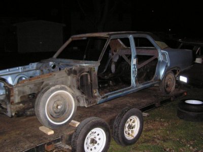

Let me catch everyone up a bit.
Over this past winter I bought and worked on dismantling a 1969 4 door Coronet that I basically got for the rear frame rails and floor pans. If needed, I would also be able to use the
inner fenders,
inner rockers
outer rockers (I would need to patch the cutouts for the rear doors)
torsion bar crossmember
upper and lower cowl
and the rest of the entire front clip if needed.
A HUGE THANKYOU to moparmarks for his help and advice for the above info!
Another thing this car did was give me the opportunity to “learn” how to take these cars apart!
You can read about it in my thread.....
http://www.forbbodiesonly.com/mopar...g-Uni-body-parts-for-a-69-Charger-restoration

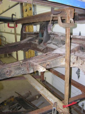

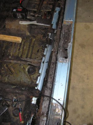

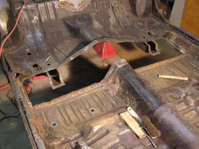

The floor pan will need some patching in the driver and pass foot well area.

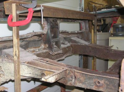

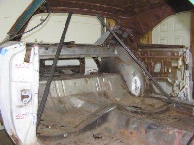

Decided to brace up the back side of the car in preparation for rear frame swap.
I liked the way Hunt2Elk did his so did it the same way. Thanks Elk!
