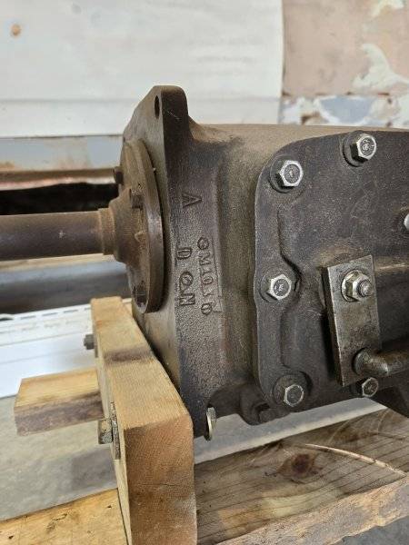

Ok....I’ve got updates,

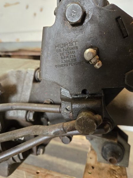

Bought the A833 from Clay and Sons! It came with a Hurst control assembly with overdrive.
Clay gave me a deal on a Bell housing too.
I've done some decoding. Double check me and see if I'm close.
Main Case:
C-99129: 307 Bearing/23 Spline
VIN Pad: PP8335674 - Might need a little help
5674 - does this mean the main Case was cast on the 56th day of 1974?

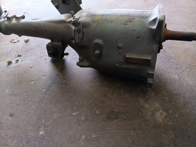

Tail housing:
C-99539: E Body and B Body
Take a peek at the pics.

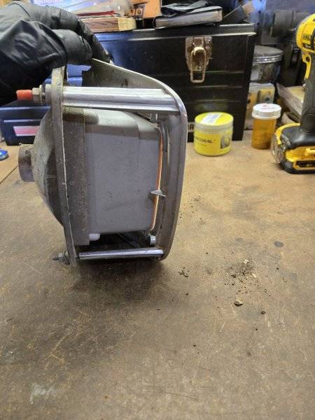

2. Tail Light Assemblies-
carefully photographed, disassembled, inventoried, catalog missing fasteners, recorded number stamps, cleaned, wrapped, labeled and boxed.
The Left Hand tail light assy. is different from the Right. Hand tail light assy. (See pics below). Is the LH assy. Broken and "repaired" or is this common?

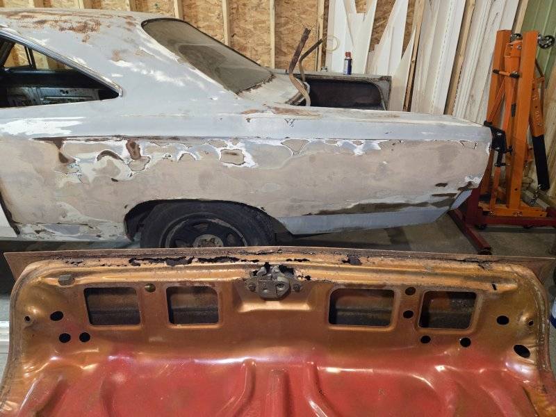

Back Glass is out and no cracks, breaks or boo-boo's
That 56 year old sealant didn't want to give up! I think the rear glass was holding the car together though
Heres the Before pics.
