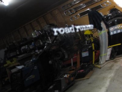

Wow, that compressor looks like it can take a lot of work time, Good luck in picking up steam and moving ahead!
