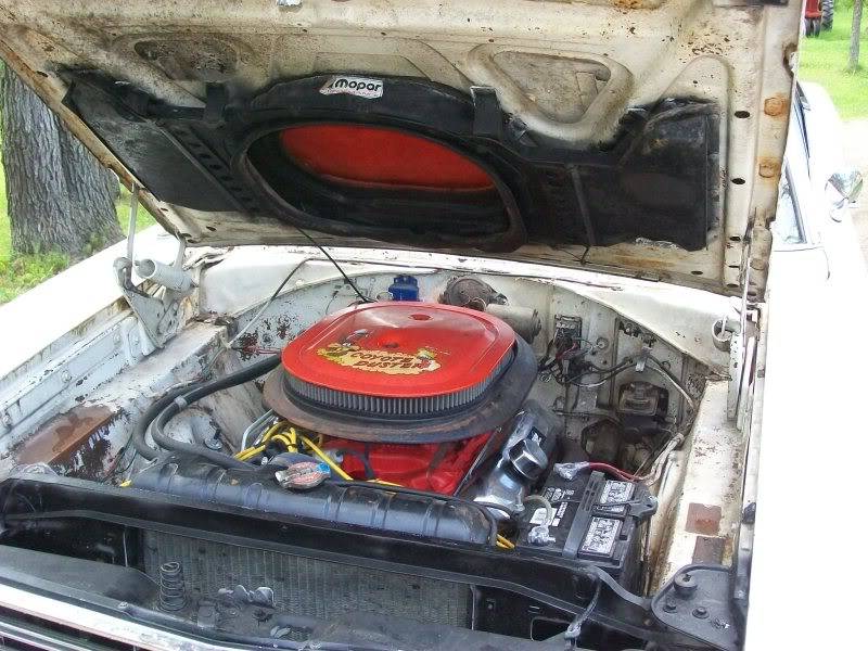

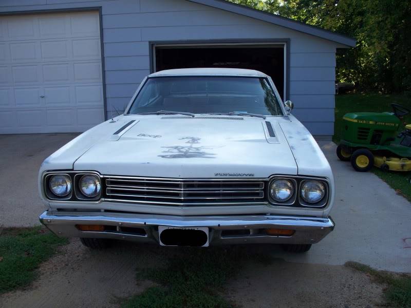

Howdy guys, it's time to break ground on my 69 roadrunner.
Maybe a little intro first.
I purchased the car late last summer, drove it for a few months and put it away for the winter.
It's a lynch road 383 car with a 4 speed. fresh air hood, power steering, tan interior, exterior originally T7 bronze with white vinyl top.
It was painted white in 76 and at that time it also got some era correct mural and funky panel color paint.
Body hasn't been touched since it got this funky paint job in 76.
(this is a photo from the ad previous to my purchase, hence the license plate black out)
