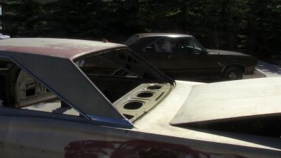

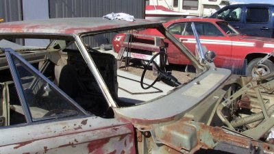

My new project is a car I saw 15 or so years ago. I went back and it was still there, it had been parked in 1978. I paid $200 for it and brought it home. This was $150 more than the roving crushers had offered so we were both happy. After inspecting the car it appears the floor, trunk and frame rails are near perfect with only one little hole where the gas pedal goes and a small hole in each wheel well in the trunk. It would be nice to find a couple fenders, but these can be repaired if need be. The rear quarters also can be fixed but a donor car is what I will be looking for. I think it will become a big block car with an auto trans. I am thinking about making it an R/T clone, but I'm not sure about that. I have to give credit to Daredevil, his car is what lead me to go back and rescue this one. Anyway here's the starting point.

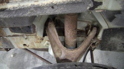

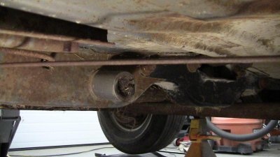

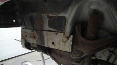

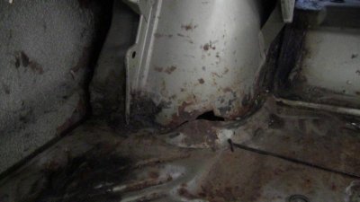

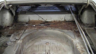

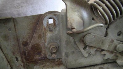

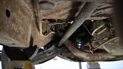

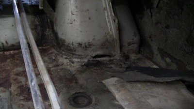

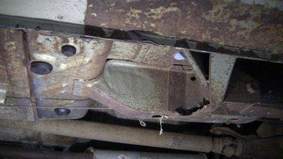

Some pics of the trunk and from underneath.....
Still nice balck paint on the LCA's

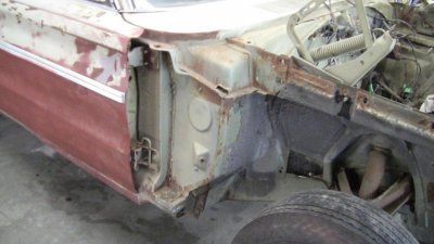

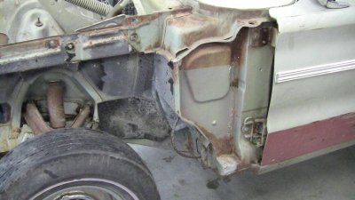

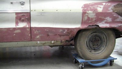

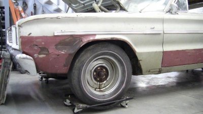

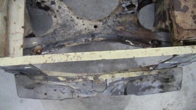

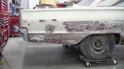

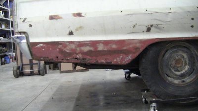

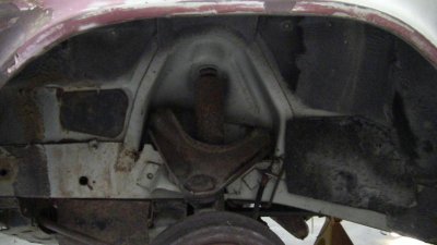

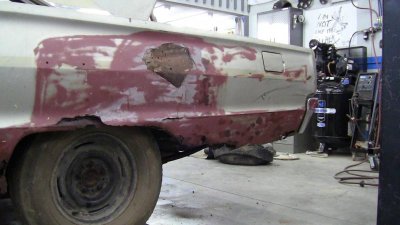

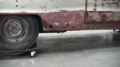

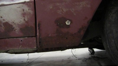

Well I figured I had best get at it! So yesterday I pulled the engine and trans. I also sanded down the passenger quarter to see the full extent of the damage. It aint so bad. I should be able to patch if I can't find a quarter section for it. The drivers side however is much more labor intensive. The engine bay is phenomenal. There is one small blister by the drivers side hood hinge, pretty minor. There is no rust in the control arm area and nothing on the frames. The rad support has a slight bit of damage from the original owner hooking a chain there to tow it home! Easy fix. Today I removed the front fenders. They are both savable with work but I would like to find some replacements.
I have a line on a near complete 65 Fury III interior. The guy has buckets, rear seat both with new material. He also has a console, new door panels, chrome in and out, gauges, headlight bezels, a fender, trunk pan, quarter pan, a new headliner and a new carpet. The headliner and seats are white whereas the carpet is black. I know I cant use all this stuff, but I think I will try to use whatever I can and sell off the rest. The price is way right. I know they aren't the same car but I think the body size is very close. I am not doing a resto so exact part matches are no matter. Anyway here is the last couple days progress.....

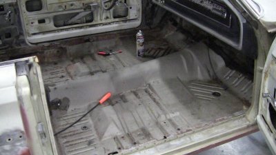

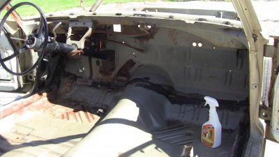

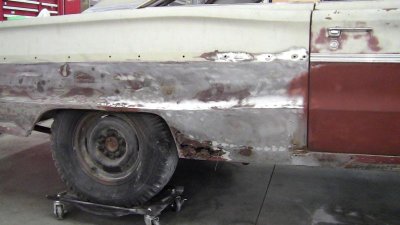

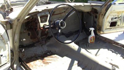

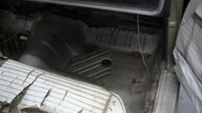

So today was the day to finish the strip down. Man It was hot out. I also cleaned the rocker panels out with a wire and a pressure hose. Mice had made their way in and built a nest on each side. With a long coat hanger I was able to remove them and then wash them out profusely. Then I removed all the chrome trim around the doors and windows inside and out. At that point I removed the windsheild. I just cut the seal as it was damaged already. Too bad the glass was damaged because it came out like nothing. Then then heater and the dash. Wash some more and wait until the heat of the day to do the back window. I put the wife and daughter in the oven and we got it out without breaking it. It is a little scratched but I think it can be polished up to look like new. I saw a thread about wives accepting our hobby......mine does!! It was nice to find no rust in the lower corners in either the front or the back. Here is how it sits now.....
