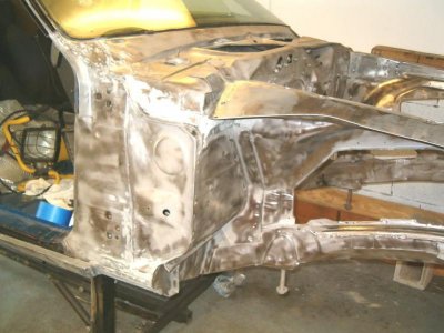

o.k. here are some of the progress pics .
all metal before filler on welded patches on the firewall

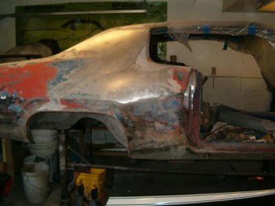

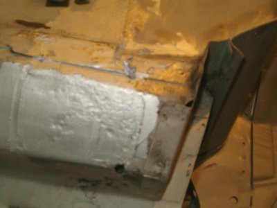

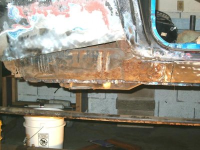

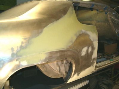

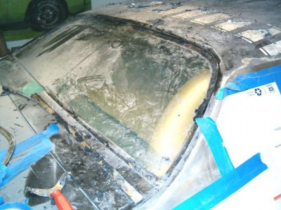

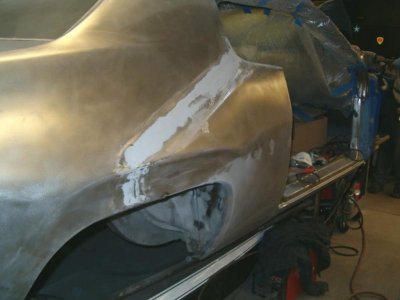

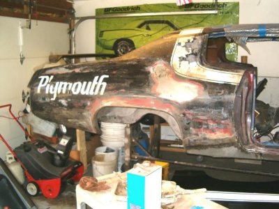

got back to work on the rr jan 2012 till now cut out bad metal weld in good metal on the pass side 1/4 and door and taking the rest of the runner down to bare metal still finding rust not a bunch but there are some hole here and there .the back glass was fun ! they sealed the whole thing with urethane then set the trim in the urethane i spent hours cleanig that mess up .
gross

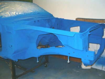

here are some current pics of where i am on the runner . . i am hopeing that in about a month from now the motor compartment , underside and trunk will be in TRUE BLUE METALLIC .
got some bit more done over the last month
painted the underside first in acrylic enamel the a week later we did the engine compartment in the base / clear
