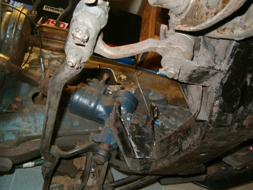

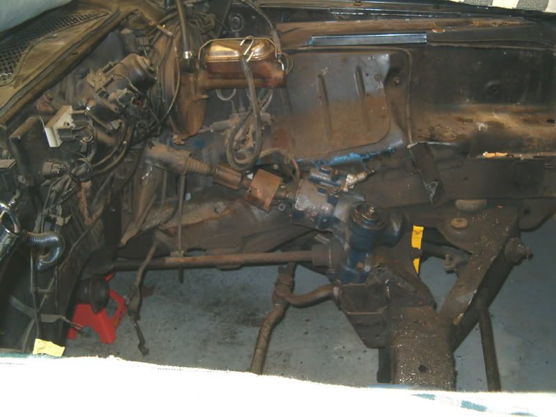

anyway i put the 440 uild on the back burner for the time being and stareted stripping the firewall and inner fenders plus removed & dissassembled the K frame . all i have to say is i friggn HATE underecoating

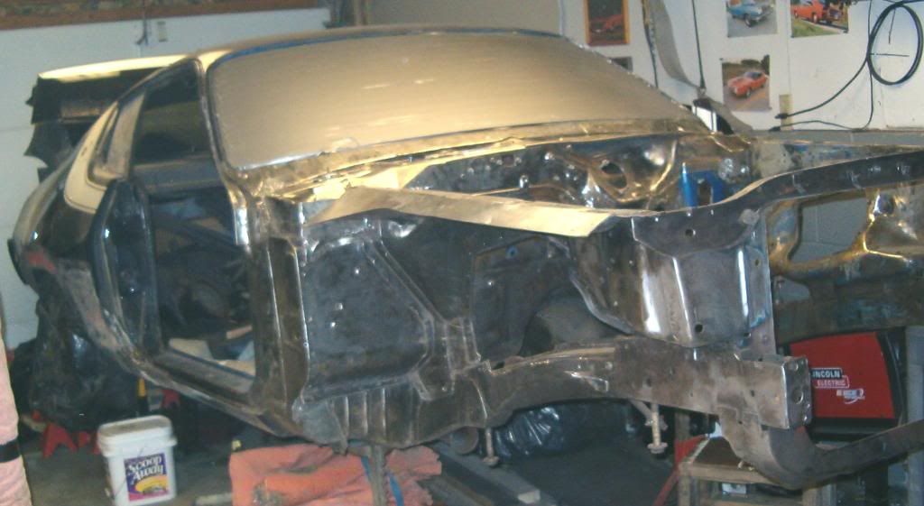

finnally got down to bare metal

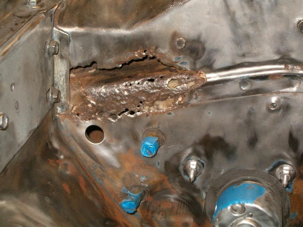

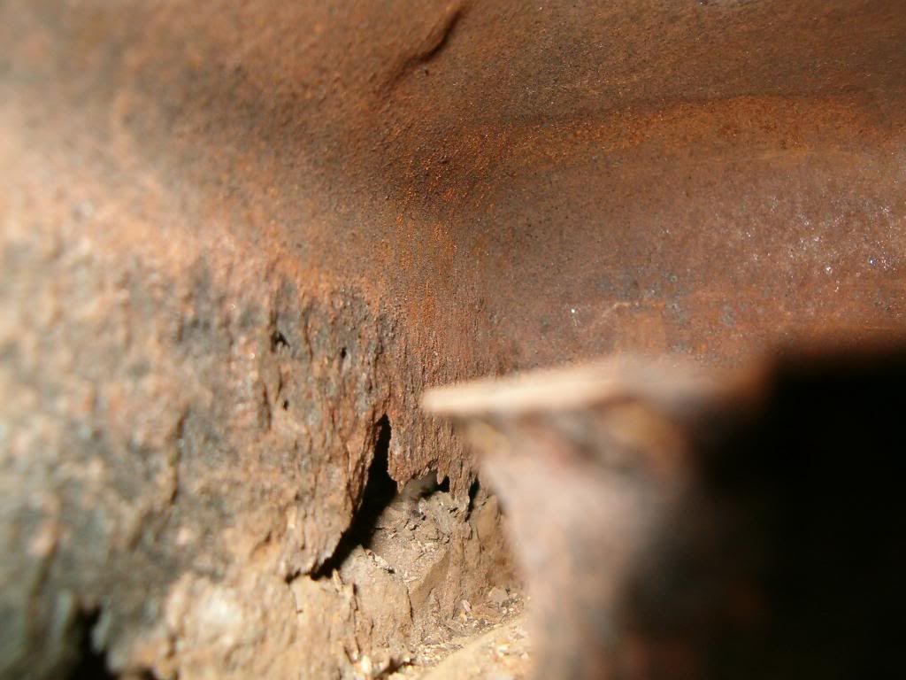

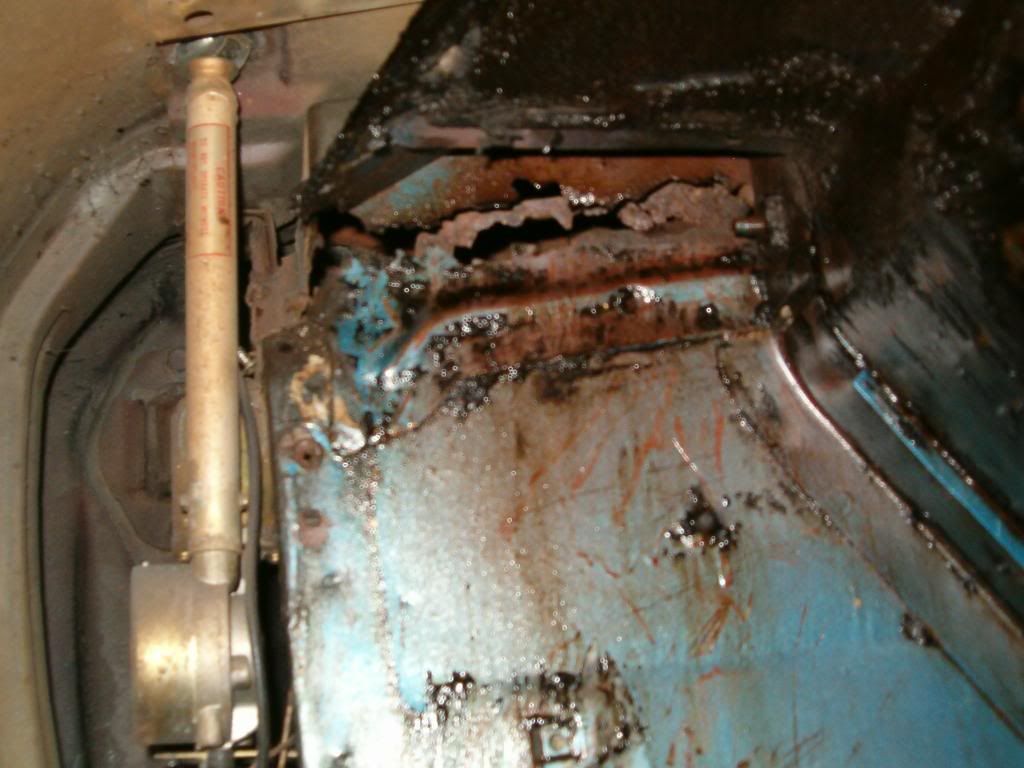

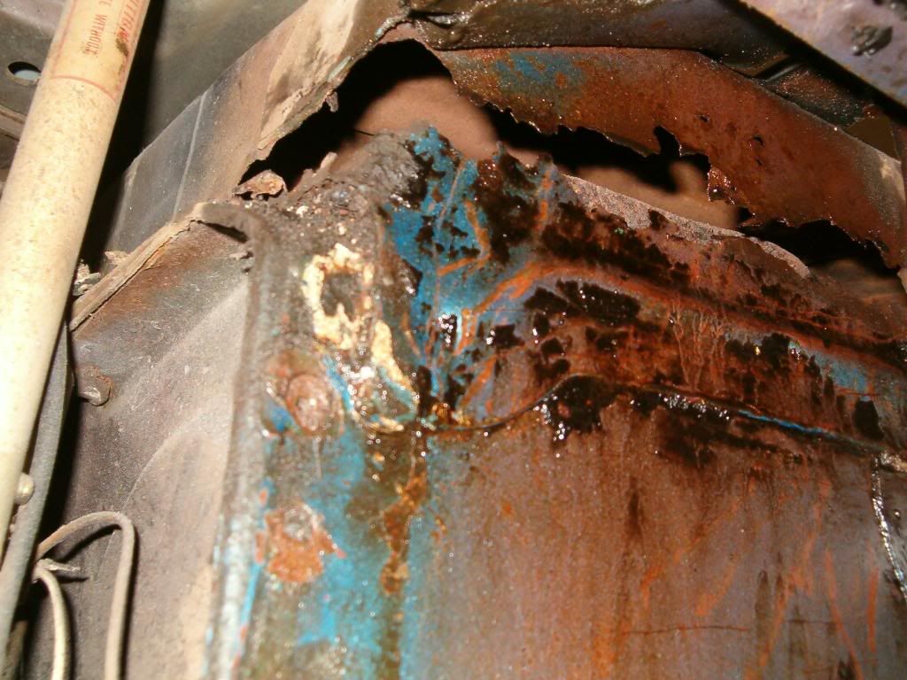

the cowl is in bad shape and i have no clue how im going to repair the air duct HORNS / INTAKE or what ever they are called

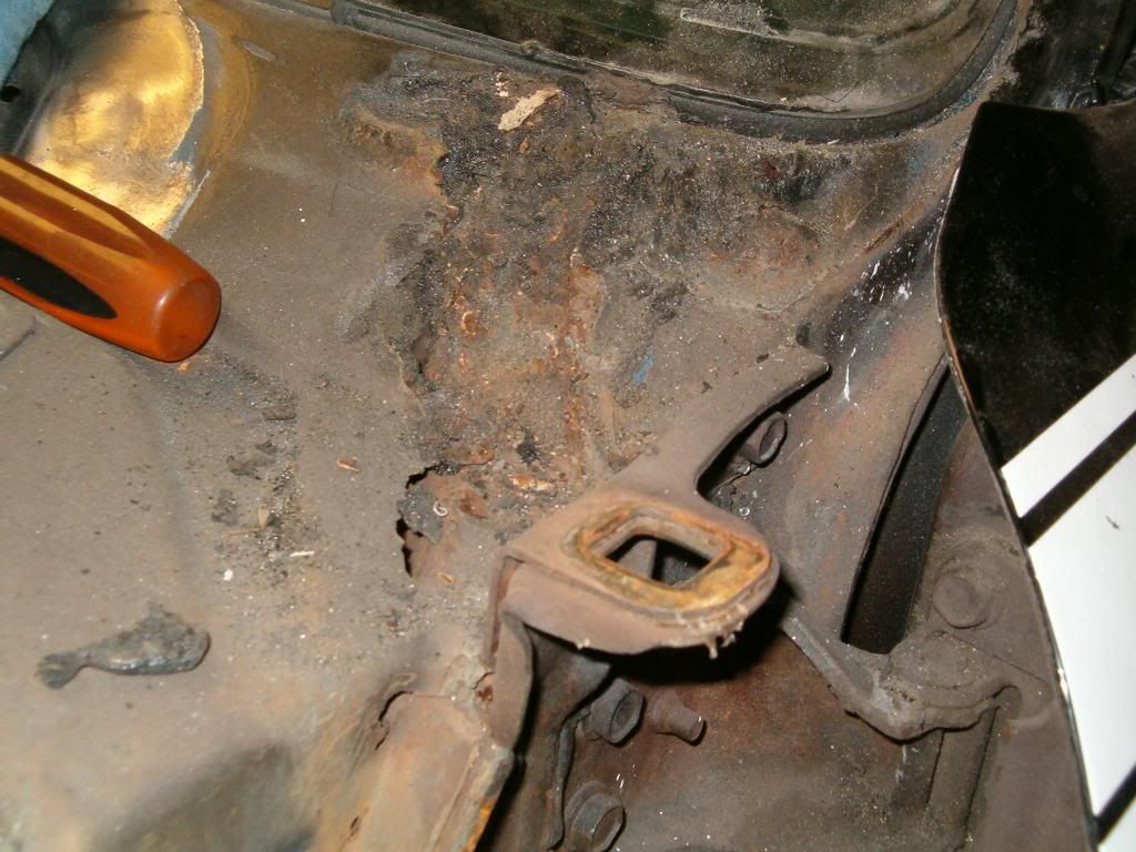

here are pics of inside the cowl IT AINT PRETTY

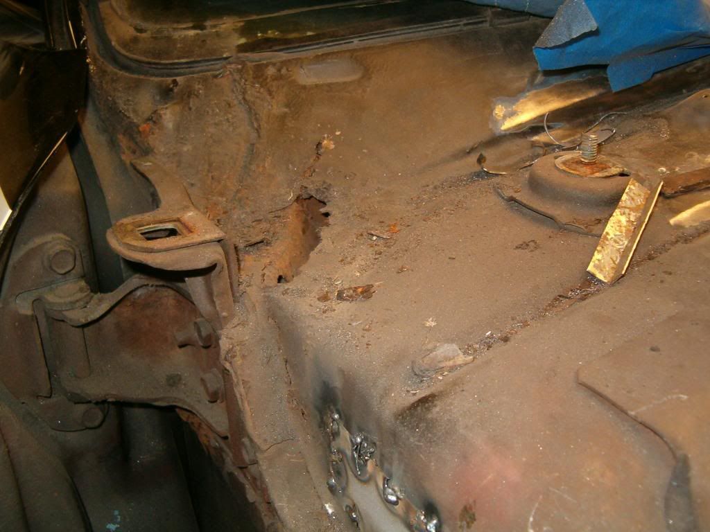

here is the wrought i found on the cowl in the inner fenders althought none of it is structural it still needs to be adressed and repaired luckily all the damage is at the top and not down at the frame
nasty undercoating i think they tried to armor plate the car with this stuff i swear some places were over a 1/4" thick but it did keep rust away for the most part so ill give it credit for that
inner fenders are down to bare metal and just some more prep and it DTM and paint

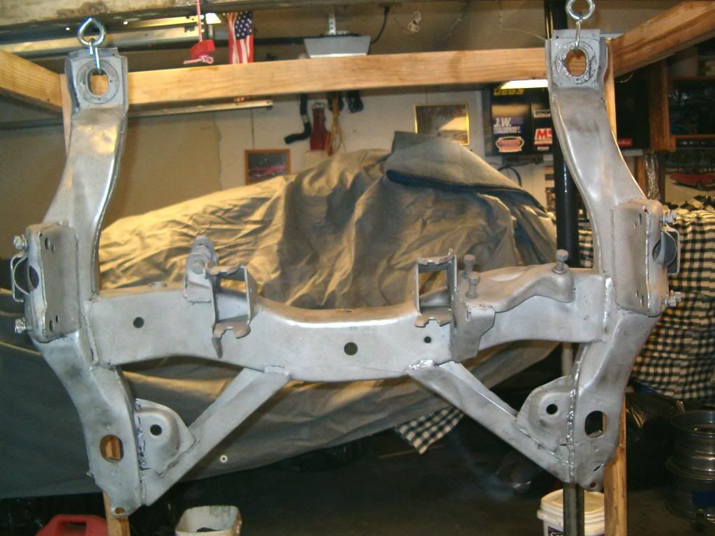

here are some pics of the K frame & parts before and after but not reassembled im waint on $ for the suspenion parts

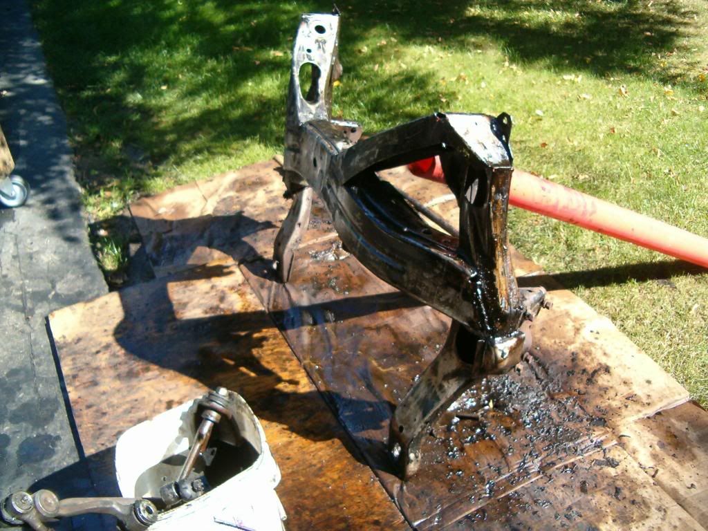

K frame after about 6 hours of scraping and scrubbing with kerosene
make shift sand blasting cabinet for the K frame

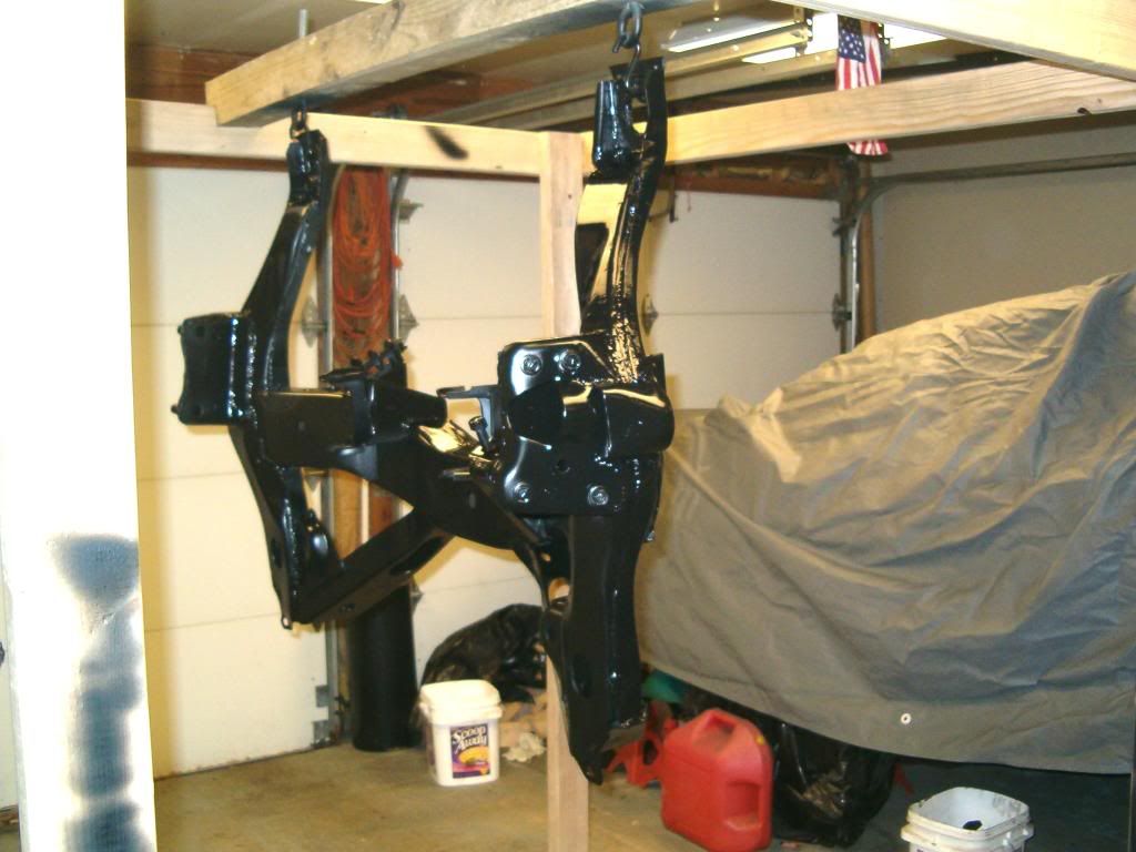

K frame and parts blasted and ready for paint
K frame painted in black satin it looks glossy but it toned down real nice
parts hanging and drying

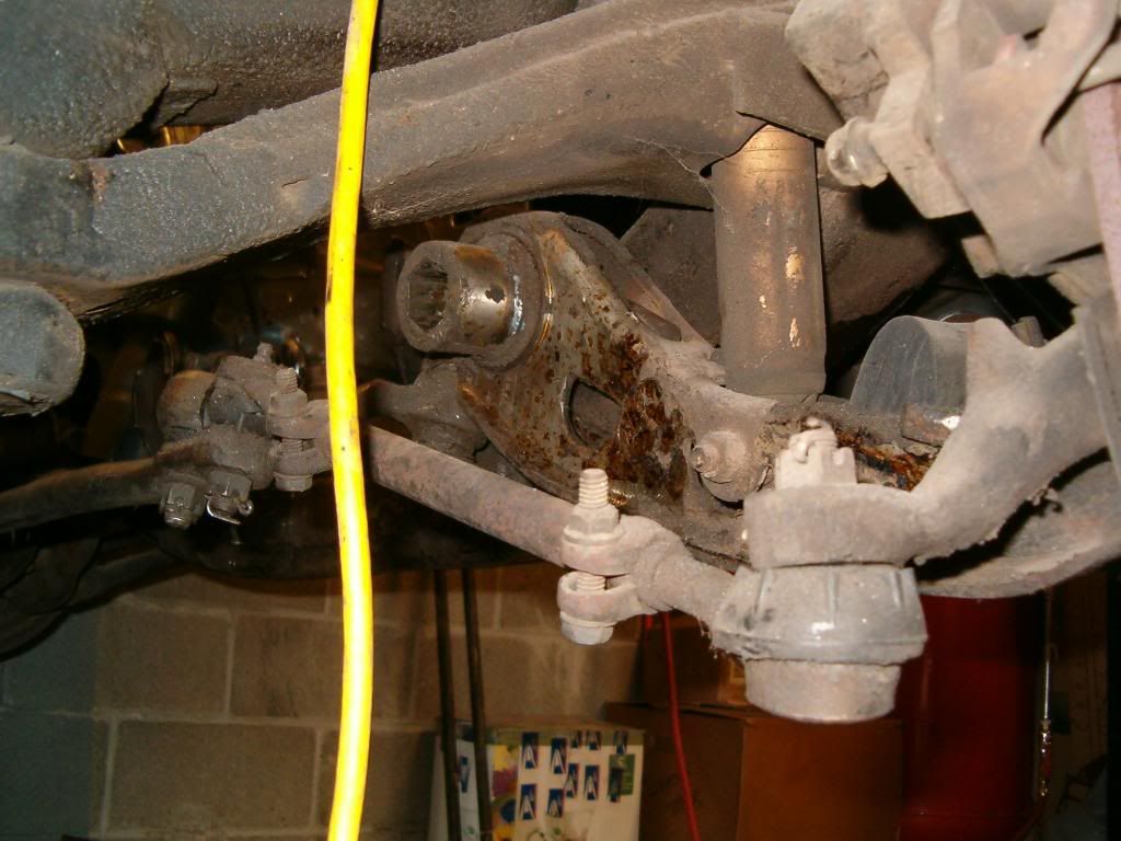

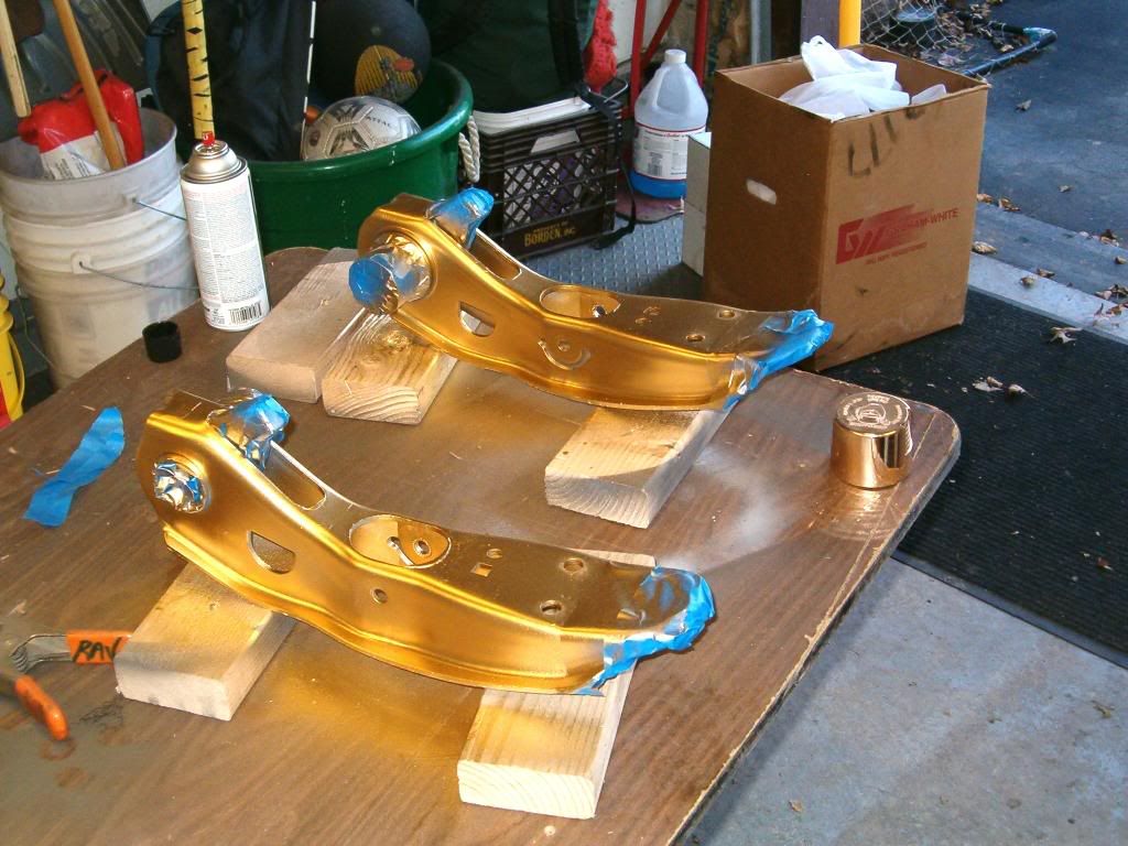

lower control arms
and the road runner as it sitts now
Awesome work! That K-Frame looks really really good. How did you remove the undercoating from the car? Also, on the cowl rust, you may need to find a donor piece from another car. I am sure there are wrecked cars with that part in good shape still.
thanks , i used kerosene and alot of it :grin: i put it in a spray bottle & sprayed it on let soak for awhile it took along time to do but worked fine . im going to have to wing the inside of the cowl being there is now way to really get in there to do repairs as for the firewall i have the donar parts .

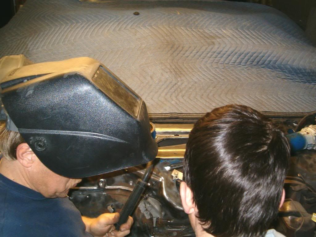

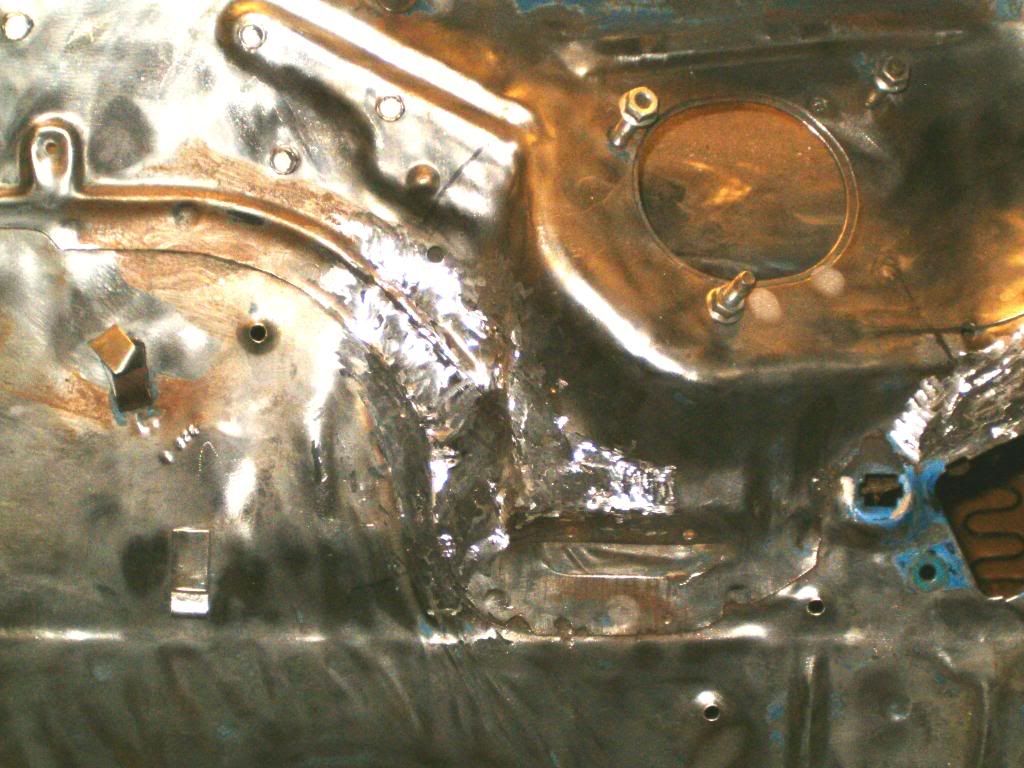

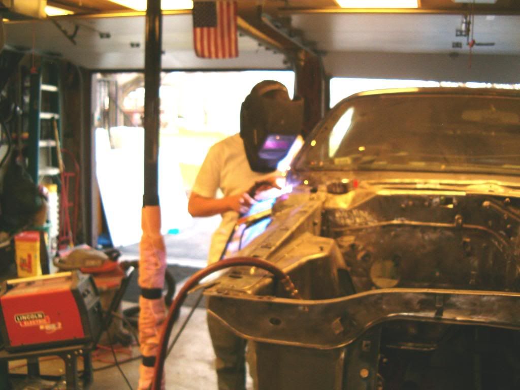

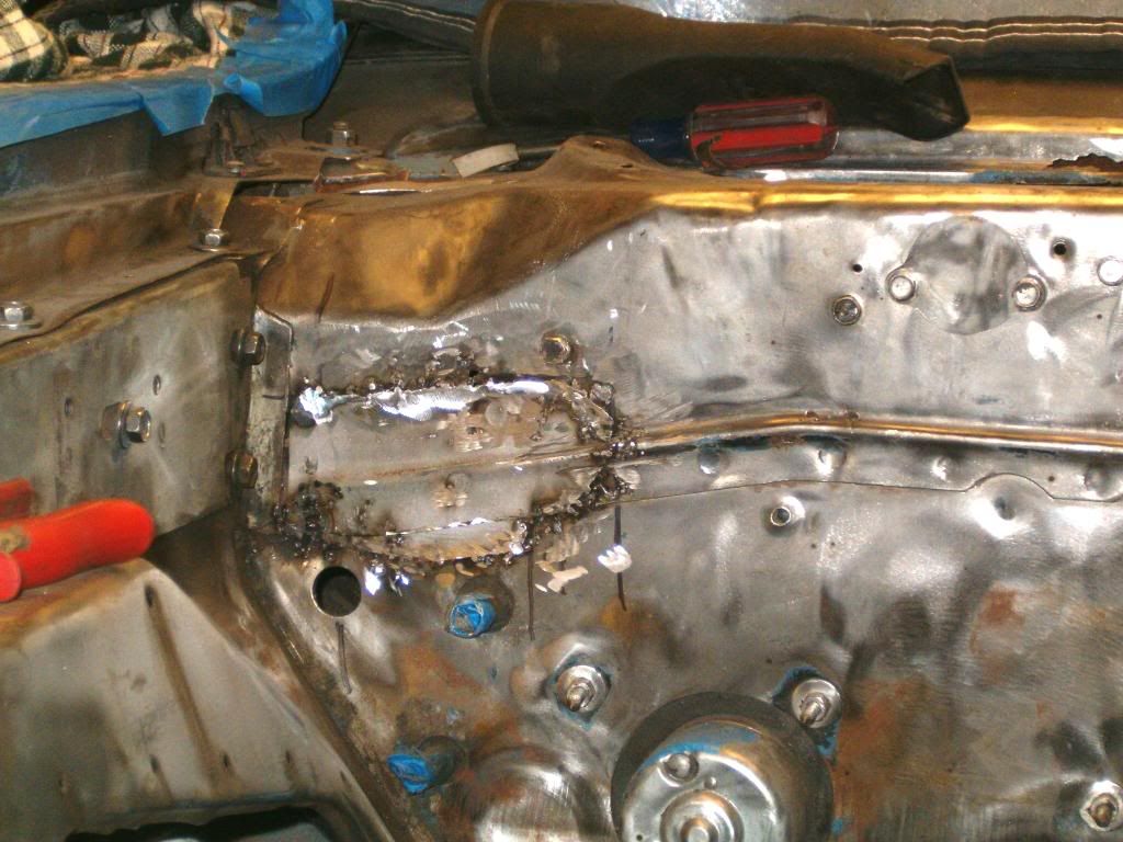

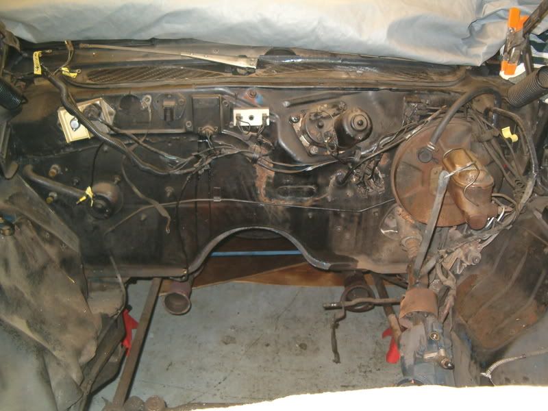

got a little more work done on saturday we started fitting and welding in the firewall parts that generaljmwlee was kind enough to go out of his way and cut from a donar car for me . theres alot more welding and grinding and filling that needs done befoe paint but i think it looks %100 better than it did already .
my neighbor JAMES is helping out my friend JOHN with his 68 GTO resto and me with the runner for his class project in high school
firewall
my weld job its been well over 20+ years since ive welded :sad:
JOHN and JAMES welding the piece below the wiper motor
more to come

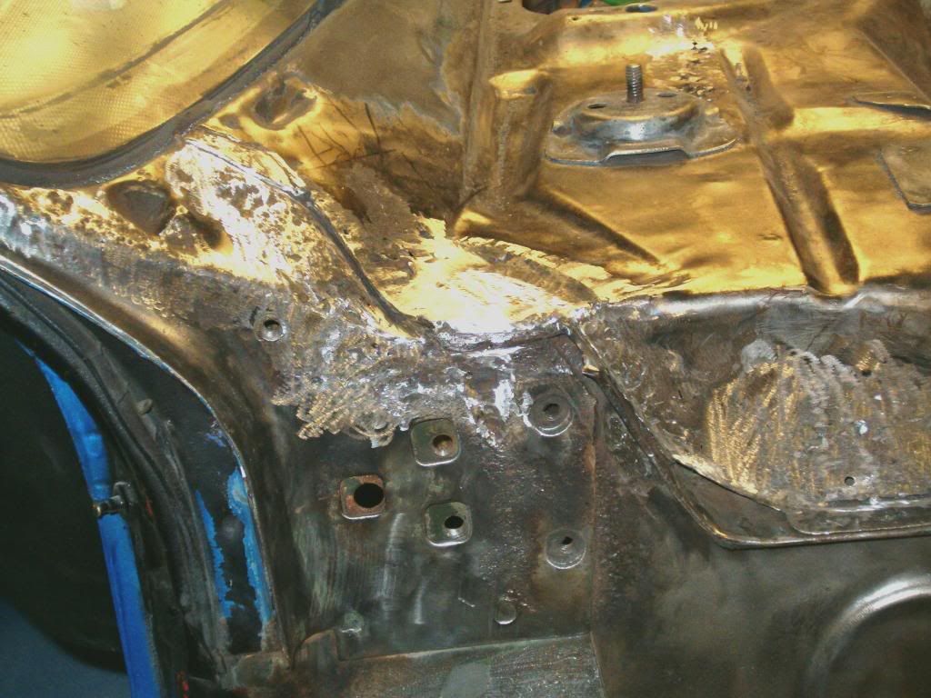

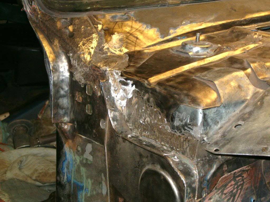

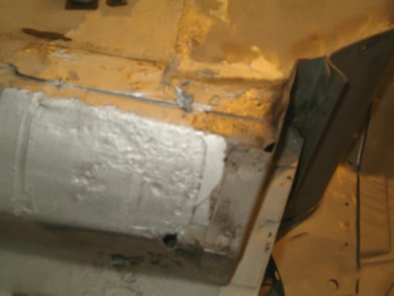

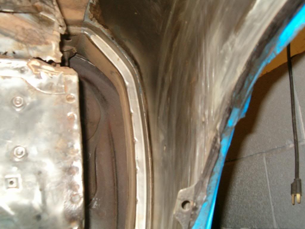

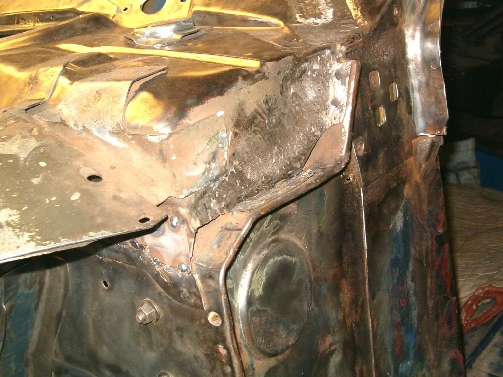

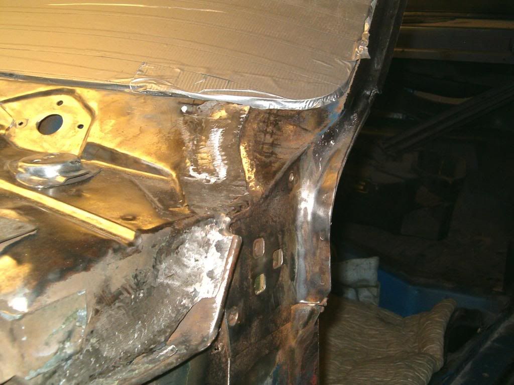

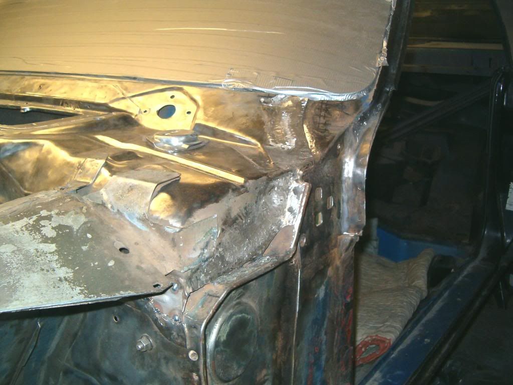

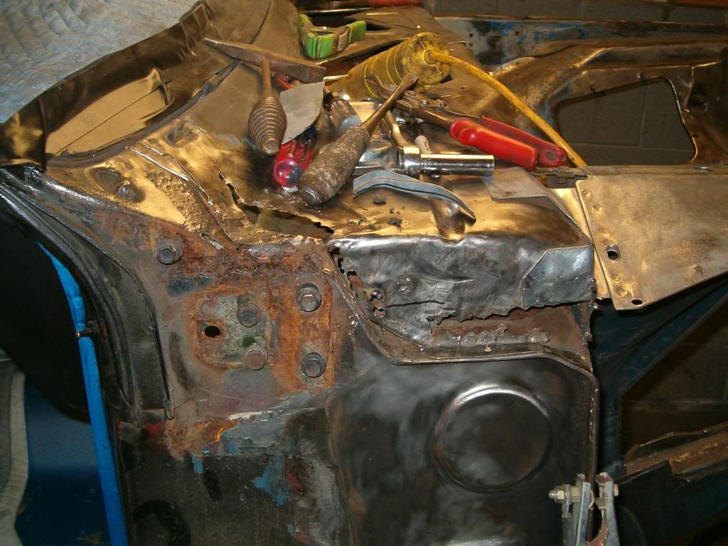

wow its been awhile since i posted on the slow progress of the rr . here are some pics . we onlly got to work on it a few weekends over the winter and the last 2 saturdays in march , well it looks like we didnt get much done but it sure feels like it the past 2 saturdays were spent welding and patching the cowl corners and smothing the welds im sure a pro could have had this done in an hour were as it took us 19 hours of course we stoped for a beer here and there but we are at the point where the fire wall is almost completely pacthed in and ready for ALL METAL filler the soon hopefully primer and blue paint
the firewall is pactched in and 90% ready for filler

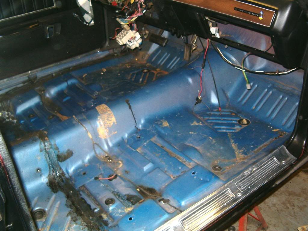

interior gutted thank god the floors look perfect

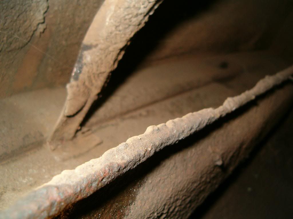

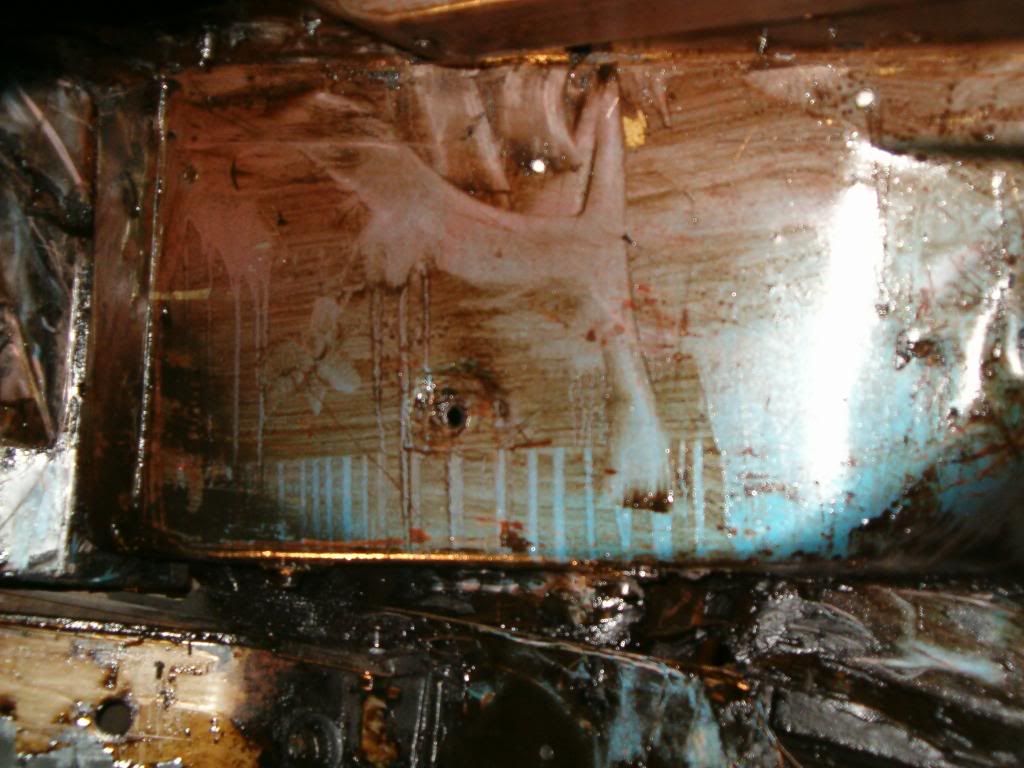

after rooting around inside the cowl i discovered this isnt a factory part " the black spry foam "

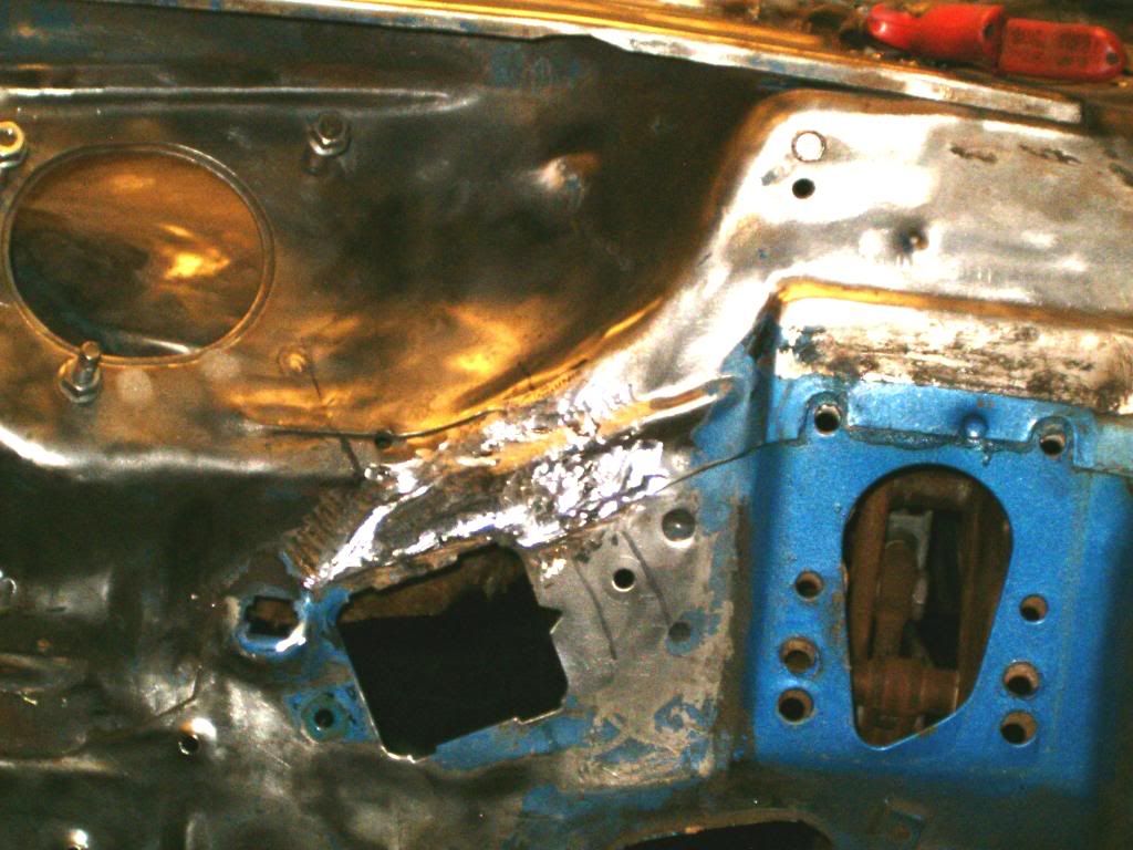

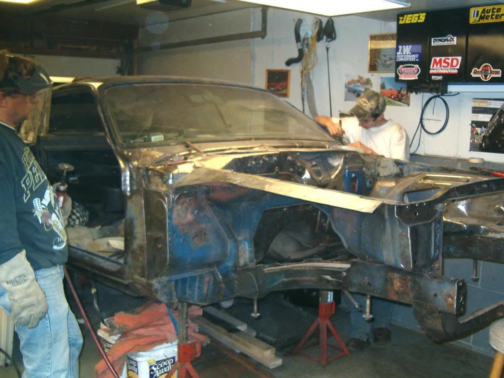

so i dug that out and found that the corners of the cowl were toast , off came the frontend and doors to do a little bit more investigation i wasnt happy with what i found .
so it was cut form patch weld grind for a long time as i said we are not pros but im happy with the result
Congratulations, that looked like a pretty tricky repair, well done.
You might be able to get at those Air intake rings inside the cowl from under the dash, but you will likely have to remove the dash in the process.
Yeah, that looks like a fun job! Remember, most of the fun is in just 'doing it'. I'm not too familiar with the 71+ B Body's cowel, it looks like it does not come off like the previous generation B Body cowel does. They all are rusted under there, except cars from the southwest, I got lucky with my donor front clip for my GTX, it came from that area of the country; no rust! Man, I can't imagine spending 6 hrs cleaning a K Member with Kerosene and all that mess; you're a better man than I! All in all, it looks awesome though, will be following this thread!

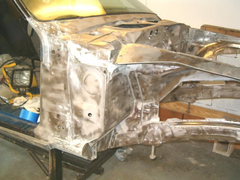

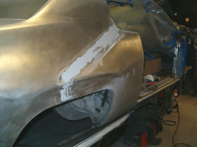

o.k. here are some of the progress pics .
all metal before filler on welded patches on the firewall

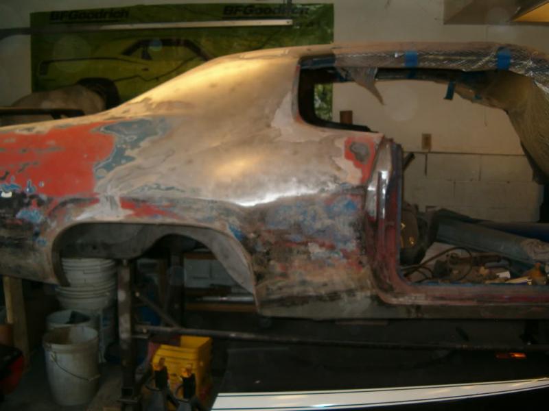

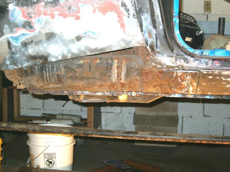

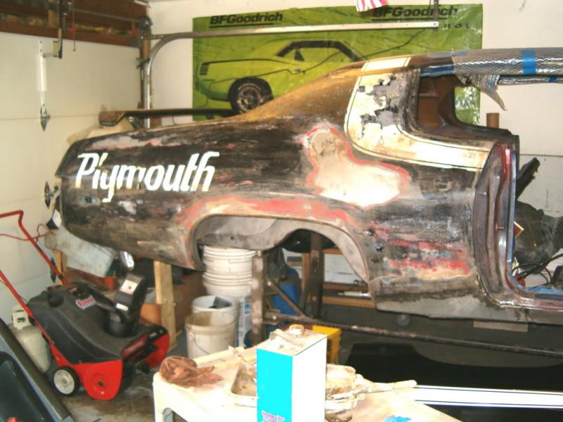

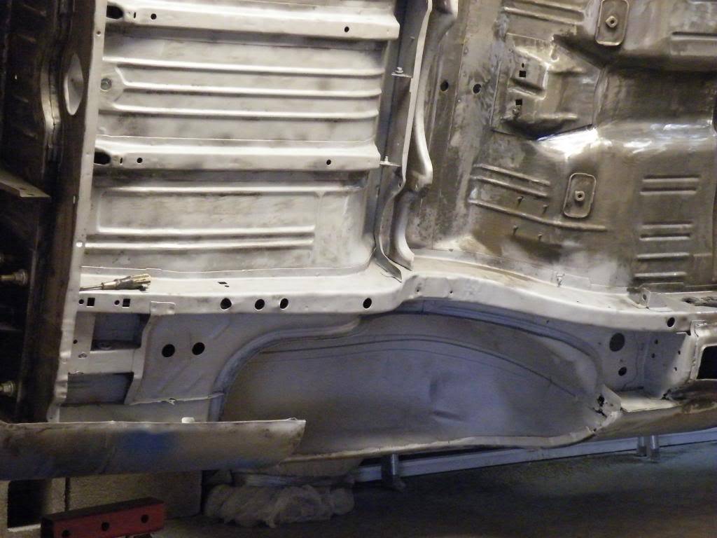

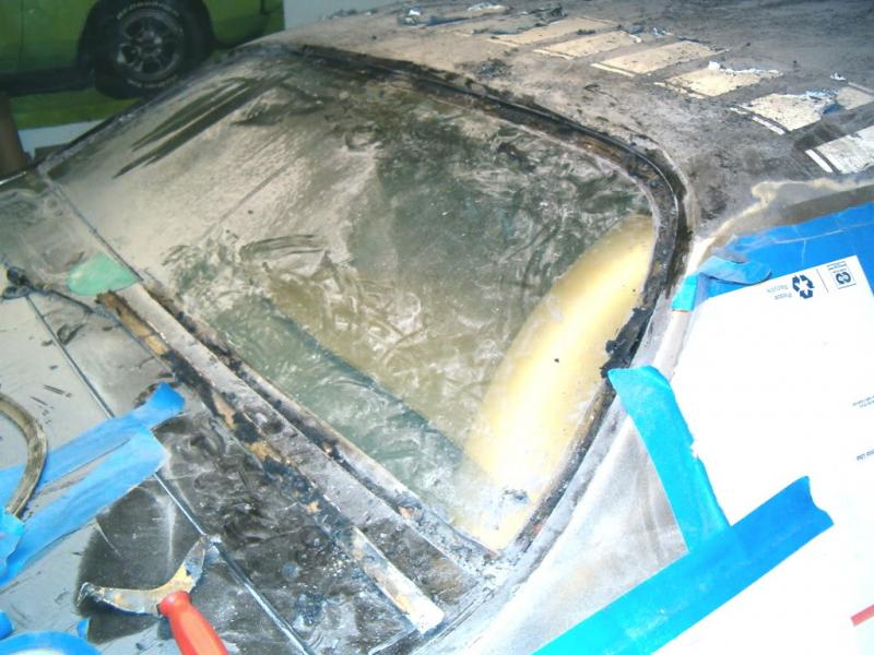

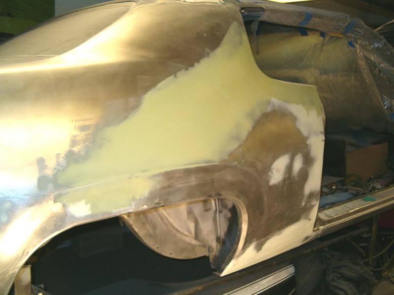

got back to work on the rr jan 2012 till now cut out bad metal weld in good metal on the pass side 1/4 and door and taking the rest of the runner down to bare metal still finding rust not a bunch but there are some hole here and there .the back glass was fun ! they sealed the whole thing with urethane then set the trim in the urethane i spent hours cleanig that mess up .
gross

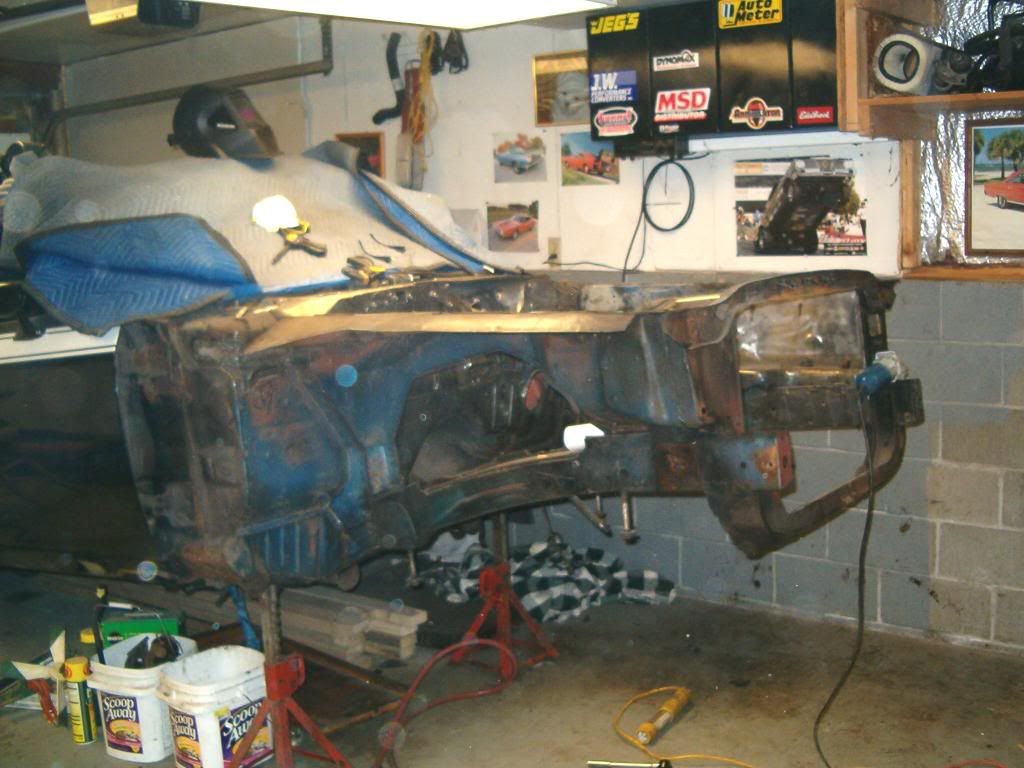

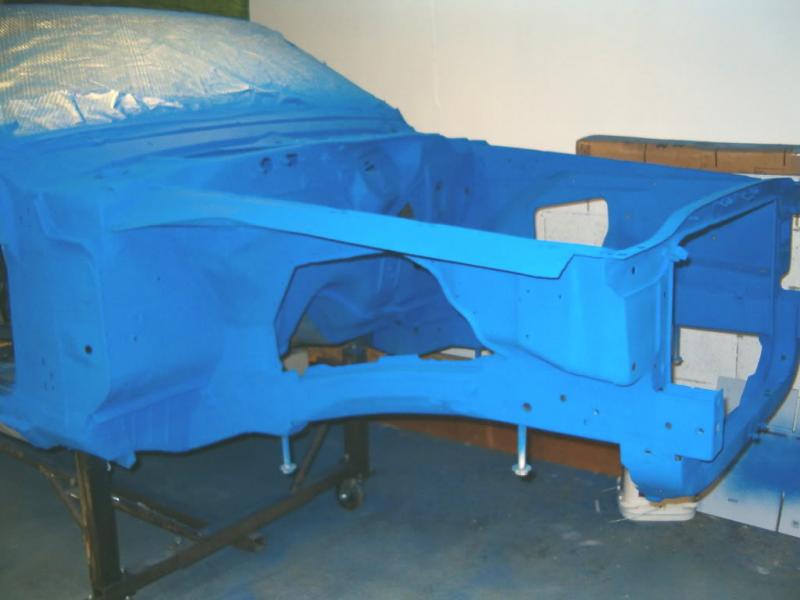

here are some current pics of where i am on the runner . . i am hopeing that in about a month from now the motor compartment , underside and trunk will be in TRUE BLUE METALLIC .
got some bit more done over the last month
painted the underside first in acrylic enamel the a week later we did the engine compartment in the base / clear
Looks great. I did the same thing on mine and ended up cutting the cover over the cowl out to make my repairs. Like you, i had rust on the air intake for the a/c , where the upper and lower cowl pieces met at the fire wall, base of the windshield and especially in the corners. I didn't have the benefit of a donor and ended up gabbing the pieces I needed.
