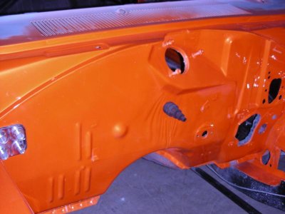

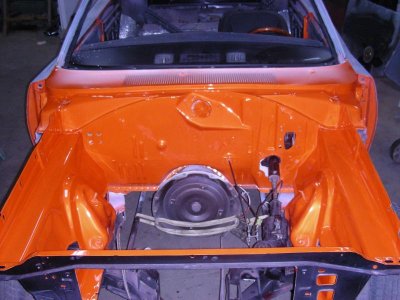

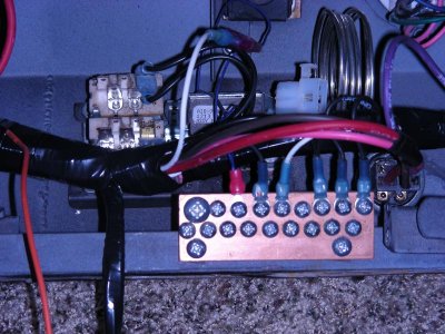

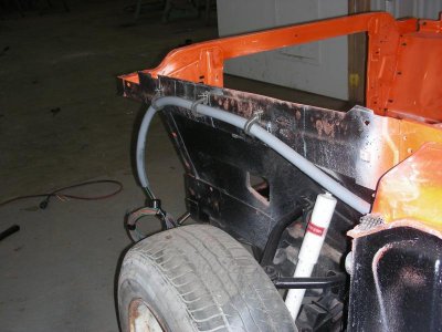

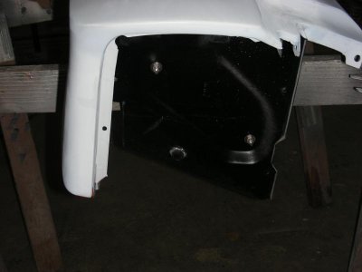

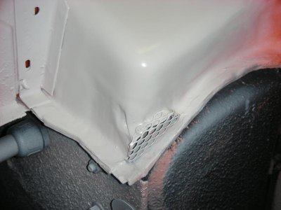

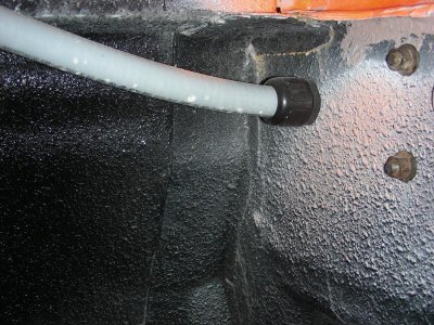

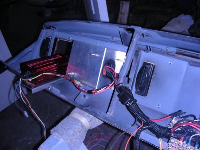

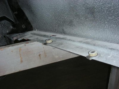

Hears the pics someone asked for. Forgive the mess, I've been doing allot of sanding and everything is pretty filthy. The fuse box is mounted right beside the 6AL ign box. The fender is sitting on it's side in the pic but you can see the coupler for the seal tight conduit, I used small pieces of pvc pipe to fit over the fender nut clips so that you have something to torque the hangers to. You can see in the engine bay pic the boot I used for my harness. Knowing allot of electrical issues come from bad grounds I made a central grounding bar out of copper drilled and tapped and grounded directly to the main ground, everything on the dash is grounded to it. DSCN6509.jpgDSCN7671.jpgDSCN7675.jpgDSCN8435.jpgDSCN8436.jpgDSCN8437.jpgDSCN8439.jpghttp://www.mcmaster.com/#standard-electrical-conduit/=omgsx3

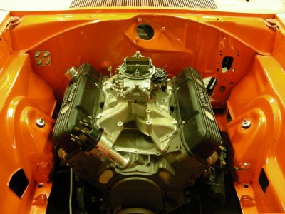

Here's a pic with motor installed, can't see the wires. O.K it appears there is no wires yet but you can see the boot isn't visible.engine bay.jpg

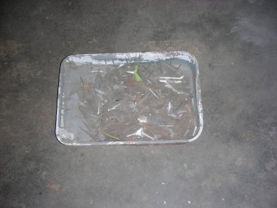

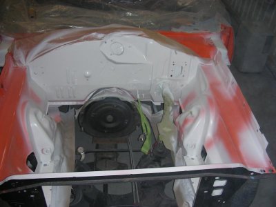

Not what I wanted to get accomplished but after the PITA that the firewall turned out to be "I'm just glad to have a clean slate again". Since the fenders are off I took a pic of my idea for mouse protection "hate those critters". Here's a pic of the clear off of the firewall in a bucket "lovely". I ended up using a razor to get it off but it came off easily "kinda" which meant nicks and scratches so it all got sanded with 400 grit them re primed in white. Hoping to paint it during the week so it will be done before next weekend and free up time to work on something else.DSCN8440.jpgDSCN8441.jpgDSCN8442.jpg

Thanks glad you like it, I'm sure you could smooth them over but the guy that aligns it will probably have a few choice words. I'm sure they could do it seeing how they no longer have to look at bubbles on a level "hell I did a half a$$ alignment on mine and didn't even use the holes" but that was with the motor removed. Can you put the bolts in backwards where the bolt head is outside making it adjustable from the outside? I didn't worry to much about them just because they are so far down and not to noticeable, I am considering making a few nice covers painted body color. If you smooth the shock towers like I did weld the seam completely all the way around, this will seal out moisture and eliminate flexing from cracking the filler. I also welded every screw hole and any hole I wasn't using shut. I think the number one thing that cleans them up is getting all of the wires out of sight, battery too. Good luck
I've had a few asking about the hidden wiring so as soon as I get it back together I'll post some more detailed pics for anyone interested. As for progress, I'll likely re shoot the engine compartment tomorrow. Loving the House of Colors sealer-primer, I did a little 120 grit sanding while removing the clear and expected to have a bunch of scratches to fill "where did they go" this crap is like magic. I even guide coated it and only could find minor unevenness where I sanded a little deeper "good stuff".

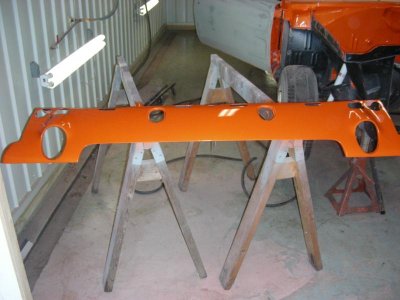

Hunting was a bust, my morning hunt was a new spot that showed allot of sign but produced nothing. My afternoon hunt was a failure as well, I took my daughter and it only took an hour for her to start asking "can we go yet" over and over until I said to heck with it. Good news, after things weren't looking so good hunting I high tailed it to the garage and got paint back on the engine compartment "I'll take that over a deer any day". I also painted the valence as well because I didn't want to many parts in the booth when I paint the car. It really shines but for some reason this camera doesn't take glossy pictures. Tomorrow I'll head back into the woods in the morning for another stab at it "my brother in law nailed a buck today so now it's on".DSCN8449.jpgDSCN8456.jpg
Sorry about the hunt but looks like you did well in the paint department! That valance panel shines pretty good to me, the engine bay looks shiny to, my camera doesn't do things justice either but yours looks good to me.. great work, and get that larger buck in the AM ;)
