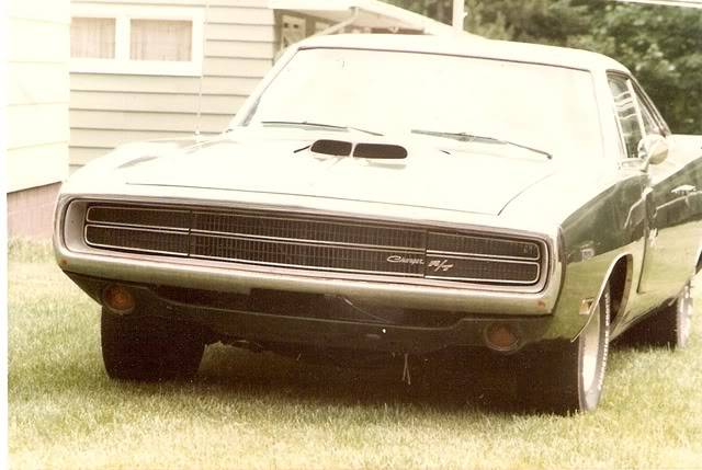

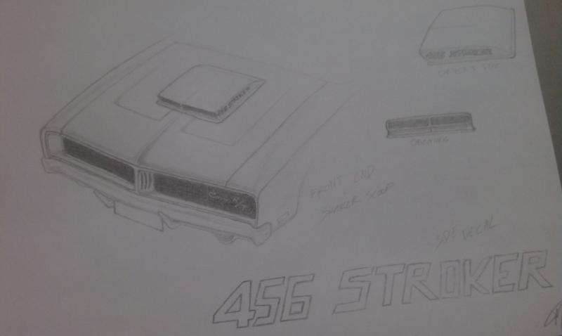

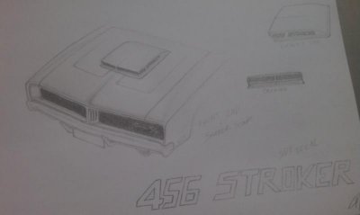

Here's what I drew up for a scoop, basically like I was saying a 6 pack scoop but with the opening having that forward angle and pointed just slightly. Also put a split in the opening like the 6 pack to sort of mimic the split in the grille, and a slight slope down all the way around the base where it meets the hood. I was in a hurry and just sketched this stuff out but the "456 stroker" decal down the side was supposed to be the same font as the "440 magnum" hood emblem on a '70 challenger. Hope this helps

I hear where you are coming from. I guess I'm just not used to seeing scoops on Chargers. I will say that the last pic Speedy posted of the black car looks pretty cool.
Yeah it's a bummer his hood wasn't useable but if I had to put a scoop on one I'd go with that. The black '68 is from those Blade movies, looks pretty good and I bet it'd look better as a shaker since it'd be a couple inches lower

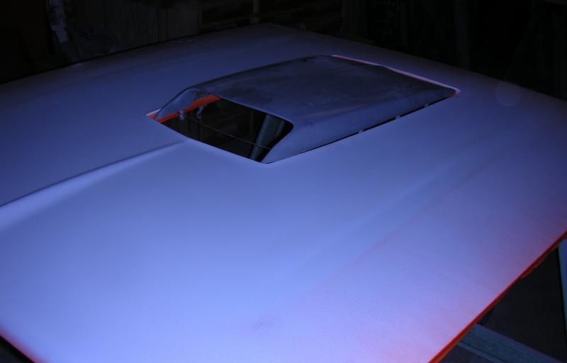

Sweet drawing, I really like that. I was dead set on the mach scoop (modified to not look like one) so now I'm in a little fix with the hole already being there. The good news is that I cut the hole with the intensions of making my own scoop meaning it was made the way I wanted it and not just for the mach scoop. Having said that I'll look at it tonight and maybe draw it to scale so I can see what I have to work with. If I end up doing more surgery on the hood I'll have to invite Captain Morgon over for support (man was that hood a #$&^% to weld and not warp). As far as rim width goes, it seems that 9.5 is the standard for most companies unless they are customs (you either pay less and settle for less or get out the check book).

If I can throw in my 2cents. To me any hood scoop doesn't look right on a Charger. They do look good with a smoothed out hood as seen in the above pictures. I really like speeds scoop with one exception. The center support needs to have the same ridges as the grill then smooth out the hood.

I think a memory refresher is in order haha, as you can see the hood is already smoothed and yeah Speadies drawing looks pretty sweet. The problem is getting it to work with what I got "this is what happens when you decide to change your mind":BangHead:DSCN6505.jpg Page one has more pics.
I think a memory refresher is in order haha, as you can see the hood is already smoothed and yeah Speadies drawing looks pretty sweet. The problem is getting it to work with what I got "this is what happens when you decide to change your mind":BangHead:View attachment 135998 Page one has more pics.
Hey whacha know! Your hood is already smoothed. Glad you took my advice. LOL I still like the one in the pic you just posted.

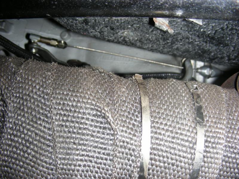

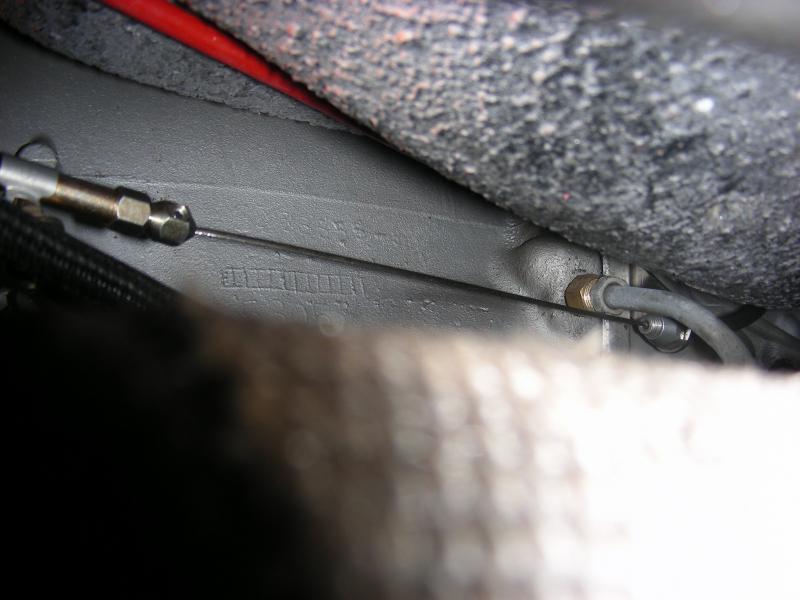

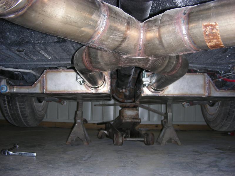

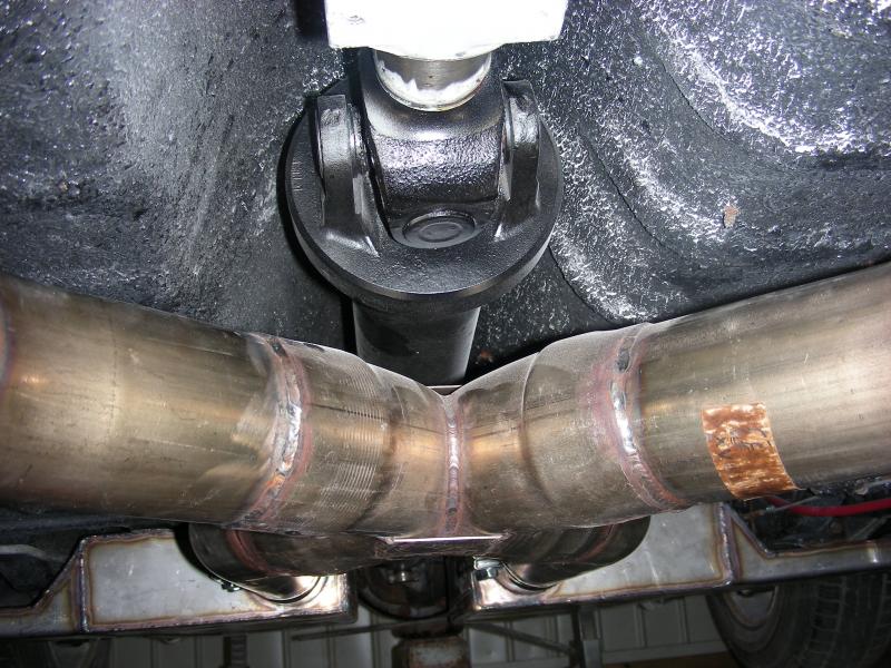

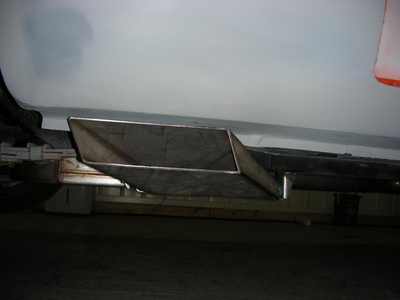

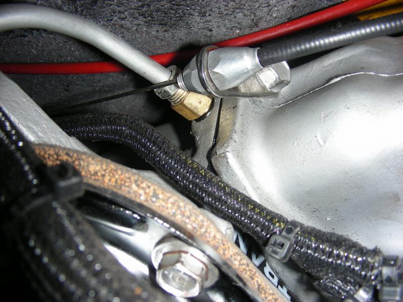

DSCN8339 - Copy.jpgDSCN8340 - Copy.jpgDSCN8344 - Copy.jpgDSCN8345.jpgDSCN8346 - Copy.jpgDSCN8348 - Copy.jpgDSCN8352 - Copy.jpgLast night I finished the exhaust, installed a Lokar kickdown cable, fixed my fuel gauge issue and a few other things. The Lokar kit leaves a little to be desired in the fitment department, Look closely at the pic of they're instructions you'll see the tranny coolant line directly behind the cable "uh oh, I kinda need that coolant line". If you go over it your against the floor and under (what I did) reguires tweaking the bracket, other than that it's a pretty sweet setup.

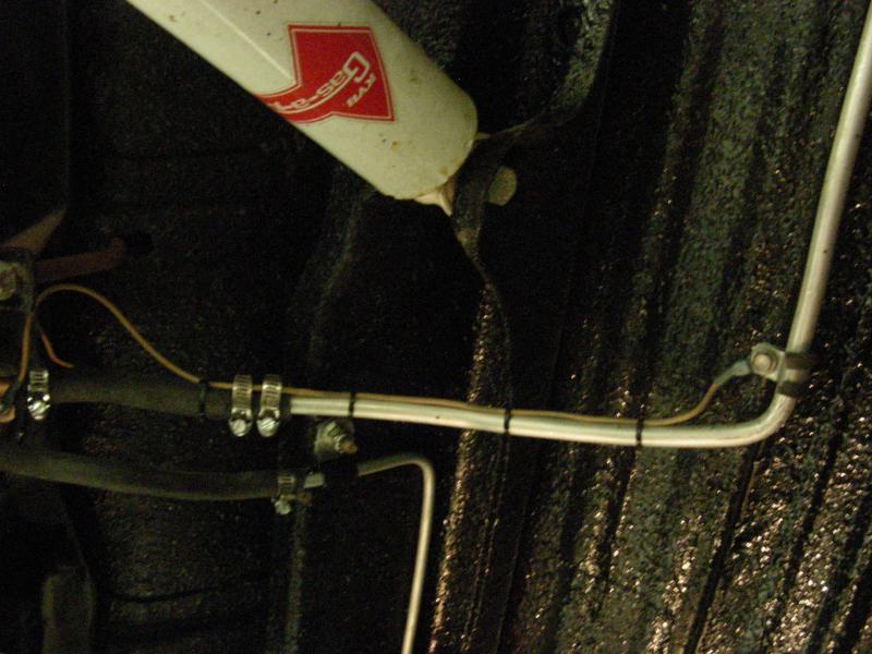

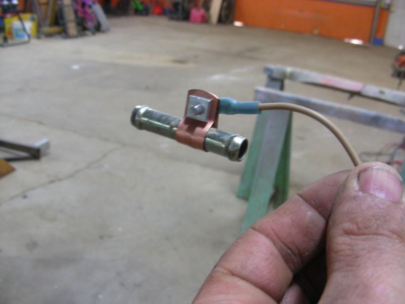

The issue with the fuel gauge was just the ground, my car is spayed with bed liner and the fuel line is mounted with rubber coated stainless clamps making it a piss poor ground. After a little head scratching I just made a copper clamp for the 3/8" pipe coming out of the sending unit (where the standard strap would be) and fastened it to a ground "problem solved". DSCN8373.jpgDSCN8370.jpg

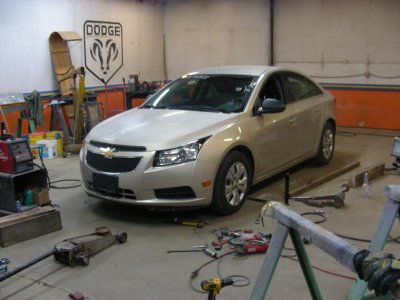

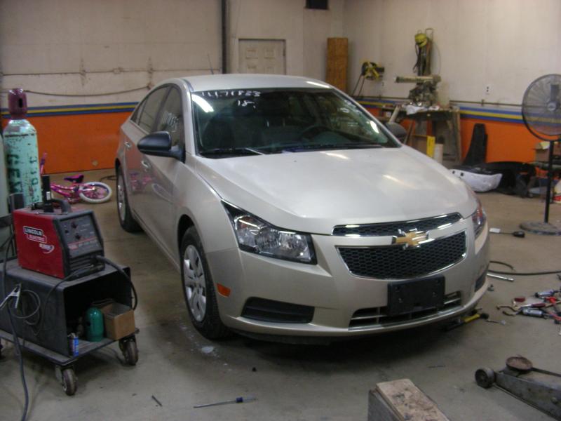

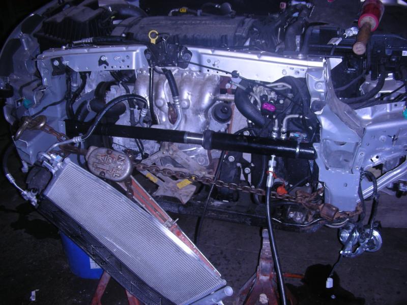

I don't know what got into me tonight, I didn't touch the Charger instead I decided to finish the Cruze. I was supposed to be getting it into the shop for them to pull the upper rail down but found a way to do it myself so other than touching up the hood and a little buffing IT'S DONE, BYE BYE. What a pain in the @$$, with all of the pieces, headlights, fenders, hood, bumper etc being such tight fits it doesn't leave much room for error but it went together pretty well. Many hours of porta powering, come alonging, beating and beating and beating here it is. I'm pretty happy, we tried to get a used one but couldn't find one under $16,000 "Ridiculous" (they're only $19,000 brand new) so we have a Cruze with 3,400 miles on it for 8,000. I threw in a pic of my dog "Sayde" seing how she never gets in them and Budnik seems to love dogs "she's a sweat heart".DSCN8147.jpgDSCN8368.jpgDSCN8369.jpgDSCN8365.jpg
Thanks CDR. Sorry no video yet, I actually made one today only to find it didn't record "I'll figure it out".

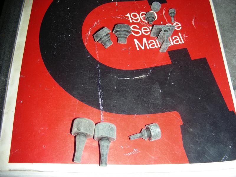

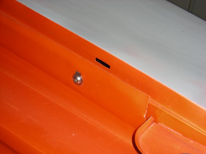

Can someone tell me where these bumpers go, I have the hood, doors and trunk lid bumpers in but can't figure out where these go.DSCN8393.jpg

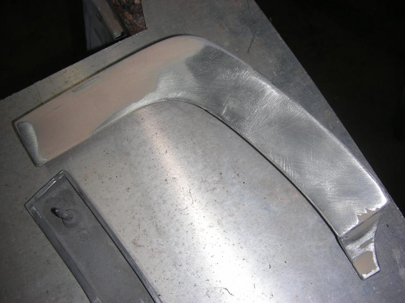

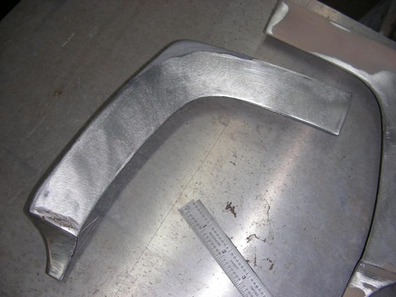

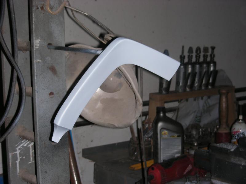

Well back to the body work "yey", evidently the AMD Quarters have a sharper bend at the quarter extension area meaning the extensions needed a little work. I built the corners up with All Metal, filed the rest to get a good fit and then filled the dent in one. I also blocked out my front valence "again", my boy decided to help one day and took 40 grit to it. Also finished the last few tweaks to the bumpers, I'll be dropping them off for blasting tomorrow and then finishing them "boy I'm glad I decided to paint them". DSCN8402.jpgDSCN8391.jpgDSCN8390.jpgDSCN8389.jpgDSCN8403.jpg

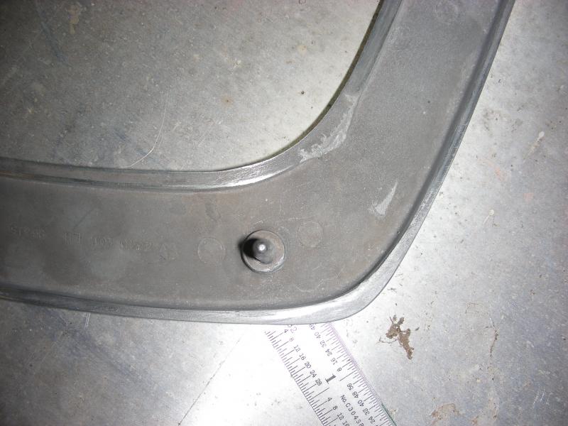

This inner fender is junk, it came from ABS and took a great deal of BFH work to get to fit then allot of body work to make look respectable only to find out now that the lip is so high that you can't install the hood bumper. Should have checked it but never thought it would be this far off.DSCN8396.jpg

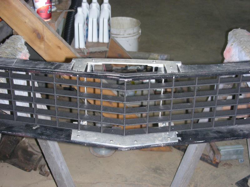

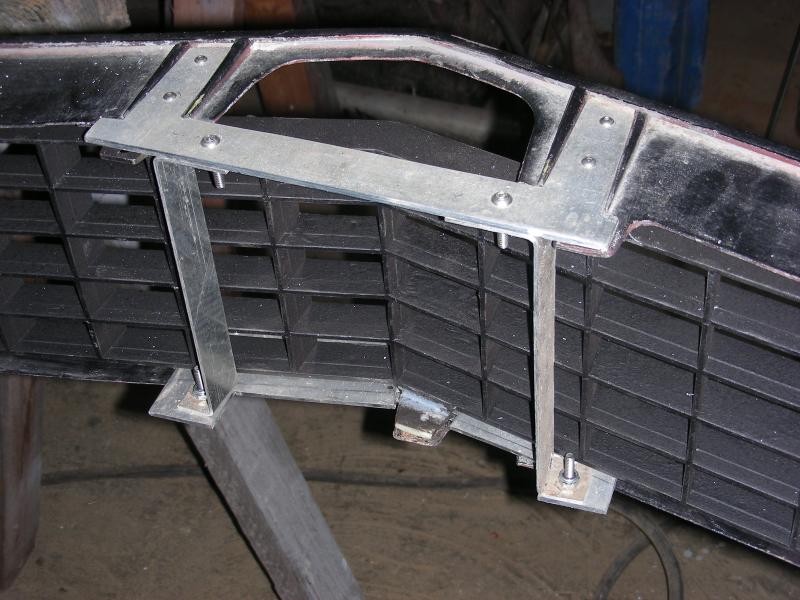

Be glad our grills are plastic, I'm fixing a grill for 1970 Torino that is pot metal "not allot of options". All of the center brackets are broke "missing" and the lower part is cracked in half. The vertical pieces of aluminum on the inside of the grill are actually needed for bolting it in. I'm hoping the reinforcement plate on the bottom will appear to be just a thicker portion when done "not many ways to go about it" and I wanted to hide the crack somehow. Another down payment on the upohlstrey.DSCN8399.jpgDSCN8400.jpg
Excellent work on the extensions. Bummer on the inner fender. Yeah, not a lot of options on the pot metal unless you can use JB Weld.
that totally sucks, about that inner fender panel... trim the hood bumper on the bottom side to fit, if need be... sorry that's probably the obvious fix...
Thanks BigBlock, "I think I got it now" haha. I posted it elsewhere and was told they are for the glove box and center console lid, that only accounts for a few. I wonder if it's one of those kits that covers multiple applications "I'll find out when it rattles".

That was my first thought but it would likely result in cutting it in half seeing how it's hollow. I'll figure something out, I'll trim the metal and touch it up if I have to.

on the back of the front fenders at the top for the hood to set on.right next to the studs
Got those two on and all the other hood bumpers. I can't think of any others, 2 on the trunk, 4 on doors and 8 on the hood, that's what I have so far. What's that weird T shaped one for? Hate basket cases but then again that's the only way I can afford one LOL. Thanks
