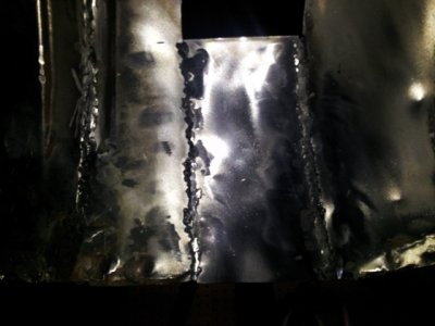

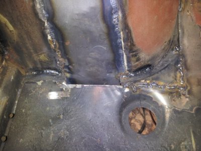

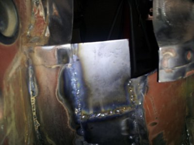

Got more gas, and got back in the shop to continue the work on the wheel wells . . . Here's what I've got done:

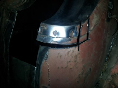

The last remaining hole that needs to be filled

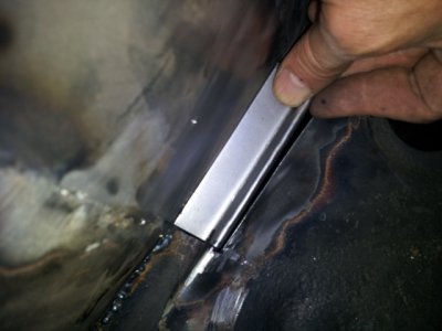

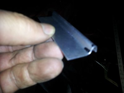

The shape of the replacement part fabricated . . .
Then the test fitment . . .
Tacked into place - looks like it might work . . .

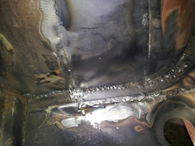

welded and initial grinding - got to get it cleaned up a bit more and it should be completed.
Now to finish filling in the rest of the gap over the rest of the wheel well . . .

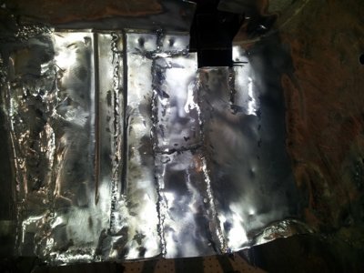

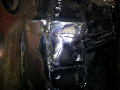

Bsck working at the mini-tubs . . . Here's what I've gotten done . . .

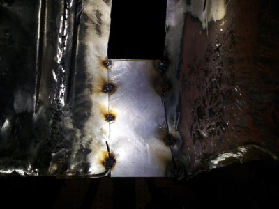

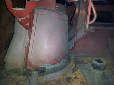

First - the next section to attack, back inside part of the mini tubs . . .
New metal tacked into place . . .
completely welded in place . . .
Second piece also installed above the first piece - making good progress . . .

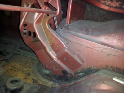

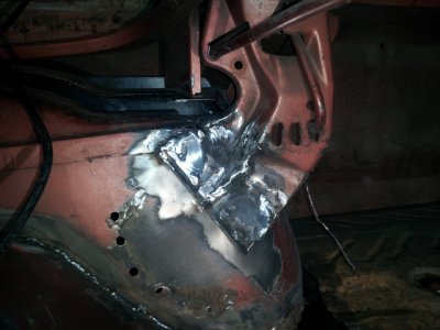

Trunk hinge support jig-saw puzzle solved . . .
Couple of months ago I cut off the trunk hinge support from the inner wheel well and "guessed" at just "how" the thing was going to move and get put back together when the mini tubs were completed . . . wasn't sure just how difficult is was going to be . . .

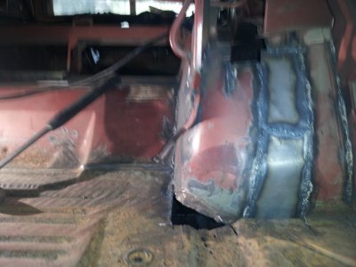

My guess was pretty close, and now my passenger side trunk hinge support is back in place on the car:
For comparison - here's the driver side and it's original attachments (left) . . . new mini tubs ( right)
Another view of the drive side (left) . . . and the new mini tubs ( right )
Still got the holes from the trunk to the wheel well to get filled in . . . but it's getting there . . .

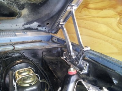

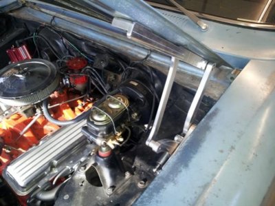

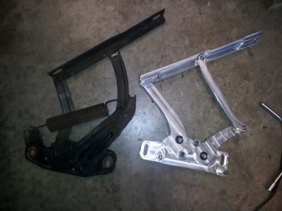

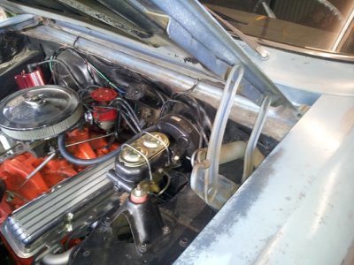

Finally got started on replacing the original hood hinges on the Belvedere this morning - and as I suspected, I'm going to have a "whole lotta fun" with the re-alignment of the hood with the new hinges in place.
But, as a little teaser, here's what's going on now . . .
The original stamped steel hood hinges on the car . . .
Comparison - side by side of the old and the new hinges . . .
The new hood hinge replaced on the car ( still working on the alignment )
Another view of the new hood hinges on the car . . .
Not too sure how much "fun" I'm going to have with the alignment of this things yet . . . Oh boy . . .

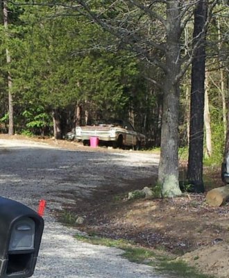

Just about every day I go to work and home from work ( depending on the route that I take ) I may see these (2) old cars sitting in people's backyards and rotting away . . . I'm no expert form this far away, I can't tell what they are, or what kind of shape they're in . . . but I just hate so see them sitting . . .
Here's the pics . . . the first old car . . .

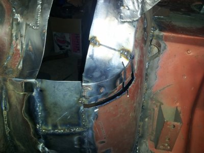

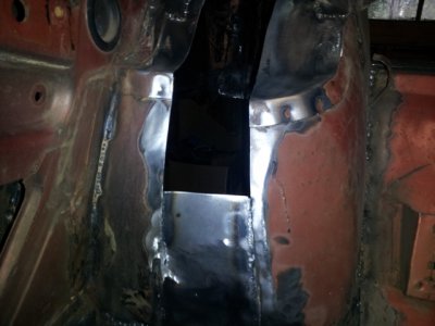

Fixing up a mess up . . .

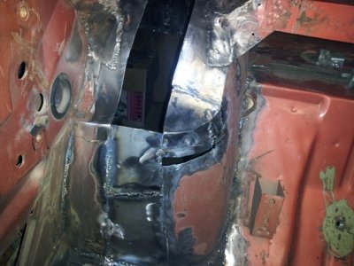

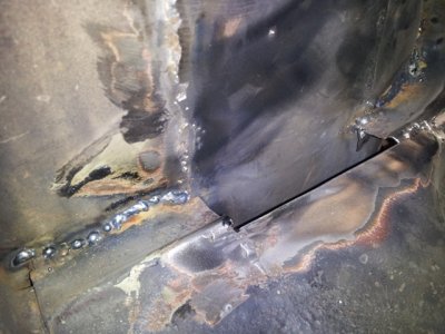

When aligning the inner wheel well when reattaching it to the frame rail, I lined up as many of the markers as I could, and thought that I had done a pretty good job of getting everything squared away pretty well for the mini tubs . . . well, all but one little area inside the car . . .
You'll see by the levels of the two pieces that I'm off by a good 3/4 of an inch or more . . .
so I made a guess at a couple rough cuts to assist me re-aligning the tops of these two pieces . . .
welded in the missing piece in the fender well between these two parts . . .

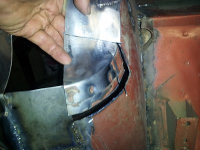

But my guess was not enough to solve the misalignment - so the piece had to be cut off, a pie slice removed, and re-attached . . .
Cut and tacked the remaining parts back in to their places . . .
Some additional welding and a little grinding to see how everything was going to look - and I think this is going to make it all work.
Couple more pieces of metal welded in the gap between outer and inner - and I'll have this mini tub wrapped up once and for all ! ! !

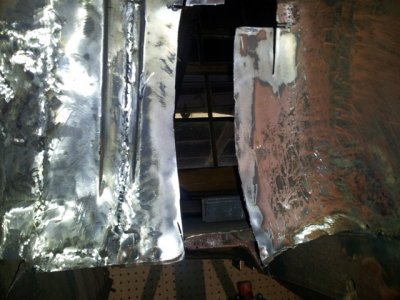

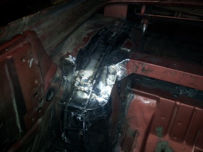

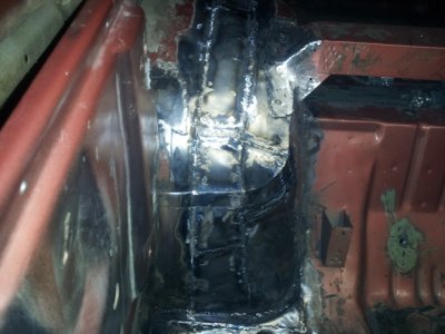

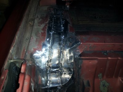

Mini Tub on passenger side almost done . . . more progress . . .
Got the complete gap in the mini tub welded in place tonight . . . just got the trunk connections to complete now ! !

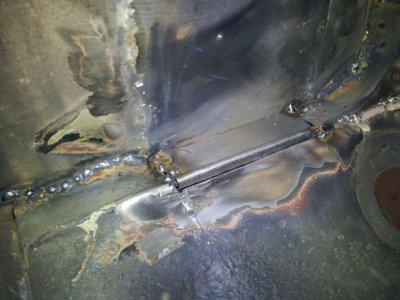

Here's what it's looking like . . . got the front seam redone . . .
got the full gap filled in - need to go back and look for pin holes . . .
Another pic . . .
And yet another pic . . .
