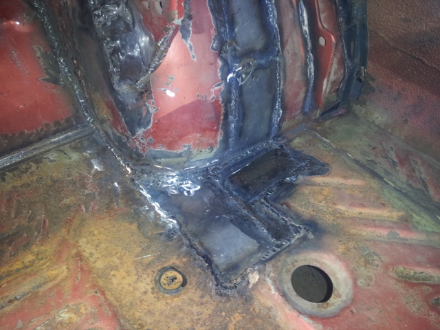

Passenger mini tub has been completed . . .
One more trip to the shop tonight - with the plan to get the trunk area of the wheel wells completed - and the mini tub DONE !

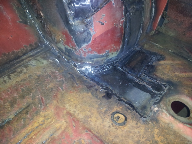

Here's the progress . . . the last of the trunk area finished . . .
And yet another view of the same area . . .
Thought I was done . . . then I placed a light under the car to look at my welds . . .
Unlike Propwash that can see Orions Belt in his Dart Top . . .
I can see the whole Milky Way ! ! ! ( SIGH ) . .

The wheel wells are coming along nicely Kahn. I sure wouldn't have guessed you were a white collar computer geek lol. You are doing a great job. Everyone of us has gotten a$$ deep into our projects and then realized we didn't know what the heck we were doing. At that point you just have to sit back, relax, do a little homework and talk to the great guys on this site for opinions and advice. Like I said before, I would never been able to get through the Resurrection without B-Bodies only.
I found a trick that works for me is to get the light under there and take a magic marker and make a black mark next to all of the spots you see light. That way when you bring your light back up top to see what you are doing you already know where the holes are. But don't fret....we all missed 100's of holes as we did our welding. (remember my oil pan and how I ended up buying one because I couldn't stop the leaks!)
So not an error in your technique...just standard run of the mill issues we all experience.
