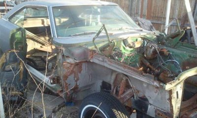

HI I am starting a build with a 69 charger. I got a 2007 charger donor car with a 5.7 hemi. I will be posting progress of my build and any comments, help and suggestion would greatly help.

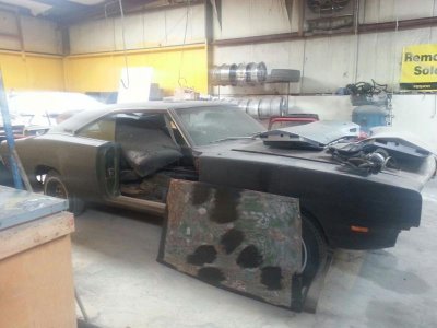

Here is the 69 charger begging for restoration at my shop.

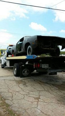

pics of when I picked it up a couple months ago form the tow truck. it in rough shape need new floor plans and so on. Ground up Build.

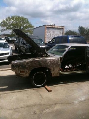

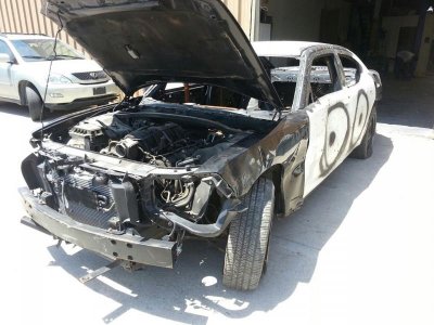

Here is the donor car a 2007 dodge challenger hemi 5.7 cop car. Kinda rough lol but the engine is good with no bullets holes.
I had my guys pull the engine out and get all the wiring and gas tanks, ecu and so on. I figure this will be like the 69 camaro rs build that I dropped a ls1 in and built from the ground up you can check out that build at http://www.camaros.net/forums/showthread.php?t=219839 or just google rim spec 69 camaro. We do body work | paint and rim repair.

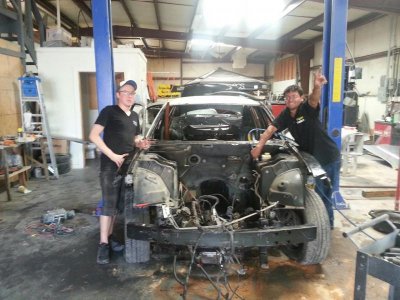

Here some pics took us about 6 hrs to pull the engine out and electronics

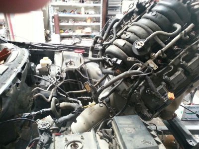

Starting to pull out the harness and electrical

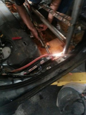

This car had a roll cage so we had to take it out to get access to the wires.
