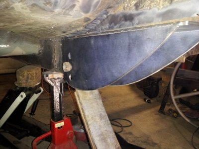

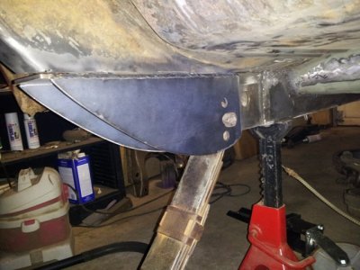

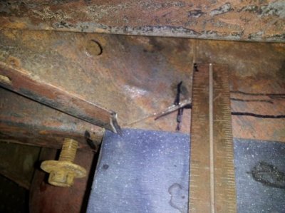

Spent the night working on the level and squareness of the brackets . . .
Dropped a plumb bob from the bottom hole in the bracket to the ground, and from the stop hole on the front suspension.
( will test with the strut rod holes tomorrow - after I clean the grease out of them )
Measured diagonally across to the points and the measurement was dead on - GREAT NEWS ! !

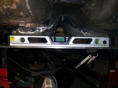

Had level yesterday with a square tube in the bottom holes of the bracket last night ( BUT ) the tub would not go through the outside DR hole . . . NOT GOOD.
If I run the tube, passenger side to driver side - it lines up pretty well with the hole on the driver side . . .
BUT - if I run the tube through the driver side, the tube is UNDER the passenger side ( so my driver bracket is high left, low right )
FOUND where it was hitting and not allowing movement up on the inside edge . . . removed bracket - ground down bad area . . . good to go . . .
NOW I can get the square tube to pass through all 4 holes in the brackets . . . YEAH . . . but the level show 3 degrees low on passenger side . . .
Trying to work through the details and figure out how to make it all "RIGHT" . . . I'll get there . . . no welding done yet . . .
