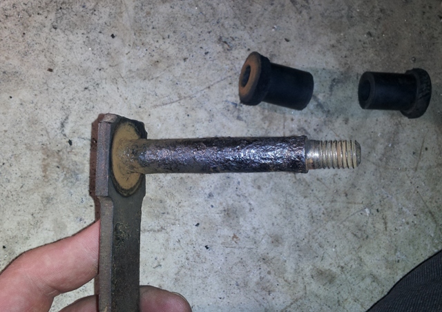

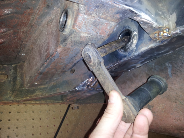

Well, Herr_Poopschitz made an observation while I was working on these brackets - he was right . . .
Sometimes you "don't" quite work out all the kinks in your plans . . .
I need to replace these shackles anyways . . . they don't look "too bad" . . . do they ? ?
I've seen shackles that have the bolts separate from the brackets and not welded together like my bracket - then I can install the top bolt through the original hole.
I'm looking for the shackles that have the bolts separate - 747 Mopar told me Just Suspension, but their pictures don't show if they are - I'll call them.

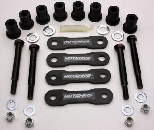

AHA ! ! ! This is what I'm looking for . . .
Found these on the web this morning - I think this is just what I'm looking for ! !
And being Hotchkis . . . I think they ought to work just fine . . . will be calling them tomorrow ( maybe pick them up in Moresville ? ?)

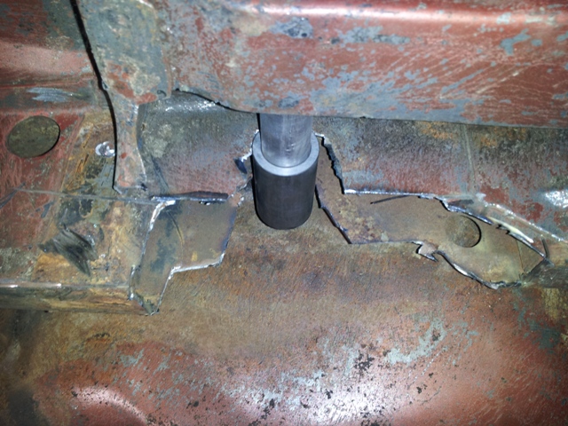

Time to move to the drivers side ans start this mess all over again . . .
It's time . . . time to move over to the driver side and get the fabrication work done over there . . .

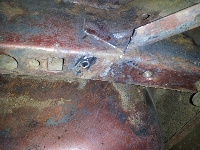

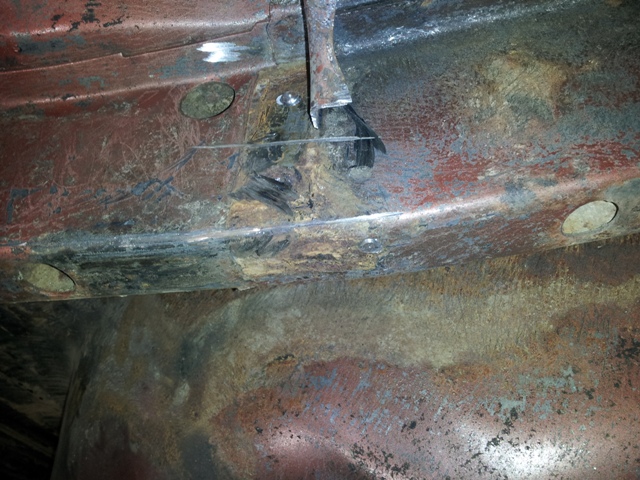

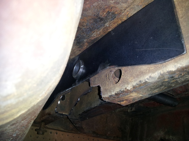

First . . . the tearing apart phase . . . phase 1 . . . here we go . . . rear bracket cut out . . .
Then the front bracket needs to be cut and removed . . .
Now I'm trying to get my alignment tool in the original bushing tube, but it has a ridge in it - gotta get it ground down a bit first . . . then get the alignment drawn on the new frame and start cutting out all the un-needed metal . . . ( smile ) . . . having a blast !

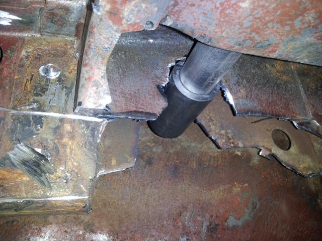

I've got the sickness . . . back in the shop tonight . . .
More work on the Belvedere because I'd like to wrap up the frame modifications and get these leaf spring hangers all installed so I can re-install my leafs ! !

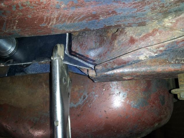

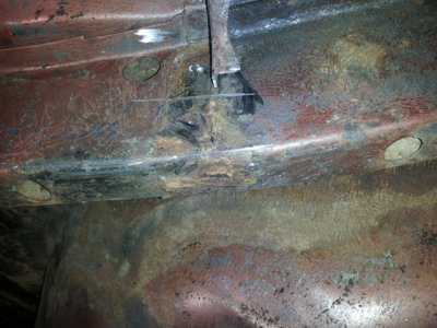

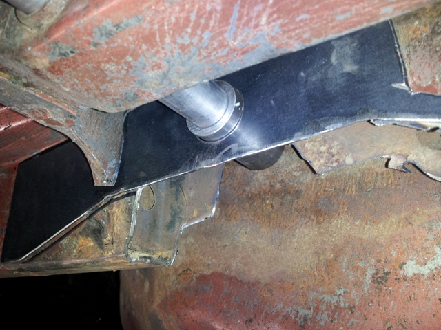

So, back in the shop working on the driver side - and I've got the frame cut so the new sleeve will sit in place ! !
There is not a lot of room to get a 4 1/2 " angle grinder up in here with a cut off wheel . . . so it's a WHOLE lotta fun removing metal . . .
Now to get the new metal plates in place, mark what has to come out, and do some more cutting ! ! ! Whooohoooo . . .
Betcha the arms are burning from all the grinding? Looks like you need a little cut off wheel mounted on a 90 degree die grinder to get that job done "glad the Chargers didn't have that spare tire well". Little by little

Got a question on these leaf spring shackles:
The shackles on my car are 3 1/2" center to center on the bolts - but these by Hotchkis are 4" on center . . . that'll raise the back of my car ( how much ) ? ?
I know - you can make them . . . but they really look nice . . . BTW, they don't sell parts at the Hotchkis East store that is near my house ! ! BUMMER ! !

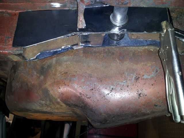

Going back together on the Driver side . . .
The driver side sure seems to be going a little quicker then the passenger side . . .
Got the fitment of the outside plate close to being right . . . already . . .
so far . . . so good . . . I'll keep at it . . .
Another step closer . . .
Got out in the shop tonight and was able to get the inside plate modified and just about ready to get installed - still a little "finessing" left to do . . .
The inside plate has been modified and it's fitting in nicely ( you can see the original frame that still needs to be cut out )
Got this section around the attaching bumper frame fitting nicely too . . .
Here's all the pieces in place - and you can see that there still is a little clean up left to do before welding . . .
Also, the dirt-dawbers ( mud-wasps ) decided that they wanted to build a Bellagio Hotel in the frame - the down side of that is all the sand that falls out while I'm cutting is added into the mix of metal shavings and i'm HEAD to TOE filthy working on this job . . . But it's getting done !
And "getting done" good, Thats some great fab work your doing there! You sure have come a long way with this stuff, pretty cool work and skills man! Thanks for posting it...
That looks much better now that it's all cleaned up and fitted, very nice
hey kahn i got those leaf spring shackles by HOTCHKIS they are nice, i used them with the HOTCHKIS lowering leaf springs. they said it would lower it 1 inch. more like 2 inches. if you would want more you would have to add a block to slam it even more. all your work is looking good. nice job.
usaroadrunner, Thanks for leaving that! Im going to need a set and wondered where to start and they do have a "cool" look to them! :)
