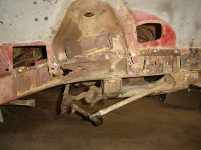

Well, here we go. What started as an alignment on my 72 GTX turned into an entire front end rebuild. Since I'm in not in a big hurry I slightly lifted the engine and removed the K member to clean it up. That's where the fun started. I broke out my wire wheel tonight to clean up the frame rails around the shock towers and found some serious rust. It appears that someone in the past had welded a patch on the inside of the rail but the rail is in pretty bad shape. Over the past hour or so and a couple of cold beers I removed enough dirt and rust chunks from the frame drain holes to fill a couple of quart jars. Before posting this I searched the prior post and found a link to autorust.com and they appear to have patch parts to fix this without totally replacing the rails. Does anyone have any experience with autorust? Please send me your thought and advice on the best way to fix this. It's a real numbers matching 1972 440 GTX and I'm working towards a very nice driver car and I don't have crazy dreams of building a TV auction lottery car.

rusty pictures

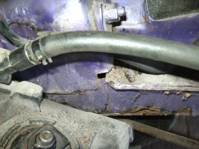

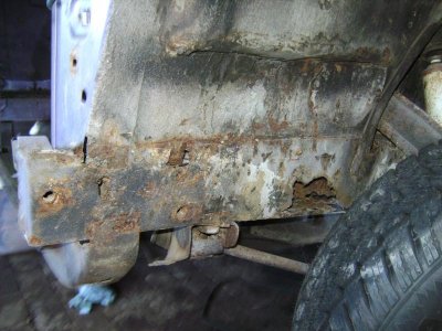

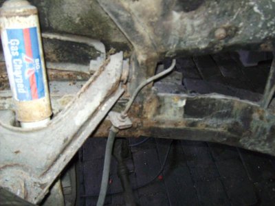

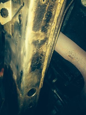

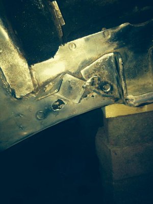

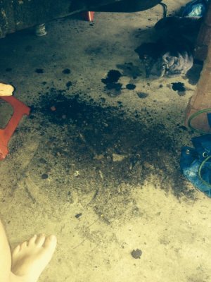

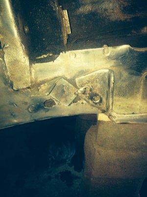

Here's some pictures of the frame rail rust and the pile or dirt and rusted metal that I pulled out of the drain hole
That is not truly that bad. I would drill the spot welds off the brake hose bracket and pull that off. then cut a recangular section out where the rust holes are - go about 2-4 inches past where you think the rust ends (trust me...you'll cut out more than you thought). Then weld in a new section in the hole. Do the same for the bottom of the rail (after you finish the side) and it will be nice and strong again. It looks like you had water sitting in that section and ate it away, if the rest of the rail feels and sounds solid there is no need to do open heart surgery and replace the whole thing. Whenever you open it up look inside and seal up what you can with paint.
May just be the pictures, but it looks like it already has had a patch welded down one side. Appears to be on the other side than the side pictured. Looks like you may need a rail. IMO
Matt
yes, there's an older patch on the inside or the rail with a big hole in front of it. Besides this one terrible area the rest or the rail appears to be solid. I've owned the car for about 7 weeks now and I'm finding good and bad. The guy I bought it from is being totally cool and he was not mechanically inclined and was being taken advantage of by a local show. he bought the car in 2006 on E Bay sight unseen and quickly realized he got screwed. My guess is the car sat for a while in a high rust area and someone picked it up, patched the bare minimums, bought a few gallons of bonds and applied their first ever paint job and sold it to the previous owner. I verified the VIN to the cowling stamp, the radiator support and I have the original broadcast sheet. I also verified it's the correct block casting numbers, intake and exhaust manifold casting numbers on the good running 440. From what I can tell it's a real numbers matching 1972 440 Roadrunner with a very nice all original interior, complete non working factory air and I paid $13,500.

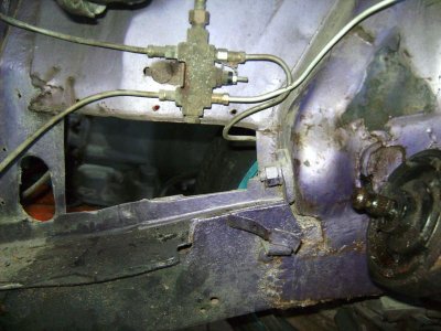

I have done a few of these rail replacements. It is a great deal of preparation. First thing is you need a square Dolly that is checked for level on three planes front back left to right right o left in front. You need a water level to seet up the car. These where built without the motor or drive train in the car so ridgid set up is a must. Tjhe auto rust product is simply a patch. Doing this right is painful but worth the time and effort. For the cost of a new rail from AMD, with shock tower a must you can only expect to take ito a frame shop once your done to get the final straightness. Do it right like donny and wash said.

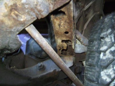

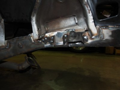

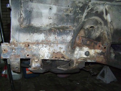

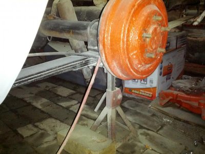

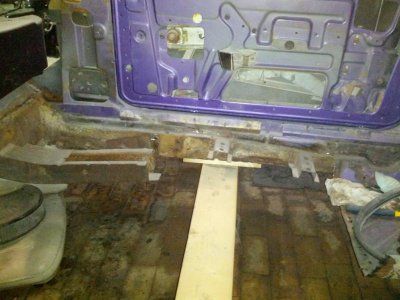

It's alot of work to change the rail. There wasn't anything holding the back of the k frame. A bunch of spot welds, welds on the shock tower, and it comes out. I have mine leveled with jack stands under the axle and a 2x6 under the rocker. Measure everything to see how square everything is, the fsm has the specs, but you need a few more before you start. I'll try to get some pics of mine. I got alittle overboard and am changing the torsion bar crossmember and front floor. The big concern I had was how thin it was. a 6 inch hole makes out wonder. After cutting mine out, even where the bumper bolts was thin. I wasn't taking the chance, safety first, do it right. I bought a new rail on Ebay. E body rail seems to fit perfect, most of the front sheet metal is the same as an e body. Hope this helps. Will try to upload pics later.

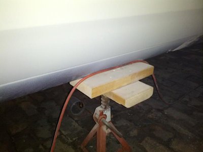

Here's how I cribbed it. I checked it with a level at the tail panel, cowl, and radiator support. Also checked front to back on the rocker.

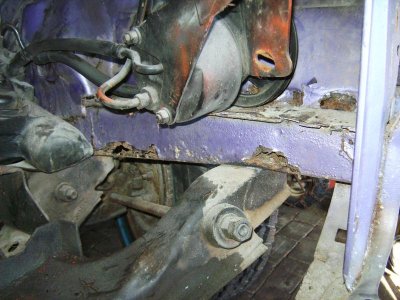

Here's what I started with.
Notice the Cheesy patch job done long before I owned it. Purely cosmetic.
You have to remember what all attaches to the rail, and it is a structural member under heavy load and torque. I wouldn't just patch it and drive it. My life and my family's lives are worth more than that.
