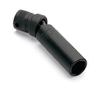

I am thinking about buying a Snap On spark plug ball swivel socket, is it worth the money?
Since you resurrected the thread anyway, I'll address the original question, YES, they are worth the money, I have both the 5/8 and 13/16 Snap On ball swivel plug sockets, worth their weight in gold, they prevent a lot of plug breakage in tight spots, better than Mac and the other ones, had mine for 16 years so far, wouldn't be without them.

For those wondering what that $59 USD Snap On socket looks like:
