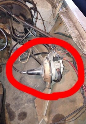

That's the part I think is for the lean burn

The circled part it the cruise control servo. Vapor canister is for hydrocarbon emissions. Nothing to do with lean burn
Lean burn is the ignition system. The computer mounts on the air cleaner and the distributor is specific to the system. The mopar electronic conversion kit has instructions for replacing leanburn and would probably be the most practical way to go about it in this instance.

The part you circled in red may be for the lean burn, I am not familiar with it.

And can I remove the cruise control mechanism if I want to? Help clean up the engine bay?
I'm 99% sure all the lean burn is all disconnected
You can disconnect it but you will see that the speedometer cable goes through it. You will need a different cable.
