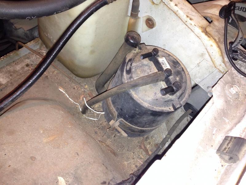

image.jpgHeres the vapor canister.. Also for the lean burn?
The circled part it the cruise control servo. Vapor canister is for hydrocarbon emissions. Nothing to do with lean burn

The vapor canister is not for lean burn. There are three connections on it. If I am not mistaken, one goes to a vacuum source, another goes to the carb and the third goes to the return line to the tank. If you clean up the canister they should be marked. Regardless, this helped avoid gas fumes going into the atmosphere, but it was not the lean burn system.
