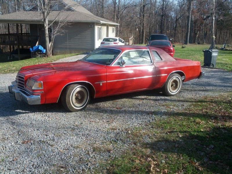

I remember you talking about that Magnum last year. I loved the look of those cars when new, and still do! Glad you got it running okay. I grabbed this from your folder...
It looks a lot better now. The aluminum covers on the wheels have been beadblasted and sealed. Paint has been buffed gently, and vinyl is cleaned. Interior got cleaned also. Got it running smooth as can be with the lean burn. Had a devil of a time with the ignition timing. EPA labels want 20 degrees BTC. Not even close. Maybe with the better gas of years ago, but not now. Not wanting to change it as it is one of the few in the area still running.
