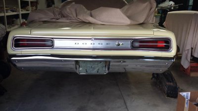

I'm glad I payed the extra to re-chrome my original parts instead of getting exchange parts. So nice to put parts on that fit properly!20130919_182140.jpg

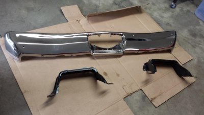

Even though this bumper had a pretty good dent in it Jon at Custom Chrome said no problem,and I'm very happy with the results.20140807_202310.jpg

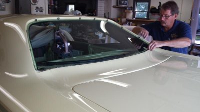

Here is a pic of my rear glass getting checked for fit before we glued it down for good last Friday. I like the color combo a lot better with the green glass.20140926_152943.jpg

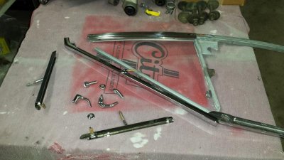

About the only thing I don't like working on is the glass and window mechanisms. Does anyone have a good recommendation on what to use between the vent window glass and the bottom channel for material ? Thought I remember it was about .030 thick.
I also would love to hear any hints on putting the vent window frame assembly back together. I ground the 3 cast rivets out to get it apart for re chrome. What luck has anyone had using something to peen the other 3 casting posts over the channel to lock it in ? This stuff was taken apart overa year ago and I can't remember if there was any sealer in between the two or not.20141005_184924.jpg

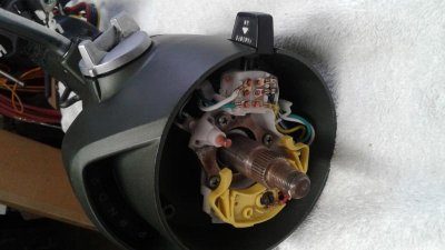

Made some progress everyone. Found out in this process that there's always 1 little part that will stop your progress, for a week or so at time. One headache I would like to pass along might not be a help to some of you experienced rebuilds but r a novice like myself it drove me crazy until I figured it out. While rebuilding my column I replaced the turn signal switch. When testing the dash I couldn't get the turn signals and hazards to work properly. If I disconnected either the hazards or turn signal flasher then one system or the other would work ! Drove me crazy and I couldn't find any thread on here with the same problem. I called Mega who supplied the switch but they said they hadn't heard of any problems with the switch and promptly sent me another for free. After trying the second switch with the same results I then grabbed a column from another 70 b body and compared the wiring. The switch problem came down to the wires installed backwards on the top and bottom of the Hazzard block part of the switch. Drilled the rivets out, swapped the wires, rerivet and amazingly it works properly !20151126_154430.jpg

Made some progress everyone. Found out in this process that there's always 1 little part that will stop your progress, for a week or so at time. One headache I would like to pass along might not be a help to some of you experienced rebuilds but r a novice like myself it drove me crazy until I figured it out. While rebuilding my column I replaced the turn signal switch. When testing the dash I couldn't get the turn signals and hazards to work properly. If I disconnected either the hazards or turn signal flasher then one system or the other would work ! Drove me crazy and I couldn't find any thread on here with the same problem. I called Mega who supplied the switch but they said they hadn't heard of any problems with the switch and promptly sent me another for free. After trying the second switch with the same results I then grabbed a column from another 70 b body and compared the wiring. The switch problem came down to the wires installed backwards on the top and bottom of the Hazzard block part of the switch. Drilled the rivets out, swapped the wires, rerivet and amazingly it works properly !View attachment 294403
WOW!! I wonder if that's what my problem is...i have the same one in a '71 GTX. i have an intermittent hazard flashing crazy issue after i let off the brakes, and there isn't even a relay on the hazard circuit!!
what should the color order be??

As your looking at the hazard block with the on-off knob to the right, the orientation is as follows. Top left-green wire. After rotating the left to center post connector over so that it connects the middle to right post, the white wire will attach at that top right spot then. Yellow wire at bottom left, blue in center and white w/green tracer at bottom left.
Hope this could help someone. Very aggravating to be told by a supplier that they have never heard of a problem. Just hard to believe that nobody ever calls in with a problem.
