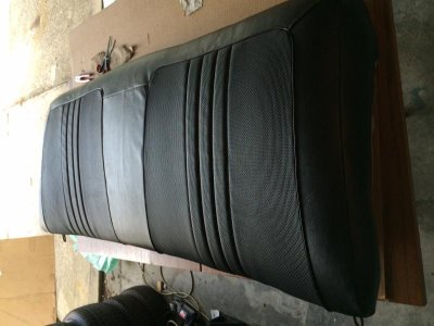

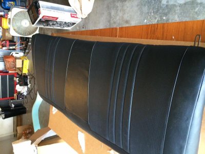

OK... I found the only store in the greater Tampa Bay area that carries Hog Rings... a CarQuest 30 miles away had 400 of them. I bought 100....at the end of the job I had 1 left! All total I think I used 199 to do the job.
I just put the seats in the car and they look great! Only thing I would do different is the padding across the top of the upper seat is a little lumpy. I may try to massage it out, but all-in-all I'm very happy. I'll post pics of them installed later today.

Nice job! I have to recover my seats as well, although I realized that I do not have the padding that I need. It costs around $175 per seat (bench front and back). Ouch!!!

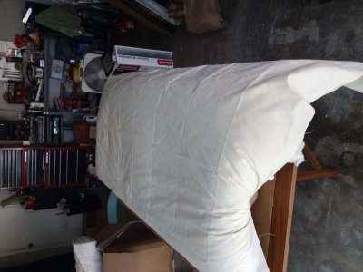

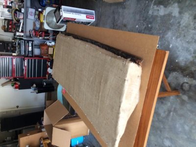

Hawk, for the rear seats, you could probably buy all the stuff for half that from a local upholstery supply shop. There is nothing special about what comes in the kit (although I did pay the $175 myself)
Burlap, muslin, cotton, hd foam and some listing wire. I haven't tried to price it individually but I have a hard time believing that those items would run over $90.
Ok I take it back, I just priced from a local shops website and it came out to $140. Although you would get enough burlap and muslin to do both front and rear for that price... Might be able to do front and back for $210ish? Better than $350. It was good having the kit the first time out, but I would buy from upholstery shop if/when doing it again now that I see there is really nothing magical in the kit (I hate when there is nothing magical in the kit).

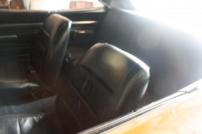

I hope you can work out the lumps, To look at it,,, it looks comfortable and the design or lay out of the material looks good, and i love black interior i want black with white accents when i get that far, but i just may go all black, i love it in my 73!!!

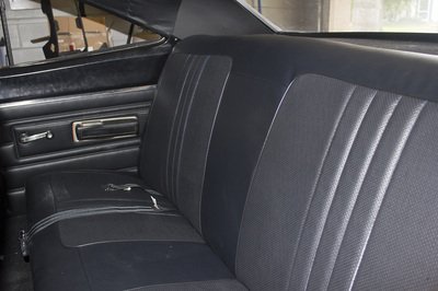

Here's a finished shot I took from my website... the pic is a little small, I'll replace it with a better one later tonight.
looks pretty good considering who did it.......:poke::laughing6:
Thanks guys, I like how they came out.
