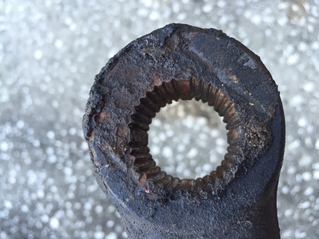

Currently trying to figure out why my new PST Pitman arm is not going on all the way... I put this on last year and didn't realize until recently that the drag link is not level.. looks like the pitman arm isn't fully engaged onto the splines of the steering box.
Took a look today at the old one pitman and it looks like it's tapered... in fact I know it is. Is this how they all are? I'm thinking that maybe I have a steering box off of a different car because PST says they sent me the correct pitman for a 69 RR... Anyone have thoughts on this?

Here's a pic of my old pitman arm.. I don't recall seeing 4 indexing keys on the new one when I put it on, but the steering box must have had 4 keyways, otherwise this wouldn't have fit on it.
Anyone know what's right for the 69 RR? this is a head scratcher as to why I can't get it to seat fully.
I'll get under the car today and remove the new one and compare.. maybe the splines are just gummed up.

I also just got a new pitman arm and it isn't tapered (69 GTX) putting a Borgsen box on this weekend so I'll see how mine mates up and get back to you.
BTW mine did have the indexing spots

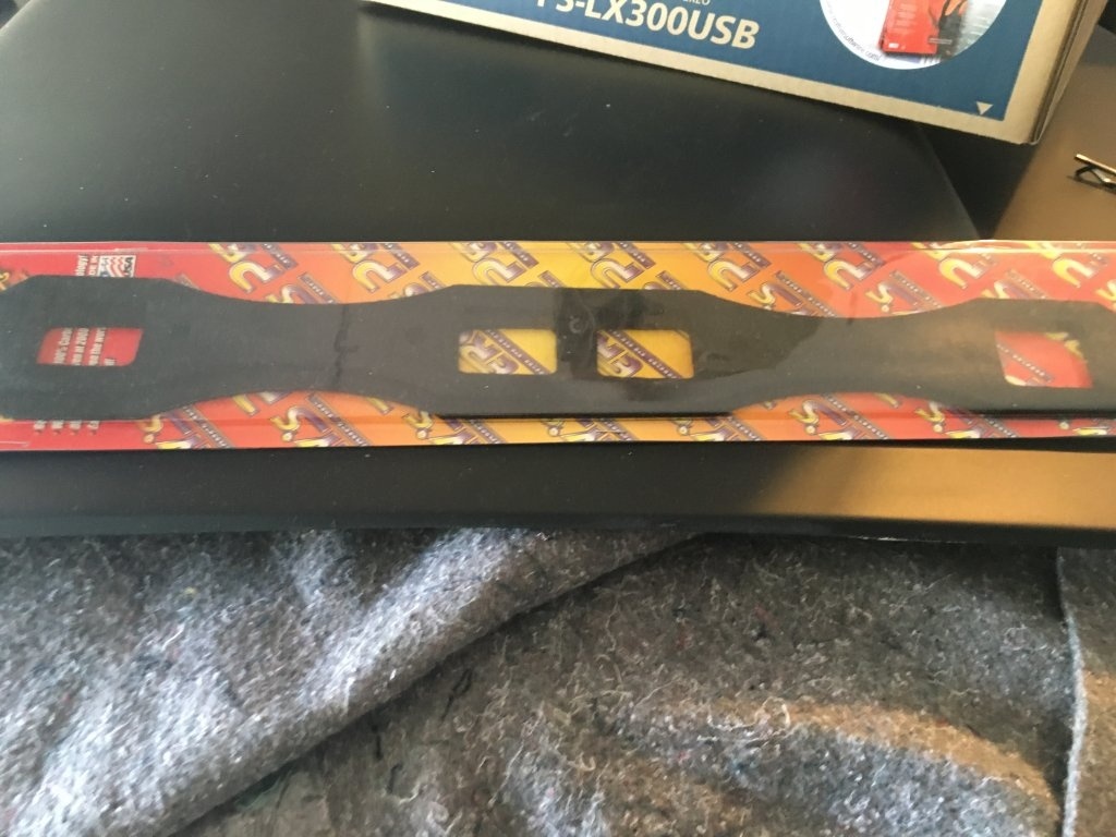

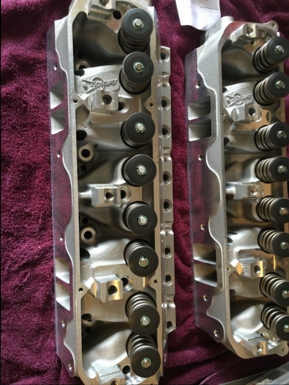

I will post a more organized list of the build, but I am tired and I know that I can't leave a post without shinny objects to keep your attention :) So for the moment here is some of the parts being used in shiny graphical format.

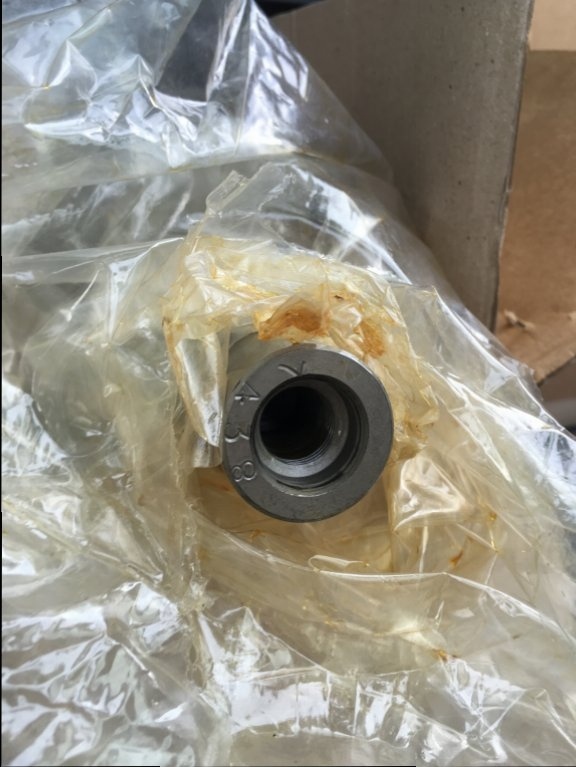

440 Source Stroker kit, Stealth Heads, ect.. (the box with the grease stain on the end is from the crank. It clearly saw some abuse and I was woried that it was tweeaked. but the shop gave a full checkup when it came in and again during balancing and all was good.
