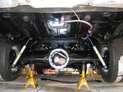

I like my weight in as close to the center of the car as possible so....I removed the tire well and will make a flat floor and place the cell under the car and as close to the rear end as possible. Think of the 'bar bell' effect. The closer the weight is to the center of the bar, the faster you can twist it back and forth or around and around. The same thing works with the car too. Even if you are not planning on building a race car, weight out near the bumpers affect the way a street car handles too.

16 gallon RCI fuel cell in my tire carrier. Removing the original tank frees up alot of space.

There is already a plug in bottom of spare well. I would put pump in the tank before running fitting out trunk floor. 26" dia. X 8" deep should fit in well. 18 gal.. Modify existing fill and vent tube to fill tank from top.

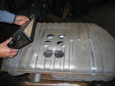

Like this. Fab up a single wall tank, weld a sump kinda like this, then cut the floor so. Peaks out. Then weld in a lid over the tank to make it flush to trunk floor and vent the space between tank and lid. That way you incorporate all of the features you were looking for but maybe a bit more effective of an end product.

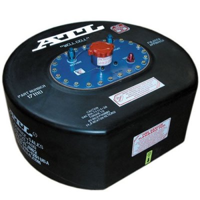

Of course, someone already makes a tire well fuel cell...
