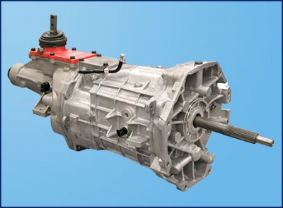

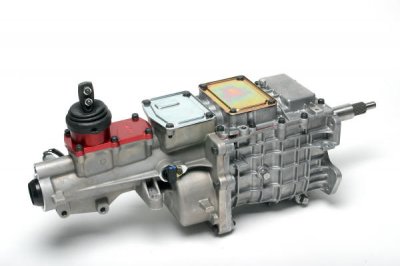

too easy didnt know of the difference, thought they were all similiar sized.
Tko 600
t56
