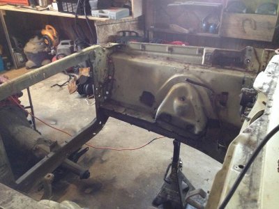

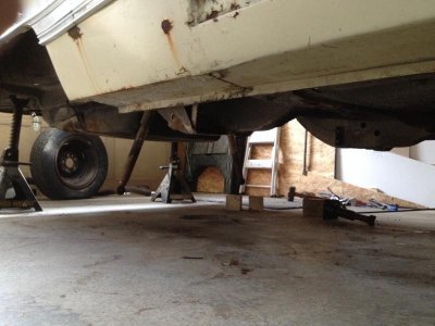

IMG_0839.jpgIMG_0838.jpgIMG_0837.jpgIMG_0835.jpgIMG_0834.jpgView attachment 226104The plan is to gather the parts for mods that I want over the winter while i'm blasting and sanding so I can get it primed and painted in the early summer. I hope to be driving it by the fall. The rub is that i'm going through medical permanent disability retirement from the Army and the VA disability treadmill, plus social stupity, etc. so my finances are not optimal just now. Trying to trade for stuff. Hanging in there and working it a little at a time,.gotta pull the gas tank and some lines then I can blast away. I agree, the 67's are really sweet looking in the smooth lines and proportions. Proud to own it.

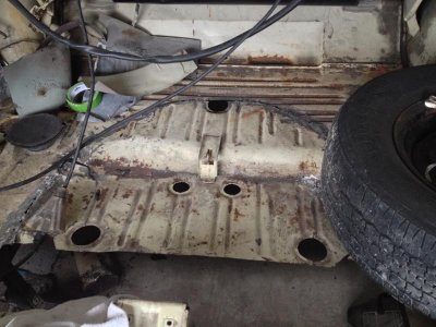

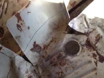

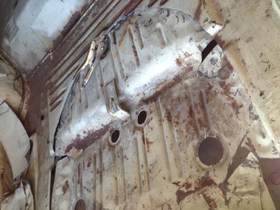

Thanks! Yes it does only have a few minor issues. There is very little serious rust, only the front half of the passenger floor pan. There is a dent filled with BONDO on the right top cowl corner but that's all. the rest is surface stuff. The usual areas seem to be ok. I hope to get out there and cut the floor pan loose this week. I have a sheet of 18 gauge in the garage and will fab up a piece to put back. Or, I intend to cut the spare tire well out and flatten the trunk floor, might reuse that piece for the more structural floor and fab a chunk to go in the trunk. Hmmm that rhymes.

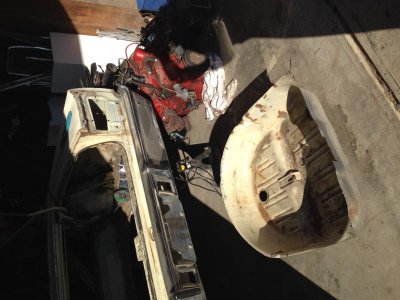

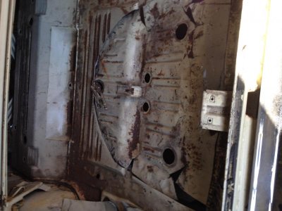

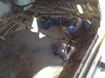

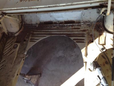

Got some done today:IMG_0142.jpgIMG_0135.jpgIMG_0145.jpgIMG_0136.jpgIMG_0133.jpgIMG_0140.jpgIMG_0134.jpgI had said that I wanted to flatten out the trunk floor and decided to reuse the tub bottom so I would still have a spare tire hold down bracket to use. Got some more pounding to do and trimming, then weld 'er up!
IMG_0133.jpg IMG_0134.jpg IMG_0135.jpg IMG_0136.jpg IMG_0140.jpg IMG_0142.jpg IMG_0145.jpg

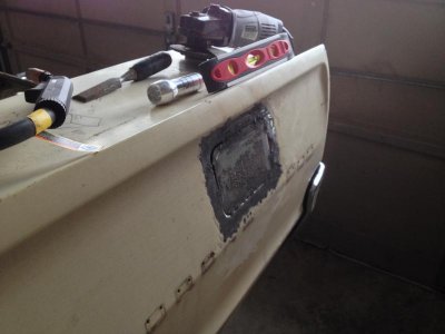

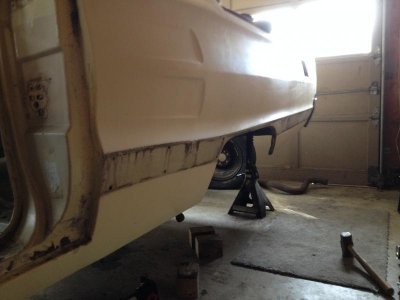

update

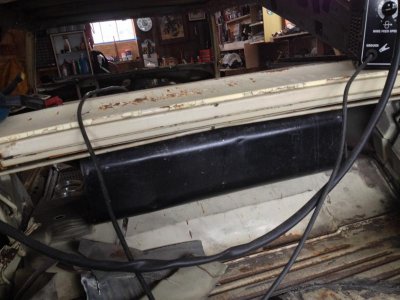

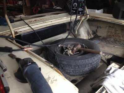

This weekend I was able to get out into the garage and I spent some time fitting a fuel cell up under the rear package tray and doing some spot welding on the trunk floor. I also decided to begin the project of shaving the gas tank filler door. I first had to remove the neck and the shroud around the neck before cutting a piece of the old trunk floor metal to fit the hole. I ground down to metal and tacked it in place. So far so good...
