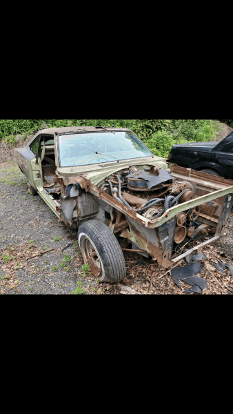

hello all. I’m restoring a 1968 charger I found in a junkyard with a tree growing throw it. I’m thinking of putting a gen 3 392 in it. I gave zero experience with modern engines and have no idea where to start. Any people out there that can tell me about what is needed and entailed for this project? Your responses are appreciated thank you guys first post here.

I don’t have the original picture with the tree through it but you can see on the roof, which was vinyl top, the hole towards the driver side roof that the tree grew through
