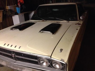

I've said it a hundred times on here and I'll say it again "I LOVE 67 B Bodies"! Those cars just have some of the best lines of any car out there, love it. So what's the plan? Keep us posted

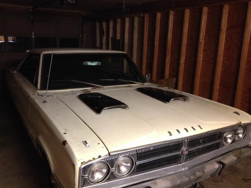

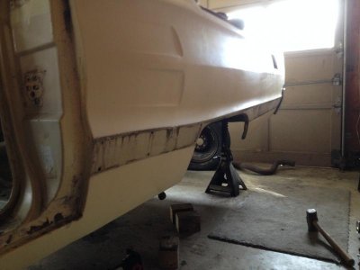

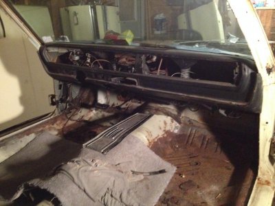

View attachment 226104 The plan is to gather the parts for mods that I want over the winter while i'm blasting and sanding so I can get it primed and painted in the early summer. I hope to be driving it by the fall. The rub is that i'm going through medical permanent disability retirement from the Army and the VA disability treadmill, plus social stupity, etc. so my finances are not optimal just now. Trying to trade for stuff. Hanging in there and working it a little at a time,.gotta pull the gas tank and some lines then I can blast away. I agree, the 67's are really sweet looking in the smooth lines and proportions. Proud to own it.

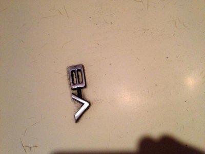

Looks like a nice straight body to start with! good luck with the disability I was accepted a few years ago and took 3 months, I was lucky it was so quick. While working I had the money to work on my Mopar's but no time. now have the time and a lot less $$. while gathering you parts if you run across the fender emblem for a '66 I am looking for the "Coronet" and "V8" call out.

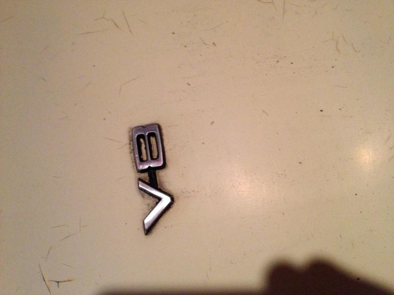

Okay, come over and finish it for me. LOL. No, really, I appreciate that, very much. I've always been one to do everything myself, I seldom ask for help. Now I have to ask often and it's a mental/emotional struggle each time. Oh well, it could be worse. I have not been in the garage for a week or so, i'm remodeling my wife's quilt room. Slowly of course, it takes three times as long to do anything than it used to. Once she is home I will get back out there. - - - Updated - - - strangely enough there seems to be only one V8 callout on my car, on the drivers side. Don't have one on the right. . Weird? is that normal?

thanks, I was looking for the badges for Rodney. I don't need any. He has a 66 and he needs them. I have only one.Thank you for your service brother. - - - Updated - - -

Thanks for the "V8" call out! I'll be looking for it I didn't realize you had posted the image here I just got the notification this AM. my 66 had the emblems on both fenders from the holes in the fenders. the Pentastar is only on the lower right fender. I have the "Coronet" on the way from Washington so got the other one covered.

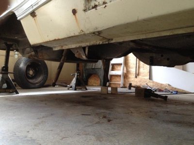

Great looking car, and looks like you have a nice one to work on with relatively minor issues (they ALL have issues...) Best of luck with your plans!

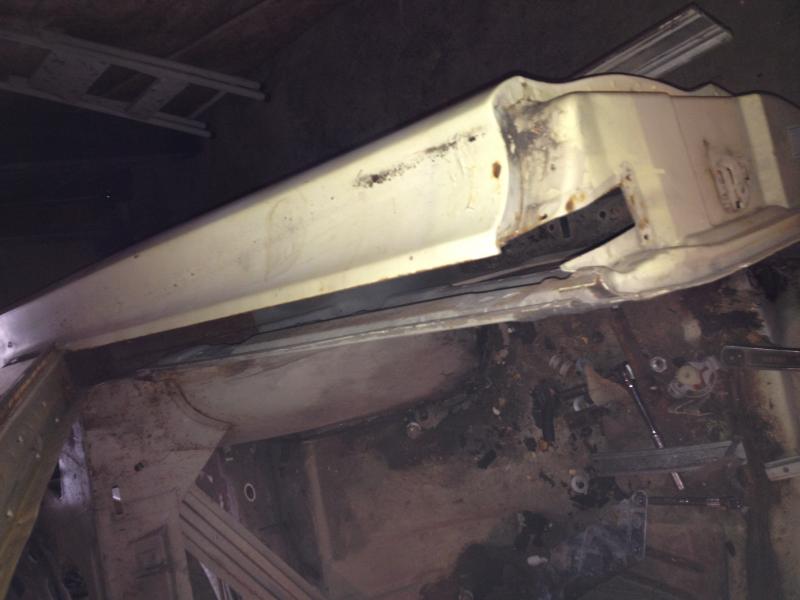

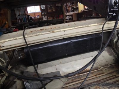

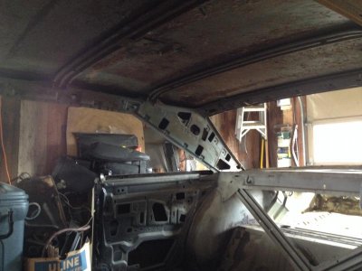

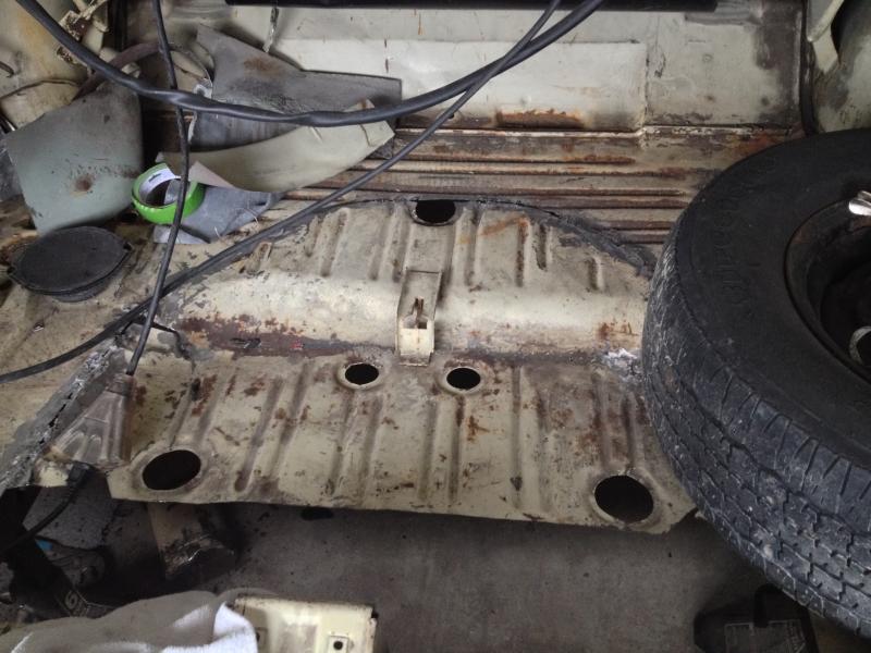

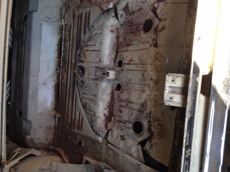

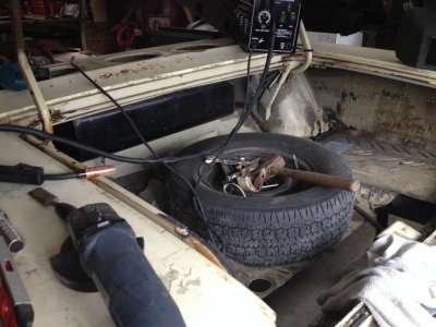

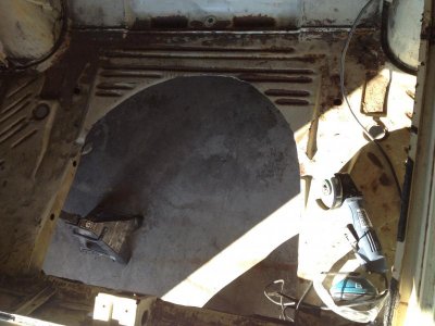

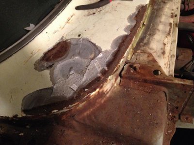

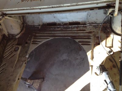

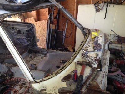

Thanks! Yes it does only have a few minor issues. There is very little serious rust, only the front half of the passenger floor pan. There is a dent filled with BONDO on the right top cowl corner but that's all. the rest is surface stuff. The usual areas seem to be ok. I hope to get out there and cut the floor pan loose this week. I have a sheet of 18 gauge in the garage and will fab up a piece to put back. Or, I intend to cut the spare tire well out and flatten the trunk floor, might reuse that piece for the more structural floor and fab a chunk to go in the trunk. Hmmm that rhymes. Got some done today: I had said that I wanted to flatten out the trunk floor and decided to reuse the tub bottom so I would still have a spare tire hold down bracket to use. Got some more pounding to do and trimming, then weld 'er up!

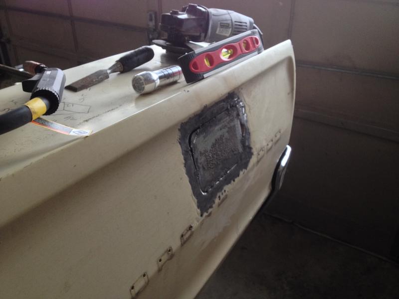

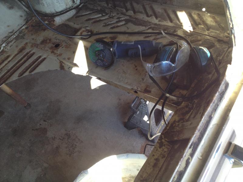

update This weekend I was able to get out into the garage and I spent some time fitting a fuel cell up under the rear package tray and doing some spot welding on the trunk floor. I also decided to begin the project of shaving the gas tank filler door. I first had to remove the neck and the shroud around the neck before cutting a piece of the old trunk floor metal to fit the hole. I ground down to metal and tacked it in place. So far so good...
