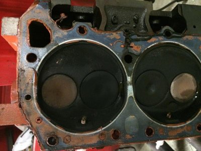

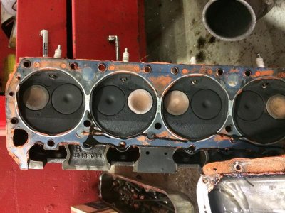

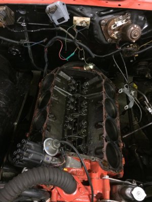

My mechanic, whom I trust, called me down to take a look at my 1968 383 Engine in my 1973 Roadrunner. It was not good news.
Pictures are fun, so I took a shitload.
IMG_2591.jpgIMG_2592.jpgIMG_2593.jpgIMG_2594.jpgIMG_2595.jpgIMG_2602.jpgIMG_2605.jpgIMG_2606.jpgIMG_2607.jpgIMG_2608.jpgIMG_2610.jpgIMG_2611.jpgIMG_2612.jpgIMG_2619.jpgIMG_2621.jpgIMG_2623.jpgIMG_2624.jpgIMG_2625.jpg

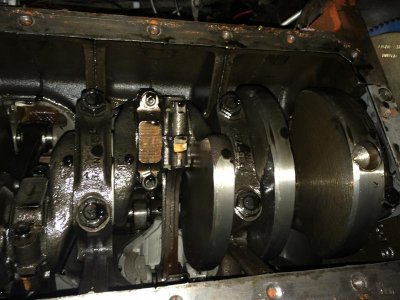

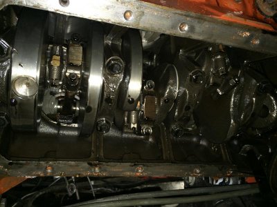

What was told to me is the following.

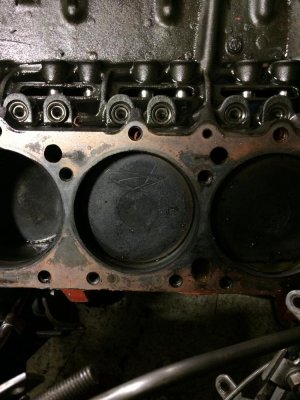

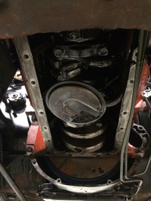

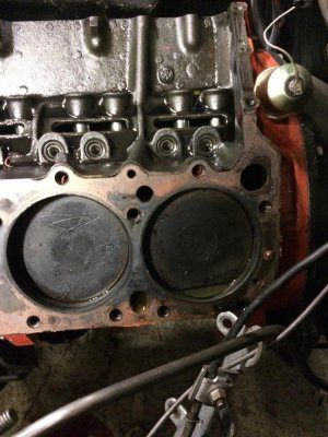

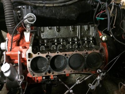

The engine looks to probably never had a rebuild. Or if it had it was not anytime recently. My mechanic said due to the Lack of Honing marks on the cylinder walls. He stated the honing marks take years to vanish, of which there are none visibile on any cylinder wall.

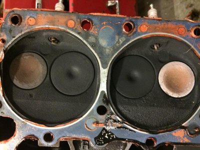

Also if you look at the black carbon and sludge, there are 'hot spots' and none are marked evenly.

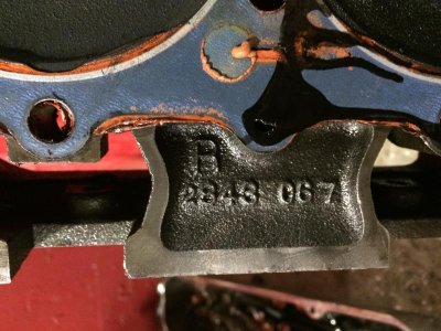

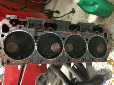

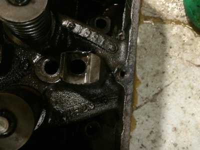

The Heads seem to be from a 1971-2 383, based on the casting numbers.

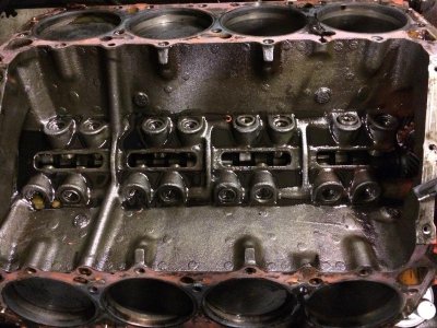

He also stated the Cam shaft looks to be in almost perfect shape. He did not recommend swapping that.
He did suggest I do some performance upgrades, as the 383 Engine is a good engine to squeeze some extra horse power from.
What I was hoping to gain from you guys is the following...
1. Does this engine look to need a proper rebuild? Why am I seeing this amount of carbon buildup?
2. What are some performance upgrades we can do, in terms of Pistons etc...???
3. Any Idea what a rebuild would cost me? He quoted me off the hip around $5000 for a rebuild and about 2500$ for a Rebuilt Crate 383. Does this sound right?
(this car is currently a 727 auto, after the engine is pulled we are going to strap on a 4 spd manual)
I appreciate the help as always. Thank you for your time.

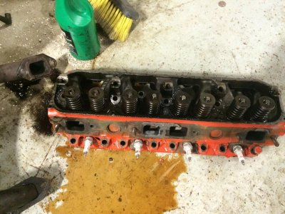

Yep it needs a complete rebuild. This is the first time in my life I ever actually saw anyone use silicone to seal a 8519PT1 head gasket. The cylinder heads are 906 and the correct ones for a 1968-70 big block.
I'm sure you will get many suggestions on ways and parts to rebuild this engine for more horsepower.
I removed a lot of snarky comments and bad words before I posted this.

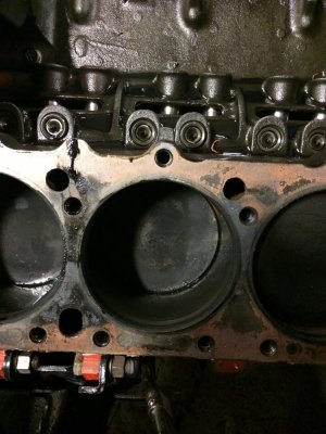

The mechanic decided to remove the cylinder heads due to stripped and incorrect tapped holes. 1 Header bolt only had two threads of grab. That and I believe he needed extra clearance to get my headers out of the engine bay to take out the steering box.
My mechanic also was very surprised at the heavy use of RTV. He explained to me, occasionally someone may use a small dab to help hold the gasket in place while mounting the heads. But never this much. He said it basically ran thru the entire engine, globs of it were present in all the areas you don't want it.
Believe me when I say I have been using a lot of bad words and snarky comments, in relation to the back yard mechanic who goofed all this up. Very nice guy, but he tried to spend ZERO dollars on this car. And as a result used whatever he had around to patch it together.
In the spirit of Spinal Tap. How Blacker could these cylinders get? None, The answer is none more black.
Seriously, any resources to help educate me on the rebuild options? send them my way!

Complete rebuild is in order. I would do it for about $3500 to $3800 here in AZ. Your location can obviously be different. Price will depend on your performance upgrades, and the guys here can make suggestions. As far as the cam, if you are going to rebuild it, I would not reuse a cam, and ESPECIALLY the one in this motor judging by the extremely scary head sealing job. make sure your machine shop gets all of the "Orange Death" out of the heads.
1) Complete cleaning of all components
2) Grind crank. Going to manual, make sure rear of crank is drilled for the pilot bushing
3) Align hone block
4) Square block (decking)
5) Measure cylinders, if stock, Bore & Hone 0.030" OS. If already 0.030", hone only to 0.040" (as long a taper and out of round is acceptable)
6) Resize rods, and use ARP rod bolts. 145-6002
7) Replace valve guides
8) Install hard exhaust seats
9) 3 angle Valve job
10) Mill heads
11) Replace cam bearings and freeze plugs
12) Replace intermediate shaft bushing. Dura-Bond AD584 (has groove)
13) Replace the 46 year old valves
14) Replace the valve springs to match the cam you use
15) Main bearings need to be the early style narrow thrust (Sealed Power 4094M or Clevite MS-876P)
16) NEW oil pickup is mandatory!
17) Replace pushrods PR-321
18) New OE rockers would be a plus
19) might need a harmonic balancer repair sleeve, or a rebuilt balancer (Damper Doctor)
Can't think of anything else, but I might edit list when I get to work tomorrow.

Factory head gaskets would have been steel and from looks of gaskets have heads checked to make sure they are flat. Engine block casting date can be found on starter side of block. Heads look like 906 but can not confirm from given casting number. Answer to question 1 lack of regular oil changes or cheap oil doesn't look that bad by pictures and have seen worse. Would use the pistons if not worn out as 383 piston are expensive also will depend on condition of cylinder's need to be checked for tapper and roundness. If you have to replace the pistons my preference is to only go large enough to correct cylinder's and size bores to pistons. $5000 doesn't sound out of line for a complete rebuild but would get it in writing ( machine work and parts list). Also have the block checked. No sense spending money on a block that should have been scraped. If you are serious about the 4-spd plan on having the crank drilled for the transmission input shaft. 5/8" deeper and sized for pilot bushing. Automatic cranks are not set up for manual transmissions. Also unless you already have to parts for the swap figure another $4000. Post the rebuild quote and we can advise farther.

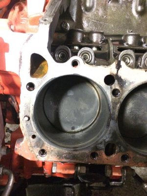

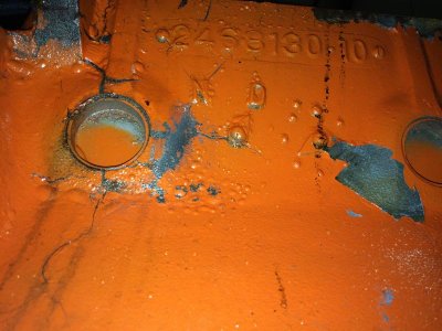

First thing I would do is check the cylinder walls for wear and taper. If one or more are beyond machining, you might as well stop there. If the cylinders check out ok, then completely strip the block of parts, then have it cooked, cleaned and magnafluxed. You have to make sure you have a block in good shape before you can go any further.
I'm hoping those cracks at the frost plug are just in the paint. That's the area where my 413 block failed. There were frost cracks from not having proper antifreeze in it at one point. A good cleaning by hand might show them if you look real good...

Just be sure, as already said, crack-check both block and heads! Should be first on your list.

Your motor was simply mis-treated. Pat it on the butt, make it right, and go for it. Not a fan of crate motors...never know what your gonna get. Either way, have fun with it. Yeah, that's 2 cents worth.
Just to add that I didn't mention... On any fresh rebuild one should alway start with mag and sonic check and then always check what you have for dimensions etc. so you know exactly what your starting with. For example, Did the block get decked, the heads etc. all will make things go back together correctly nearly impossible without that knowledge.

I'll chime in and spout that those *look* like some wicked cracks in the photo. I agree with check bore/taper and then see if it is cracked. First photo looks like crack in deck. Looks can be deceiving. Best wishes!
My mechanic said the same thing to me. When he saw the cracking around the freeze plug he thought we were doomed. He did some picking at that area with his finger and it LOOKED as though it was just the paint.
The paint used was not proper for the engine and was chipping all over the place.
My hope is that it is just the paint. But it has been pointed out before that around the Freeze plug is a common cracking area. Which is exactly where this is located.

The heads look like 346's to me which is Correct for 71/72
So, more bad news. This car is kicking my ***.
The engine has two different heads on it!
One has numbers that read 3462346 - 1971/1972 383 & 440
the second has 2843906 - 1968-1970 383 & 440.
I visually inspected them after noticing the numbers. I could not see a visible different to my untrained eye.
It seems obvious to me that I am going to need to get a set of Matching heads. And that having two different is not a smart move...
