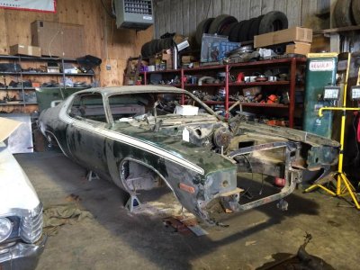

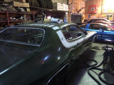

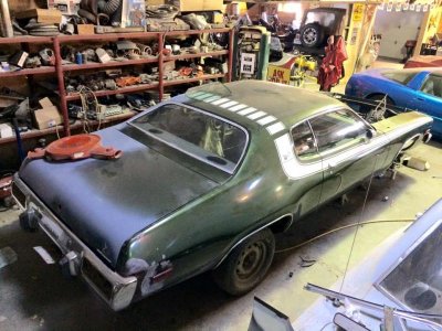

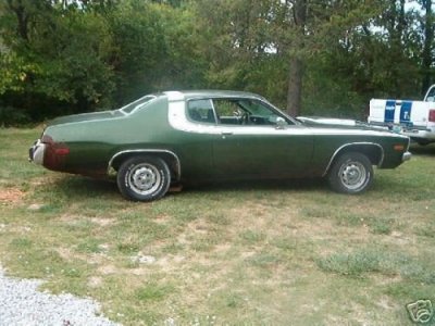

It's a long story so I'll give you guys the short version. I bought this car quite a few years ago off of eBay. This is what it looked like.

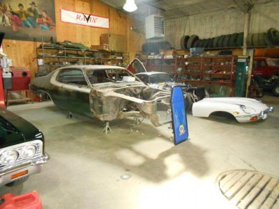

It was originally a 400/727 car. When I bought the car it had a 440/23 spline A833. It had not run in 20 or more years. It was also missing the gear carrier in the rear end and a few other things. I decided I was going to blow it apart and completely restore it. Then it sat like this for the next 7 years.

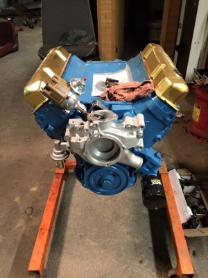

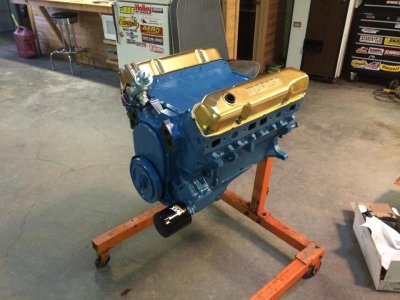

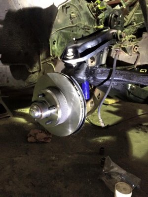

So after getting sick of looking at it this fall and not having ever driven the car, I decided that I wanted to throw it back together and enjoy it until I decide to have it restored. So far I have the whole front end back together with new bushings, and ball joints. I have new pieces for the rest of the front suspension waiting to go on, and new rear leaf springs are on the way from Springs N Things. I ended up finding a different 1973 440 that was in better shape and slapping it together with some new heads. So this is where I'm at now.
1497785_10153305117854688_4869351295974868906_n.jpg10403080_10153302699589688_529760342270421057_n.jpg
10703588_10153204306949688_7330795950118625129_n.jpg1964884_10153206997064688_2526696136269320396_n.jpg

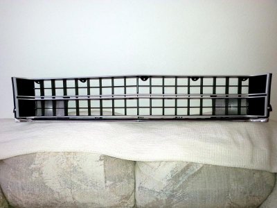

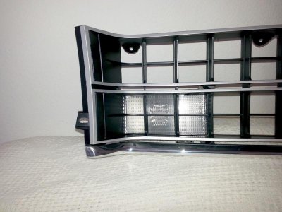

Welcome to the fun. Looks like a fun car! Glad to see another 73RR. I bought one just that same color back in the 80's but didn't have room for it, so I sold it. Just an FYI, your front grille should be black with silver on the four raised areas going across, but that's an easy fixup.
Thanks! I figured that's what the grille is supposed to be. Searching google image brings up Road Runners with all sorts of different color grilles that I wasn't sure. I need to fix this one or find a different grille. Quite a few cracks in it.
Its hard to find one that isn't already cracked or missing pieces. Best thing to do, and what I had to do with mine, well actually two that I have, is get some plastic weld and repair the cracks and sand and hit with adhesion promoter then paint it with low gloss. You can do the silver with a paint pen or, paint the silver first and tape it off then spray with black.

Thank you very much! The transmission I have has the mount up front. My car has buckets and the transmission tunnel moves the shifter hole way back, and everything I found online said the rear mount was e body only. So thank you! Now I just need to find a dual mount tail housing
I'll do that. So the 4 horizontal lines across the grille are silver?
Here is a reference picture for your grille
Here is a close up of the side area.
Yes, I did restore this one, basically as I described above. Best thing to do, and what I had to do with mine, well actually two that I have, is get some plastic weld and repair the cracks and sand and hit with adhesion promoter then paint it with low gloss. You can do the silver with a paint pen or, paint the silver first and tape it off then spray with black. One thing to remember is once its repaired and ready to reinstall, don't over torque the screws holding it in place, this tends to lead to the cracks in them, just make sure they are snug so it doesn't move around.

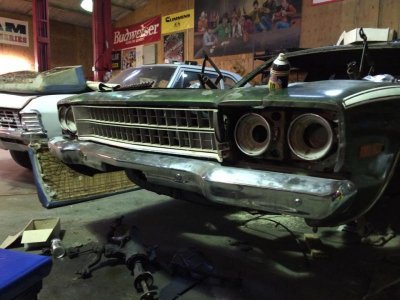

Just waiting for more parts to show up, but here's some more pictures for you guys that like those.

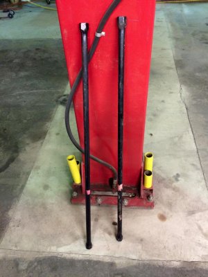

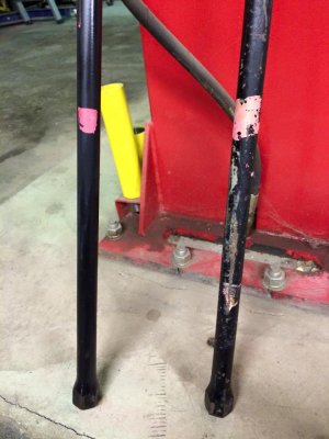

Cleaned up the torsion bars in the parts washer
Can still see the paint marks on the torsion bars

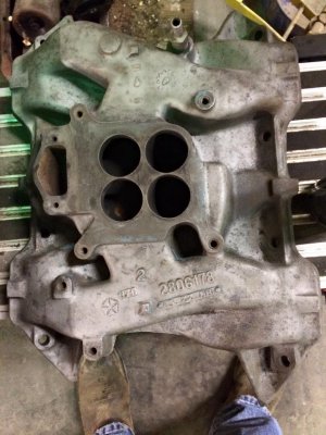

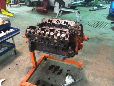

1968 Plymouth Intake that came off of the old 440 that was in the car (Could see the original turquoise when I blasted them.)

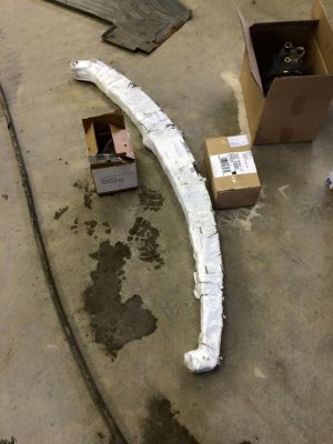

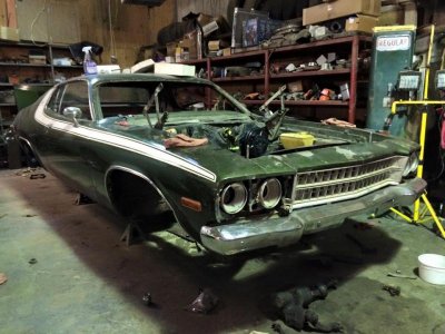

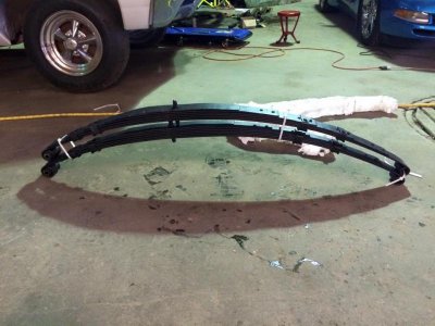

Well for the first time in 6 years she is back on at least 2 tires. Rear end is mounted temporarily since it needs new everything including a center section. My goal right now is to get the car on 4 wheels so I can move it out of the corner of the shop a little easier. I put the new rear leaf springs in last night with new bushings, bolts, and shackles. Just waiting on torsion bar locks and seals, and the torsion bar mount bushings, then I can get the front down on wheels.

Where'd you get your springs?
http://www.springsnthings.com/
They need to know year of car, motor size I believe, and if you are going with the original set up with the isolators. I'm keeping the original set up with the rubber isolators. The springs were $250 for the pair with new front bushings pressed in. They also sell the rear shackles, new bolts, and u bolts.
