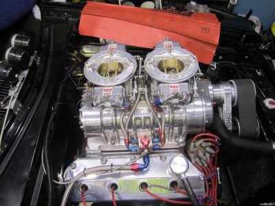

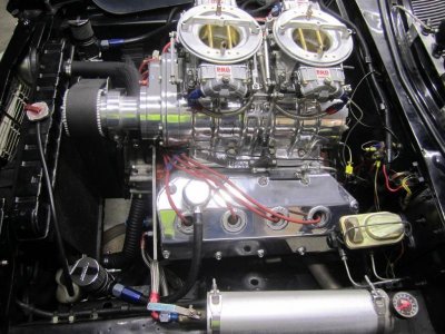

I have 2 SV1s and I'm very happy with them.They had not done many blower carbs so I had to fine tune it with great results.IMOP,the few that have switched them out were not too good at carb tuning.The SV1 is a little different then a conventional Dominator.
