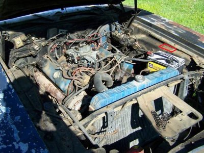

I don't know where the fender tag would normally be, but in those pics I can't see if there is one, would it be behind the battery in the one picture?

Also has 73/4 rear tail lights. Tag should be on the inner fender well right above the battery. Can't really tell if it is there or not.

Ok, so the fender tag should be in the red box area I marked?

Yes the tag should be where you highlighted in red.
